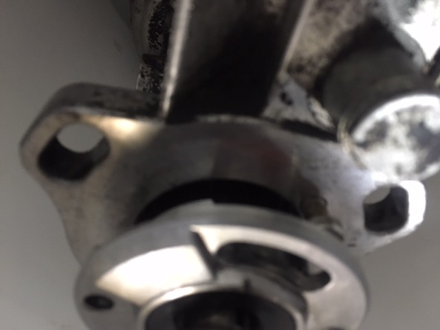

Hi guys,
I recently bought an M pump with 7.5mm elements from Dieselmeken and attempted to install it in my 1976 W123. The engine was naturally aspirated but now has a turbo. I have been running the old NA MW pump for years, but it needs more fuel...enter the M super pump.
I had a lot of trouble fitting it despite the good instructions above. 2 things have stopped me:
1) The diameter of the large locating flange / front cover of the new pump is 0.01 mm bigger and doesn't quite fit. I'm sure I can get a round this by putting the pump in the freezer or something.
2) The input shaft is about 10mm longer on the M than the MW and that appears to be 5mm too long. I need to triple check this again, but I feel like it will need a spacer.
But that isn't my biggest problem: I made a terrible, hasty decision and tried to swap the locating ring / front cover on the MW with the M both to make it fit more easily but also the oil access hole on the MW looked bigger and I had some concerns about adequate oiling on the M pump, which does not have a pressurised oil feed like the MW. After opening it up I realised this was never going to work as the inner shaft diameters are different as are the bearings. FAIL.
Of course, when I opened it up, the cam moved sideways and now won't re-locate easily so I can re-install the cover. I don't want to force anything and do any more damage than I already have. Double FAIL.
Has anyone ever had the cover off one of these pumps before and am I going to be able to get it back on without major surgery?
Any thoughts and prayers appreciated.
RE: Dieselmeken om617a Super M pump setup - barrote - 10-18-2018
Yep force it in
RE: Dieselmeken om617a Super M pump setup - 3DB - 11-03-2018
Thanks, barrote. I forced it and it went back in no worries. Pump is also in the car now and seems to be going well so far. The auto transmission isn't loving it though. Flares badly when the boost is on, so need to sort that out.
