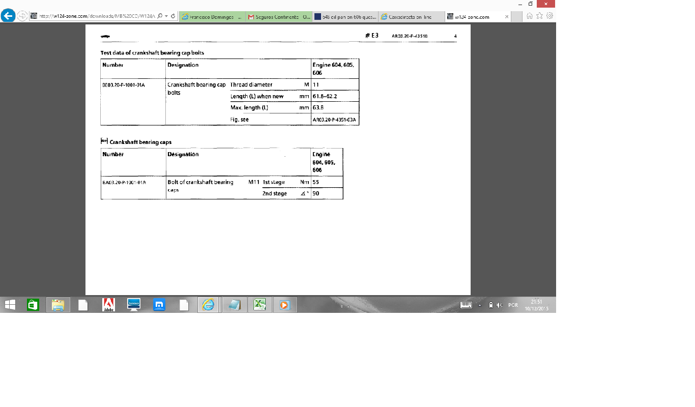

Anyone know the torque specs for main bearing bolts?
RE: 648 oil pan on 606 questions - Hario' - 12-10-2015
(12-08-2015, 02:42 PM)hooblah Anyone know the torque specs for main bearing bolts?
I have a W202 C250TD Haynes manual I can consult for you on that.
RE: 648 oil pan on 606 questions - gary andrews - 12-10-2015
think there 60nm and 90 degs
RE: 648 oil pan on 606 questions - barrote - 12-10-2015
(12-10-2015, 01:56 PM)gary andrews think there 60nm and 90 degs
