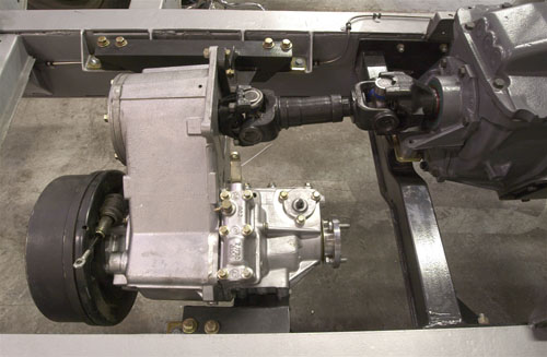

Divorced LT230 with some kind of US gearbox here...

Let's have another go. Divorced LT230 on what I believe is some kind of yank box?
[Image: attachment.php?attachmentid=3715&stc=1&d=1088487619]
