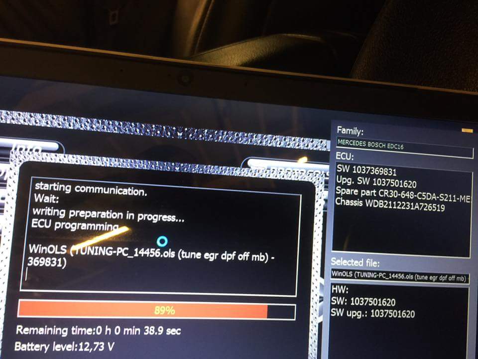

RE: OM648 tuning ? - Kennobi75 - 04-30-2017
265hp 600nm so far..
Some upgrades and remaping ?
RE: OM648 tuning ? - seconika - 05-17-2017
Is that on the wheels? Dynoed?
When I got my car it was tuned by Carlsson in Germany.
They had the same number on stock car.
Upgraded the exhaust, intercooler, aitfilter, and did the EGR delete,
After that I got it tuned at a local shop here in Norway and we got very near 280hp and just over 700m,.
But the problem wasn't getting power out from the engine (or torque) it was getting the gearbox to use it.
I have new plans for Injectors, H-pump, Turbo, exhaust manifold during next winter.
But for now, the priority is getting a new controller for the gearbox installed.
See thread: http://www.superturbodiesel.com/std/showthread.php?tid=3105
I can't see any need for more power when the gearbox don't shift when needed, I have my power band between 1400-2800rpm but the gearbox is going way past this (4500rpm) before shifting.
Waste of time during acceleration.
I believe the car will feel to perform like it got dubble the HP just by tuning the gearbox.
But.. The standard ECU tuning without any upgrades did NOT get me to 300HP at the wheels.
I will follow this thread with interest Smile
N.

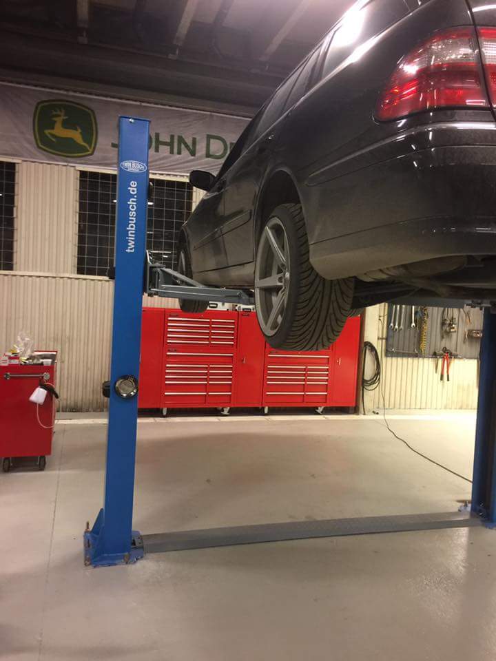

RE: OM648 tuning ? - Kennobi75 - 06-28-2017
(05-17-2017, 11:19 PM)seconika No dyno. Yes i think it was on the wheels..
Upgrade turbo airfilter and end mufflers next and then new mapping ?
