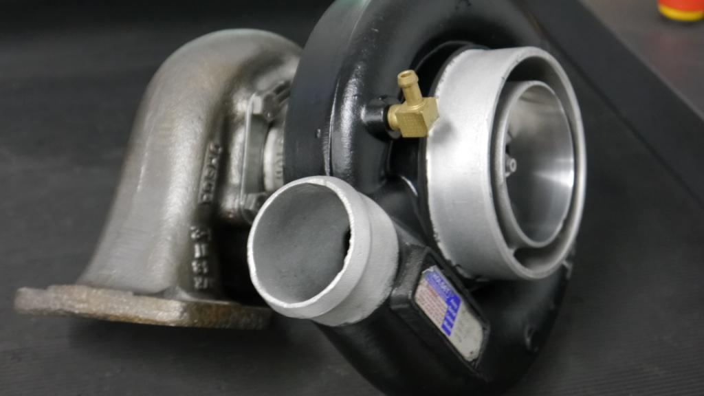

RE: L200 om605 - Mallinman - 05-13-2018
Going to finish off the turbo manifold over the next couple of weeks and want to get peoples thoughts on wastegates. Do I want an internal or external. What are the pros and cons of each. I going to run a hybrid turbo. It’s a hx35 compressor wheel and housing mated with a Garret .48AR turbine housing. I’m trying not to get too much lag. Just after any opinions or feedback of what other people have. Good or bad. Whilst I’m welding it all up it would be easier to know to go external or not.
