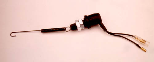

I do not know the situation, but what you can look for is how brake lights are done on bikes with the rear brake!
It is a kind of pull-switch, and the switch is connected to the foot-lever with a spring. So, when you step on the brake for 5mm, the switch already activates ... but when you press down for 3cm , the spring prevents the switch from breaking.
[Image: WW11045B%5B1%5D.jpg]
[Image: 12-0001-500.jpg]
