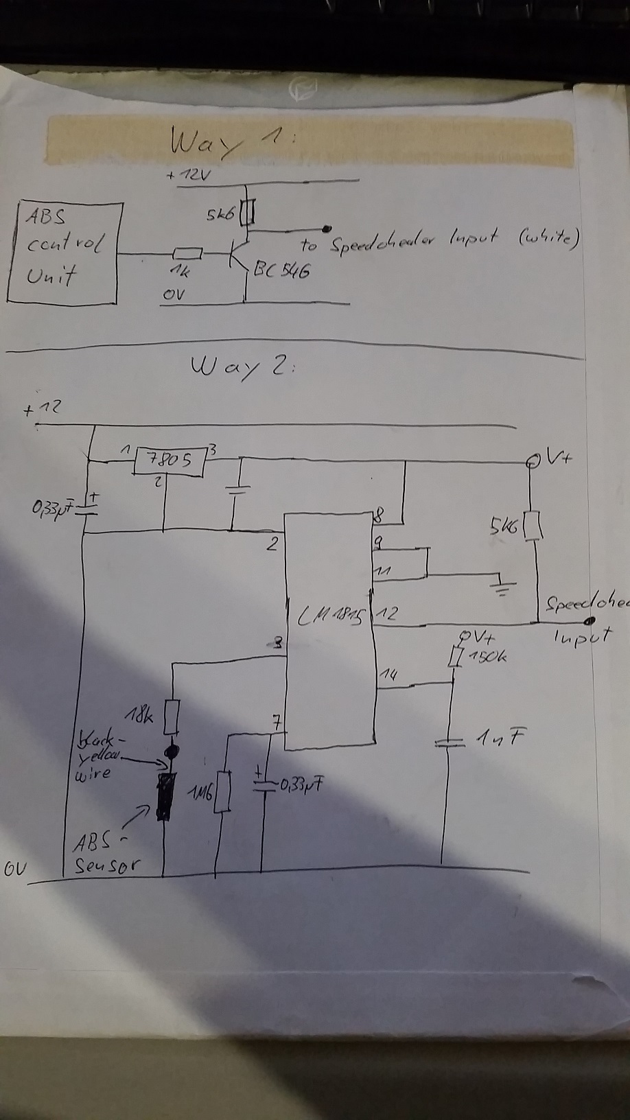

ways to put w124 speedometer work whith 6 speed gearbox - PedroFerreira - 11-09-2016 hello,can some one tell me what´s the way to put speedometer working whith 6speed from w203? RE: ways to put w124 speedometer work whith 6 speed gearbox - firen456 - 11-10-2016 Hello, use the speed sensor from the diff with a speedohealer V4. I got issues with the signal of the sensor and solved it by converting the sensor signal to a square signal with a lm1815. It works great now. With the speedohealer you can adjust vour tach signal from -99.9% to 9999,9%. RE: ways to put w124 speedometer work whith 6 speed gearbox - hansdampf - 01-10-2017 Hi firen, could you give more information of how to connect the lm 1815. I have a speedo healer v4 in connection with a german device the converts a wave signal into a square signal. Deppending strongly on the the temperature (the colder, the better it works …) the speedo (w126) falls back to zero at max 170 km/h … I think the signal converter I have does not wotk right. Should be 4 wires. +, ground signal-in and signal out … right? Please help me out, how do I connect the lm1815? cheers from munich hansdampf RE: ways to put w124 speedometer work whith 6 speed gearbox - Tobulus - 01-11-2017 I know that problem. The speedometer is built to work with an inductive sensor, square signal input doesnt work above a certain frequency. RE: ways to put w124 speedometer work whith 6 speed gearbox - firen456 - 01-13-2017 Hi,
in the LM1815's datasheet there is a circuit explained which works well.

RE: ways to put w124 speedometer work whith 6 speed gearbox - Gelubelea - 01-15-2017 Better conditioning the signal with NCV1124 or MAX9924 Gelu RE: ways to put w124 speedometer work whith 6 speed gearbox - hansdampf - 02-03-2017 (01-15-2017, 08:24 PM)Gelubelea Better conditioning the signal with NCV1124 or MAX9924 Maybe you are so right as many ways lead to rome … Hi firen, thx a lot for helping me out so much. That was bad ass …. I was so enthusiastic about your work, that I forgot about … ![]() Sevus fo Minga und bis zum nexscht´n moi, Du gacher und wuida Hackler!!! dei Andi RE: ways to put w124 speedometer work whith 6 speed gearbox - PedroFerreira - 02-03-2017 hello someone can help me instaling the speedohealer? RE: ways to put w124 speedometer work whith 6 speed gearbox - firen456 - 02-04-2017 Measse ![]() In the attached pictures you can see where to take and how to modify the signals. Dont't ask me where you can find which wire exactly. I Don't know. The ABS-Sensor is plugged under the rear seats and the ABS control unit can be found behind the Battery in W124. RE: ways to put w124 speedometer work whith 6 speed gearbox - PedroFerreira - 02-04-2017 firen i send you pm RE: ways to put w124 speedometer work whith 6 speed gearbox - PedroFerreira - 02-04-2017 can i conect the speedohealer directly to abs sensor?or i whill nedd the amplifier? RE: ways to put w124 speedometer work whith 6 speed gearbox - JoeB - 02-12-2017 There are several threads on this. please use the search function. If you want to use a hall-effect sensor then use the v4. For information use: https://www.healtech-electronics.com/products/sh/ If you MUST use an inductive sensor (diff/abs) then you need the special SH-V4-2W version. SpeedoHealer special models RE: ways to put w124 speedometer work whith 6 speed gearbox - PedroFerreira - 02-12-2017 Joeb if i use SH-V4-2W dont have to use lm1815? is just plug and play? RE: ways to put w124 speedometer work whith 6 speed gearbox - JoeB - 02-12-2017 Correct. |
