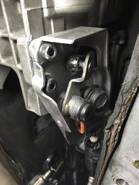

716.630 gear linkage mods - jhw. - 02-09-2017 I have a 716.630 mated to an om605 that I've fitted to the car. The big selector rod needs to be shortened by 10cm which is no problem. I'm a bit stuck with the cable at the side, it only ever seems to move when Reverse on the gear selector is selected. I have bought 4 linkages and the bit between the cable and box is missing on all of them ![]() Any help, is the cable required? RE: 716.630 gear linkage mods - JoeB - 02-12-2017 Yes, the cable is required. On the end of the cable is an adjuster, although I doubt that with 100mm shortening you will be able to achieve this without shortening the cable itself. the bracket on the side which receives the cable, runs through 2 pivot linkages and rotates through 90 degrees, to which a connecting rod joins the selector rod to the cable. The purpose is to allow engagement of reverse and correct spacing of the H pattern, with the appropriate centre position. IF the cable is not correctly set, the shift lever will make it all but impossible to select all gears. usually 5 & 6 go missing, because the cable prevents the full rotation of the selector arm. RE: 716.630 gear linkage mods - juggs - 02-14-2017 Has anyone got around this or found a suitable shorter cable? In the middle of trying to do this 6 speed swap into a w202 myself but came up against a brick wall with shortening the cable. RE: 716.630 gear linkage mods - juggs - 02-14-2017 Has anyone got around this or found a suitable shorter cable? In the middle of trying to do this 6 speed swap into a w202 myself but came up against a brick wall with shortening the cable. RE: 716.630 gear linkage mods - seanyt - 02-15-2017 i cut the metal elbow off the cable to help with it. I also got a small cable made up but the original with metal elbow cut off did a better job. or look into the w204 shifter setup. I may change to this when the gearbox is out. Its a single bar that rotates for left and right instead of the cable section. RE: 716.630 gear linkage mods - Max - 02-15-2017 Hi, if you fit a 716 Gearbox in an w201, you just take the Cable from an w208 CLK 230 with 6-Speed Gearbox. Cost is about 30 € new at your local MB-Dealer. Its a straigt bolt-on. Greets Max RE: 716.630 gear linkage mods - bruno_pinho - 02-16-2017 (02-15-2017, 10:54 AM)seanyt i cut the metal elbow off the cable to help with it. I also thought about it and I wanted to do it...but How can you solve the fitting problem in the gearbox,the fit is different for the 2 shifter in gearbox..? RE: 716.630 gear linkage mods - juggs - 02-19-2017 Max do you know if the clk 230 set up works for a w202 as well? RE: 716.630 gear linkage mods - Max - 02-19-2017 No, i only have expierence with w201. |
