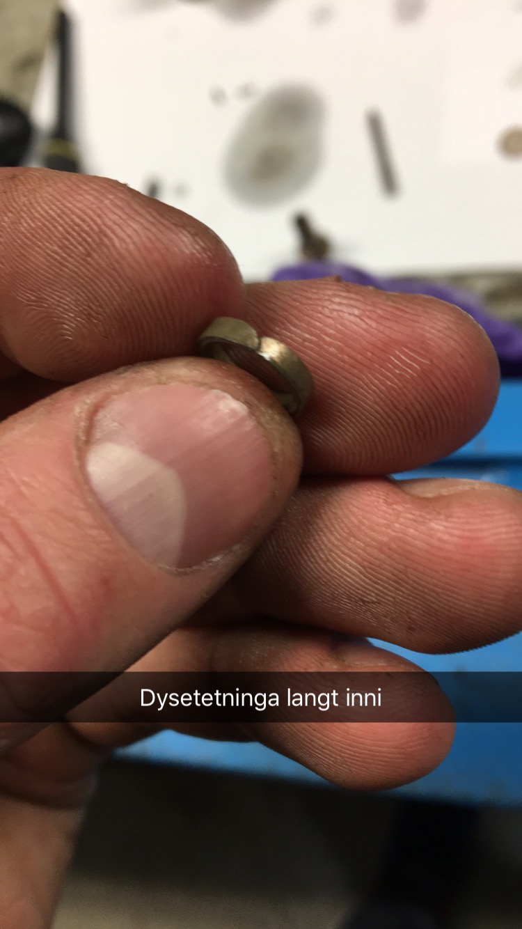

Bought refurbished injectors, didnt work so i did them myself afterwards(missing parts inside, fine now)

Picture from inside injector i bought refurbished...
