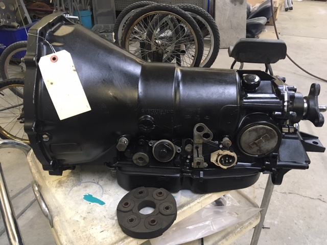

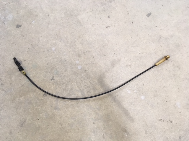

OM617 Auto trans parts id and help needed - Metzone - 03-25-2018 As some of you know I have been building a 63 Comet with a 1984 OM617 and the 4 speed automatic that came factory. My questions: 1. Is a more traditional style trans yoke (one that would have the u-joint attached to the splined portion) like a factory USA made car of the same vintage? 2. The cable (see pic) for the kick down and/or shift needs to be replaced, where can I find it? 3. What are the functions of the cable? 4. What is the function of the electrical hookup on the side of the trans? Thanks for the help, I appreciate it. RE: OM617 Auto trans parts id and help needed - fordheaded - 03-25-2018 Jagsthatrun.com offers a mercedes driveshaft adapter plate for $95.00. Make sure to ask what u-joint flange to order to bolt to it. RE: OM617 Auto trans parts id and help needed - NZScott - 03-25-2018 This thread has part # for yokes which fit the splines directly etc http://www.superturbodiesel.com/std/showthread.php?tid=783 |
