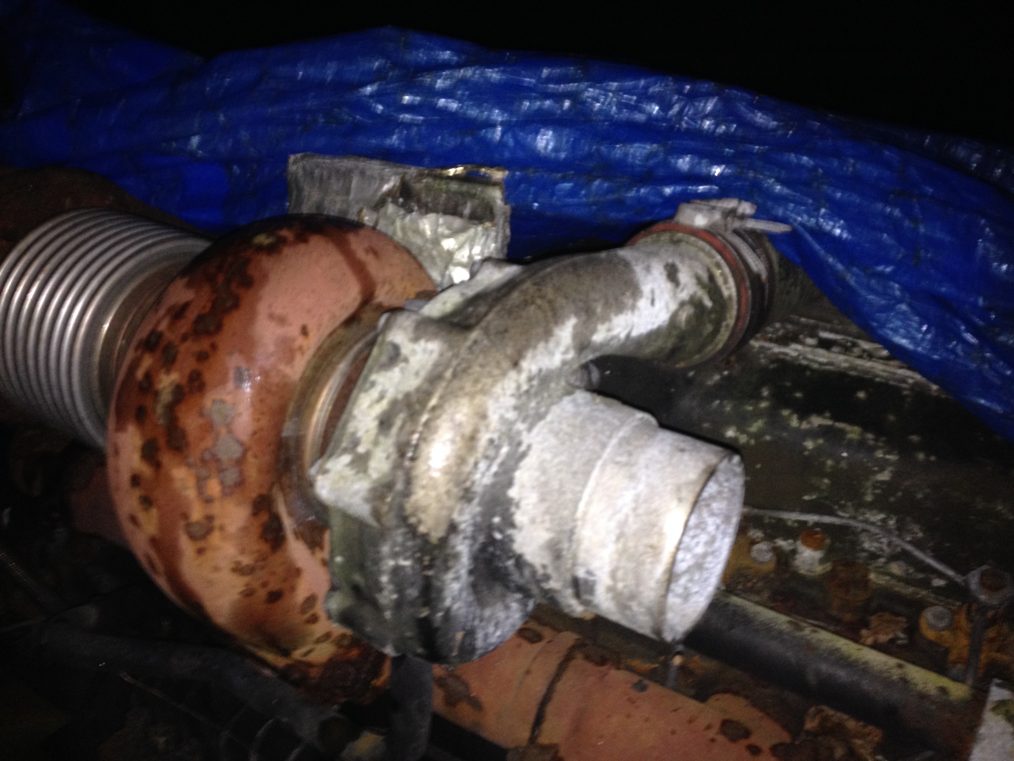

Unidentified Garrett turbo - engineengineer - 03-29-2018 Any ideas on what this is? Only marking is M24 on compressor housing. Appears to have a T6 flange, fitted to a 12litre Rolls Royce C series. HX50 is from roughly 11 litre, and I think T6 flange? So maybe would spool eventually?! RE: Unidentified Garrett turbo - atypicalguy - 04-04-2018 Need to know the housing size to answer the spool question. And measure the wheels. If the number of blades does not permit a diameter measurement then you can measure a triangle from any three tips and compute the diameter of the circle which includes the three points. |
