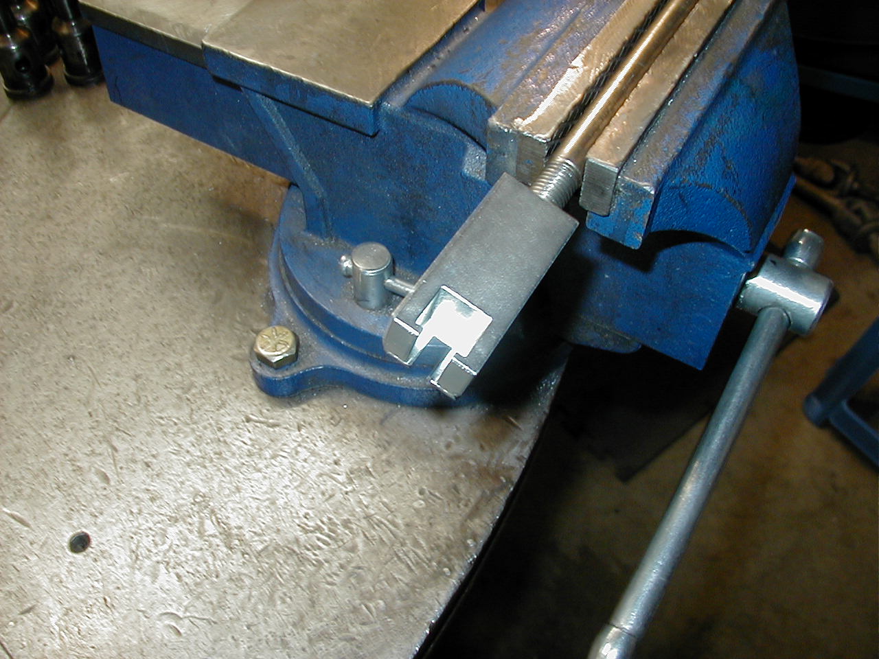

OM 606 Piston Oil Cooling Nozzle - zeeman - 12-07-2018 Need to bore a 606 block and need to remove the piston oil cooling nozzle. Anyone know how to remove these and reinstall. They look like they are pressed in unlike the OM 617 ones that are bolted in. Anyone? RE: OM 606 Piston Oil Cooling Nozzle - jav1 - 12-07-2018 in the workshop manual for the 606.964 it shows them using 3 special tools. For removal they use impact extractor (602 589 00 33 00) -which is a slide hammer & removal claw (604-589 00 34 00). To insert they use insertion drift (604 589 00 15 00). They appear to be press fit. RE: OM 606 Piston Oil Cooling Nozzle - barrote - 12-07-2018 Exactly RE: OM 606 Piston Oil Cooling Nozzle - German Diesel - 12-09-2018 Hi, i have a few great pictures, but i dont can load it up here. Can i send you the Pictures with an E-Mail, and you load it up? Steffen RE: OM 606 Piston Oil Cooling Nozzle - zeeman - 12-09-2018 (12-09-2018, 03:21 AM)German Diesel Hi, i have a few great pictures, but i dont can load it up here. Yes please send to northwestdieseloffroad@gmail.com Thanks Zeeman RE: OM 606 Piston Oil Cooling Nozzle - German Diesel - 12-12-2018 You have the mails RE: OM 606 Piston Oil Cooling Nozzle - zeeman - 12-13-2018 (12-12-2018, 01:30 PM)German Diesel You have the mails I did receive them. Thanks so much. You have been a great help. I wish someone made that tool. I will have to fabricate one. Zeeman RE: OM 606 Piston Oil Cooling Nozzle - German Diesel - 12-14-2018 Hi, Thanks ![]() Please load the pictures up ![]() Steffen RE: OM 606 Piston Oil Cooling Nozzle - German Diesel - 12-22-2018 Hello, Please upload the pictures Steffen RE: OM 606 Piston Oil Cooling Nozzle - German Diesel - 12-28-2018 Hi, so That anyone get the pictures, i have find a good way to load the pictures up (: ![]() ![]() ![]() ![]() ![]() ![]() ![]() ![]() ![]() Steffen RE: OM 606 Piston Oil Cooling Nozzle - zeeman - 01-12-2019 The pictures were very helpful. I was able to get the Mercedes factory tool, thanks to JAV 1 for the part numbers. |
