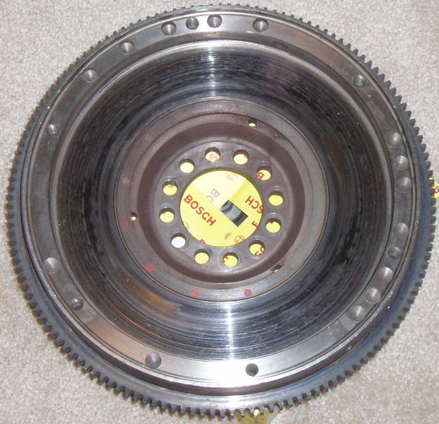

A lightbulb went off over on one of the G-wagen sites and I thought I'd run the idea by you guys in case it's been done or there's known reasons not to do it.
the idea:
get an M110 flywheel and clutch (bigger, heavier duty clutch but less weight)
machine a steel ring to fit on top of the outer lip of the M110 pressure plate to give it more rotational mass.
pros:
quite a few G-wagen guys are swapping out their M110's for 617s. most came stock with 4-speed manual trannies but they are switching over to the sedan automatic because of the high cost and scarcity of G- clutch parts. so finding a way to reuse the M110 clutch seems pretty cool to me.
cons:
It seems pretty straight forward but machining the ring may not be that easy. it would need a pretty big lathe. Would have to figure out where to source the chunk of iron too. maybe a cut from a pipe of the right diameter that is then milled to spec.

Why not use a 240D flywheel and M110 clutch? It will take a LOT of weight to get it even close to a 240D's mass.
M110:OM616:OM617
The 617 FW weighs 38lbs and the 616 about 10lbs less.
Also, as seen in the second picture, if you make a ring it will have to clear the starter nose.

(11-08-2009, 07:39 PM)ForcedInduction Why not use a 240D flywheel and M110 clutch? It will take a LOT of weight to get it even close to a 240D's mass.
I'm told the 240D clutch isn't strong enough for the weight of the G-wagen. the 300GD clutch is a bit bigger and the M110 clutch is bigger yet.
(11-08-2009, 07:39 PM)ForcedInduction Also, as seen in the second picture, if you make a ring it will have to clear the starter nose.
that shouldn't be hard - I'm thinking the ring would sit direclty on top of the pressure plate and use the same bolt holes to hold it on like a sandwich
