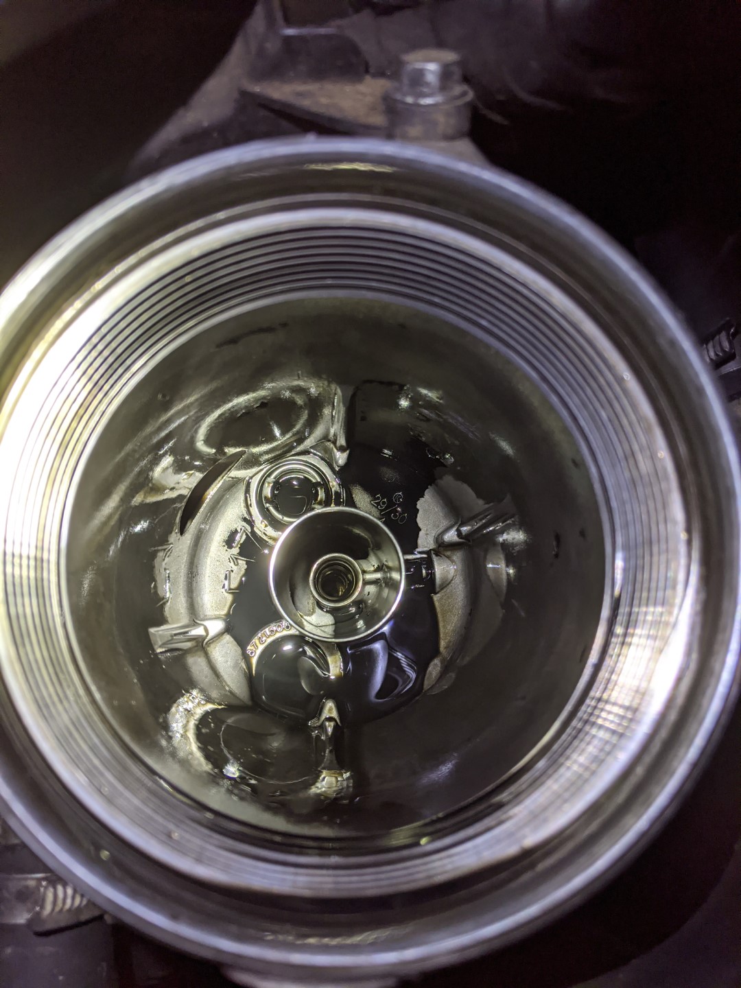

I recently worked over much of my engine.  It runs great, but has developed an oil pressure problem.
Notable symptoms:
 - Oil drains back to the sump after a few hours (filter compartment is empty).  The picture is exactly how it looks when the filter is pulled.
 - Oil pressure warning if started after a few hours.
 - Once warm, a faint rattle until RPMs are up slightly.

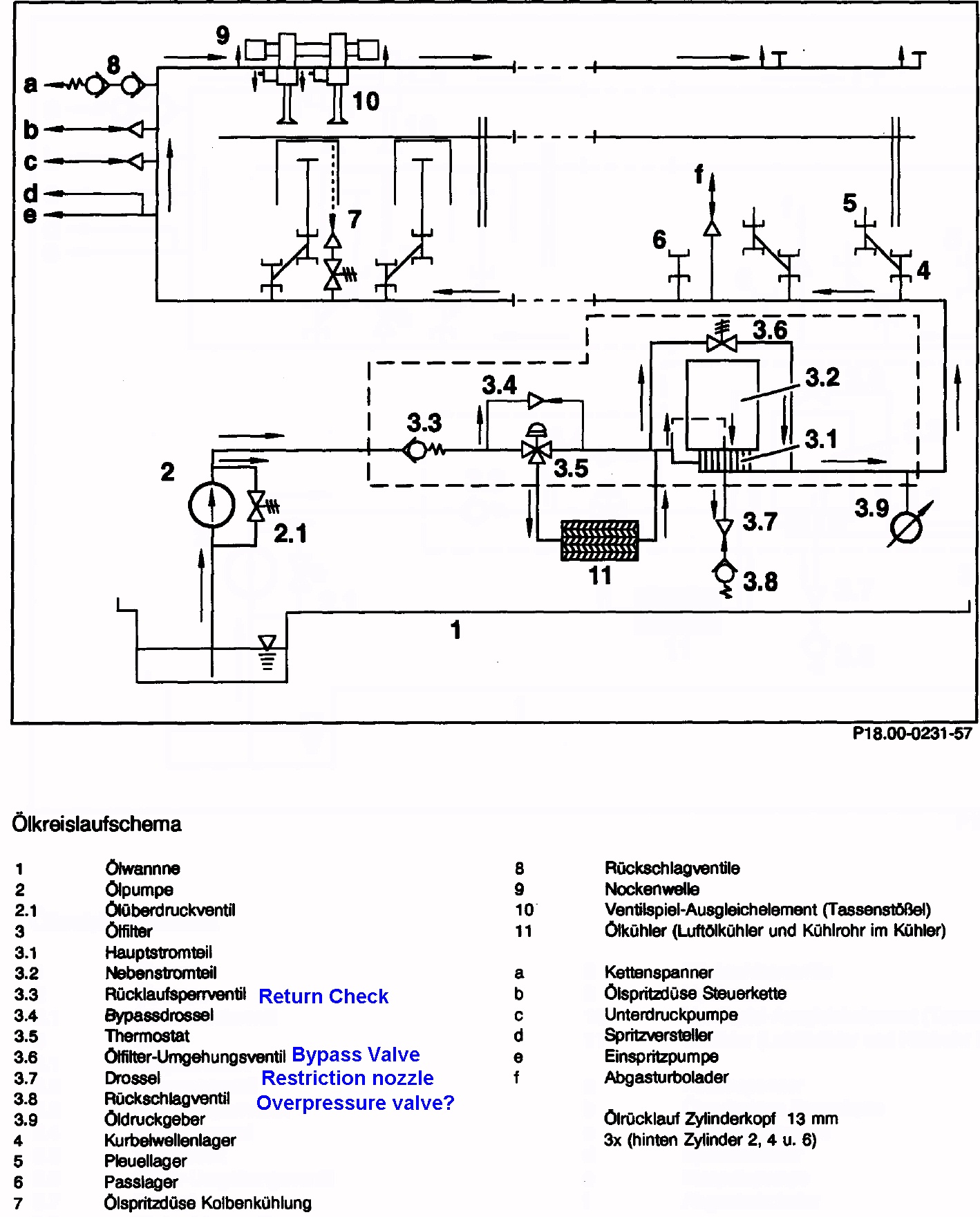

I believe this problem is in the oil filter block.  Specifically the over pressure return valve, item 3.3 on the diagram.  I inspected the filter material and found some aluminum spirals.  These probably came from a refurbished oil->air cooler (the new part is NLA).  If a similar spiral got into item 3.3 it would explain all.   If the problem were at 3.8 then the bottom of the filter compartment should still be partially full of oil, which it isn't.  I suppose it could siphon up and over through the filter material.
Anyone know that oil filter block well, or have experience with this?

A kind friend turned up with a 606A filter block. So, I've been looking at how it works. Pretty clever casting and machining.
3.3, the anti-drainback valve is easy to get to, but it is staked in. That would easily explain the drainback problem. I'm presuming that it is fouled, I'll have to see if I can clean it up in place. But doesn't explain low oil pressure at idle. Either way, It looks like I'll have to pull the filter block.
3.8, which appears to be an overpressure valve (venting back to the pan) does not appear to be part of the filter block. Instead it must be in the
block (as the diagram shows). Anyone have a clue where I would find it? Really don't want to pull the oil pan, but there may be no choice.

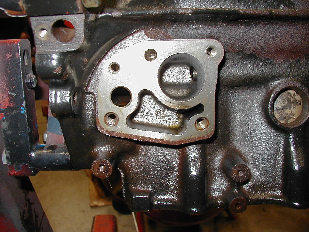

Here is a picture of the block behind the oil filter housing, there is no valve in the block. Did you have the front timing cover off, there is a o-ring between the cover and the block that feeds the timing chain I believe.

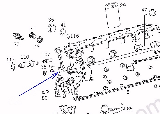

RE: Seeking knowledge of OM606A oil filter block - AlanMcR - 11-24-2020
I had the timing cover off. I did see the thick/small O-ring that sealed the vacuum pump oil nozzle against the cover.  #113 in the drawing, though the O-ring looks quite different than the drawing.   It is easy to lose, but I think I got it into place correctly.  There is one other tricky spot that has me worried.  On the passenger side sealing face of the block, there is a circular indent where an oil galley ends and meets a drilled galley to (if I recall correctly) the vacuum pump oil nozzle and the chain oiler.  This opening is sealed by the front cover.  The mating area is quite thin and maybe the anaerobic sealant blew out of that area.
Important point: the leak was not there for the first 2-300 miles.  It showed up after some vigorous driving (long mountain passes, etc).  The engine never got hot <90C, no matter how hard I pressed it.  Plenty of power.
