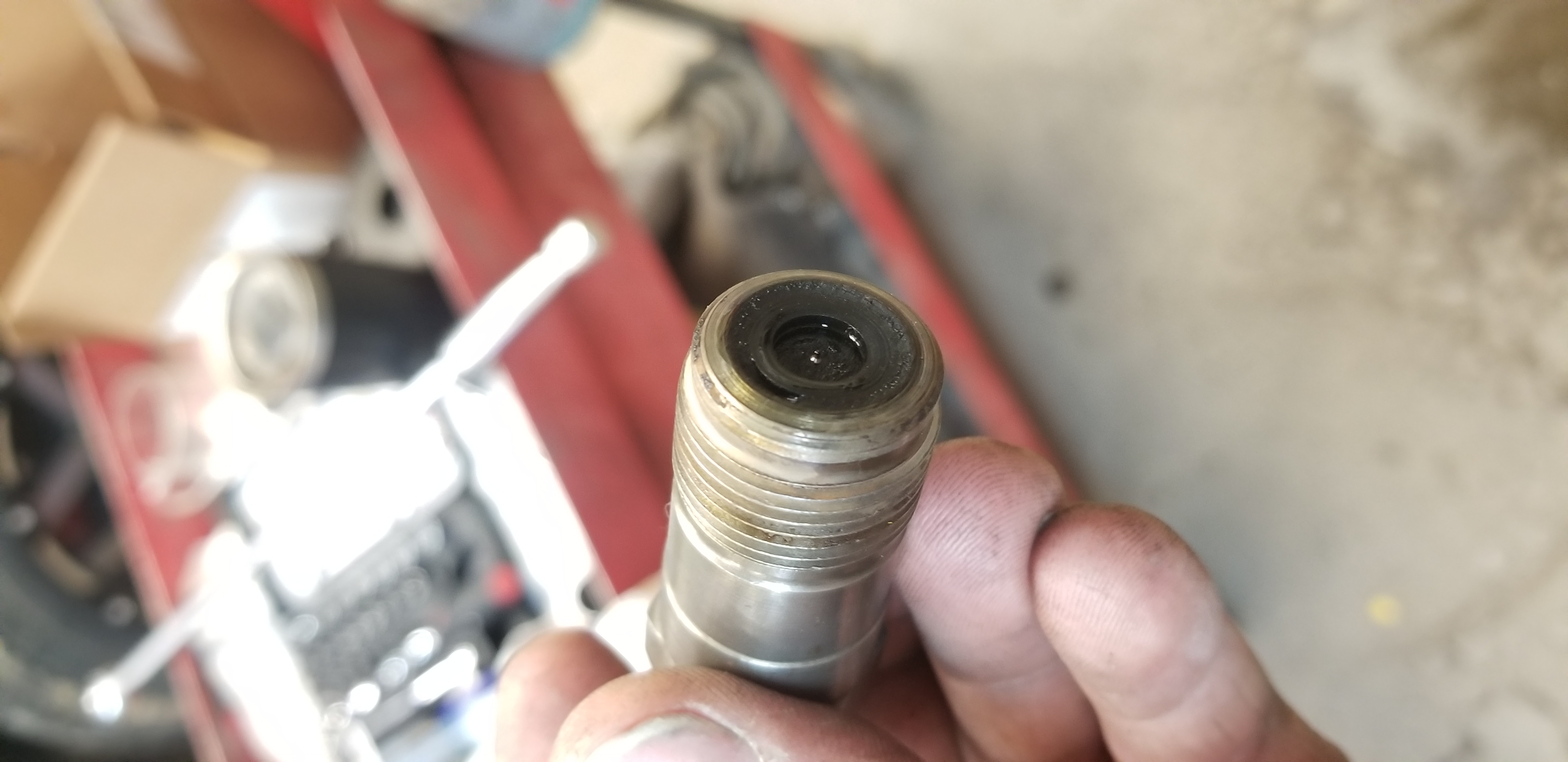

Hello gang,  I would like to discuss the the possibilities of pre-chamber servicing and rebuilding and diagnosing potential future problems of Pre-chambers.
I recently purchased a used cylinder head that ate a couple of chambers. It was sold as is, having four remaining good chambers still intact.
I have the Mercedes pre-chamber slide hammer tool and I used it to extract the remaining good ones as well as the damaged chambers.
The damaged chambers were mushroomed from getting hammered in the combustion chamber so I had to use a die grinder to remove the flared out portions as well as some of the burs. The head is pretty mucked but I did whatever I could to not make any further indentations on the head. All eight valves are bent in the corresponding cylinder one and two.
I gotta say, the Mercedes slide hammer tool, is totally inadequate for the job. It requires a tremendous amount of force to remove these things. Well at least with the cylinder head off the vehicle.
The method I ended up using required that the head was stood up on end, and pivoting it away from me whilst using the slide hammer bit with both hands. I removed all six but my hands are rekt.. Even with gloves.
That said, when I removed them. It became evident that the good ones weren't that far behind the damaged ones.

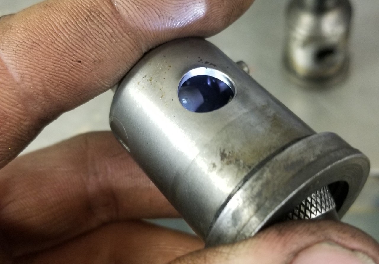

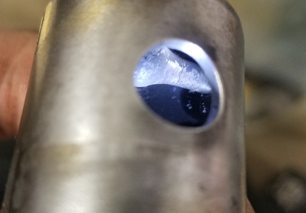

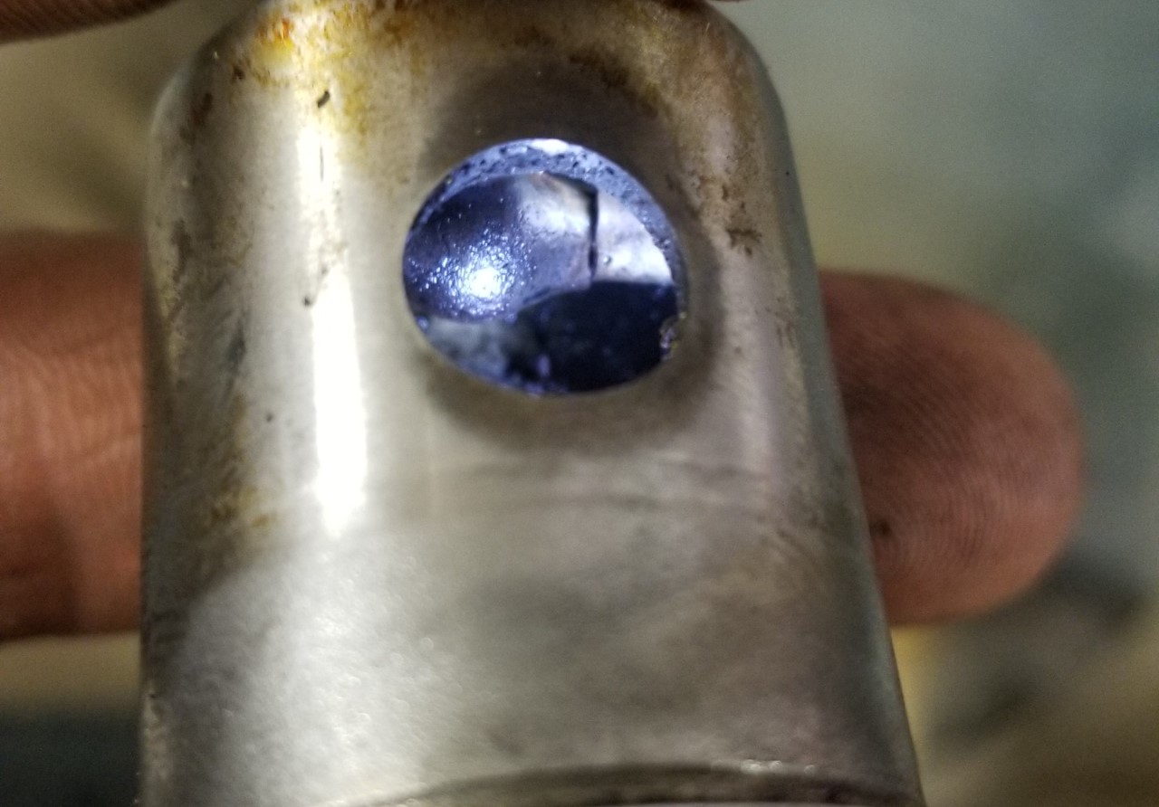

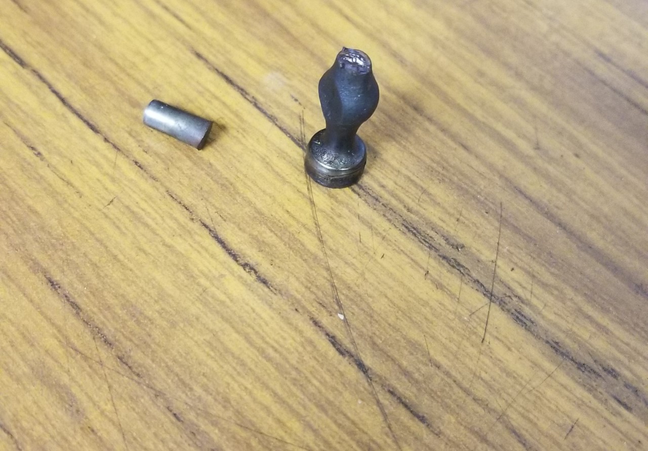

The so called "Ball, fuel vaporizer?/atomizer" is actually a shaft that round at the center with the one side facing the injector and concave towards the downward ports on the Pre-chamber. The shaft is pressed and staked in place with one solid line. And I believe turned or polished to the shape of the chamber body.
Well.... only when the pressure of installation was taken away (that is removing them from the cylinder head Pre-chamber bore.) Small cracks were seen on the opposite side of the staked end. They were actually in two pieces at this point. The other end, that we will refer to as the pin side of the vaporizer. Had the cracked side just off where the "ball" starts to taper down to the pin end.
You can hear them jingle when shaken. So I took them to the vice with a rag on end and I managed to tap out the pieces from the pin side and fire the rest out of the staked side. Which didn't take much effort by the way. Out they came in two pieces.
I got one good chamber out of the four. The bodies however are in excellent shape. So brings me to this..
What sort of material are these Pre-chamber (vaporizer balls) constructed of? They are magnetic is what I found. But could they possibly be manufactured and replaced before the pre-chamber loses its end and destroys your engine?

Also to note, the bodies of these pre-chambers with the broken "balls" look perfect.

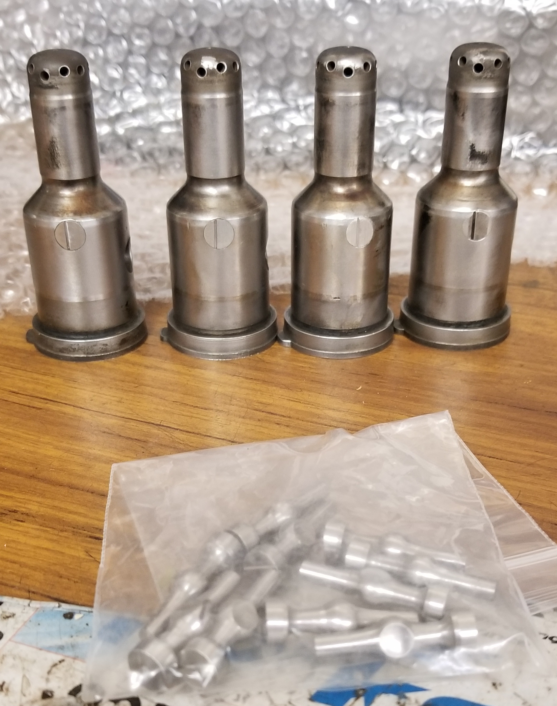

Well I am looking for a sustainable solution Mr... I have the Cad drawings now. Just need a material to select then I will pull the trigger to have them done.
What metal to use?? I am no metallurgist. But I will probably tell the machinist to put a broken precup to the grinder to see what colour the sparks are and then go from there... Well not exactly.. Hehe.

RE: Pre Chamber discussion - TE27Levin - 04-01-2022
Well there they are. Looks like they fit. Went with 17-4
RE: Pre Chamber discussion - vica153 - 04-03-2022
Looks good. Now just need to test them out!

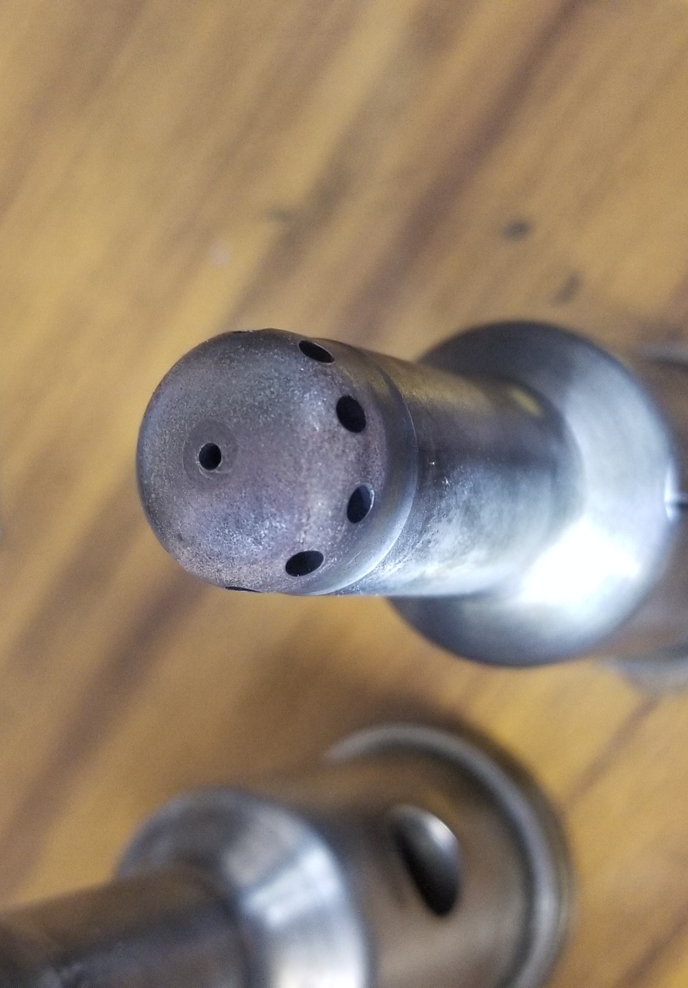

I used my mercedes pre chamber slide hammer tool to remove number 5 chamber first. The tip of the pre chamber was pink from heat and had some pitting. It looked like a stone. I popped the chamber ball out and it looked fine. I then removed number one. I cleaned it up and tossed it into number five as it was near perfect.
