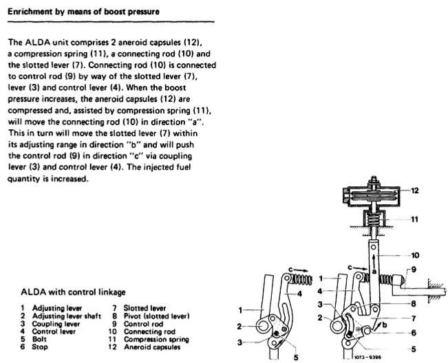

My opinion on the ALDA. It servers more than just a emissions device, it also is a mechanical "anti jerk" device, that is when coming off idle it keeps the car from jerking. The later electronic controlled IP's have this feature built in.
Rack limiter limits how far the rack can open, without it, it hits a an internal max stop. Check the threads related to these, plenty of info on all of this.

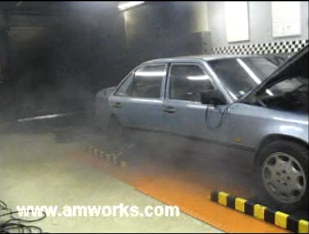

Quote:*shrug* Myna doesn't do it,
Have you actually watched a myna-powered video? Huh
I have yet to see a single one that doesn't puke black smoke. Even the supercharged engines used in the Green wagon (both the 617 and 606) smoke when they revv it!
Attached is just a small sample of Myna powered vehicles.

Sorry, Forced, I still disagree with you... at least on a W124 with OM603 engine. With the full load maxed out, there is simply way too much fuel delivered at low RPM's. The second half of throttle travel is useless... the power that used to require 60-70% pedal travel, now only requires 20-30% travel. You end up with too-early shifting and possible flaring, along with a touchy accelerator pedal. You can't compensate via Bowden cable because when it's shortened up enough to fix the shift RPM's, it then restricts throttle linkage movement, and will bend the brackets if you force the pedal to the floor! Been there, done that. And, the end result offers ABSOLUTELY NOTHING except an 8-ounce (?) weight savings from the ALDA removal! Again - it offers NO ADVANTAGE except a nice placebo effect that you get "more control" over the rack (which I still disagree with, but if it makes you happy, that's fine).
The "adjustment" you speak of is installing the ALDA and setting it to correctly fuel at low RPM / low throttle settings. The power delivery should be linear from min throttle to max throttle, not peaking at 50% throttle travel. Again, your experience with 617 engines may differ, and I can't debate that since I no longer own any 617's. Maybe it works great on those, but on the OM60x, no freaking way.
(12-26-2009, 07:09 AM)ForcedInduction As has been said before, the ALDA is just an emissions device. It has no importance to tuning other than preventing smoke in low boost and high throttle conditions.
This is not true. The ALDA also makes the throttle action more linear, as described above. This is critical because the transmission vac signal is derived entirely based on throttle position, not engine load as on a gas engine. And the VCV on the side of the OM60x IP does not work well at all when it's tweaked... it's designed to be set to the max throttle linkage position only (i.e., you can't tweak it in either direction to tailor shift quality to your liking). When the VCV is anywhere outside the factory-specified setting, it results is screwy shifting, Been there, done that too. Again, the 617 has a totally different VCV setup on the MW pumps so maybe you have adjustments which work on an MW-fueled 617.

RE: alda removal - tomnik - 12-03-2010
Hi,
when a pump is "weal" it might be a leaking ALDA.
The seal on the shaft of the ALDA leaks and the pump sees no boost (or only partially).
Trans: the bowden cable is one thing but for tuned engines the modulating (hydraulic) pressure should be increased to prevent flaring.
How to measure and modify is somewhere in an old post.
Tom
RE: alda removal - JoRoTeK - 12-03-2010
(12-03-2010, 01:30 AM)tomnik Hi,
Tom
I was under the impression that with the ALDA removed, there would be no worries about a leaking ALDA. On another note...what does "weal" mean?
RE: alda removal - willbhere4u - 12-03-2010
[/quote]
(12-03-2010, 02:28 PM)JoRoTeK
Tom
I think "weak" is what he ment
RE: alda removal - tomnik - 12-04-2010
Sorry, "weak".
Of course with the ALDA on...
With leaking ALDA you don't have enrichment under boost.
Tom
