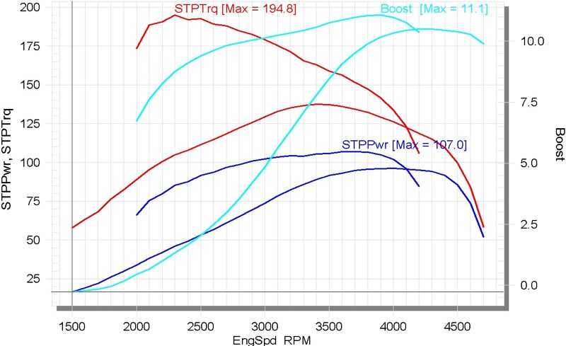

04-25-2010, 06:55 AM #54
(04-24-2010, 03:01 PM)muuris Where does the increased efficiency show in practice when one puts a HX30 to a stock 617 (other than between the driver's ears)?
In fuel economy and power to the ground.
Quote:And how do you have capacity to increase power without modifying the pump?
Pumping and thermal efficiency.
Quote:Don't count the few dozen hp you can get by altering the pump settings alone.
Just the 18hp I got switching the K26 to a GT2256V.
Quote:As for increasing power without modifying the pump, it can't be done without pump mods.
I disagree with that. As shown below, power can be gained across the RPM range with just a better turbo and no alteration to fueling.
Quote:One needs both.
Ah, so everyone might as well dump $3000 into the engine all at once instead of getting it one component at a time and learning how each affects the engine?
