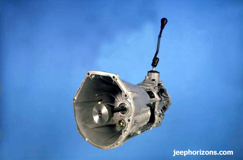

02-23-2009, 09:30 PM #60
(02-16-2009, 10:13 PM)winmutt Anyone got pics of 265's?
I guess that means me and my 265 install.
[Image: DSCN3740.JPG]
Here is a link to the rest of my 265 photos.
http://picasaweb.google.com/GWCullen/Getrag265Tranny

02-24-2009, 02:51 PM #61
Excellent. I poked around a few BMW last weekend, the 260's are avail by the dozen. I am looking for cheap internals to keep my build down.

02-24-2009, 05:17 PM #63
The BMW internals are really expensive, but I hear the 265's are good for 450+ hp all day long and are long lived. So as long as it has not been run low on oil, I think it will last forever in a MB.
I just sent my proto bell to a guy in FL from the mercedesshop to put up on a CMM and see if I missed something with the alignment. I have a vibration that I can't get rid of, so the 4 speed is in until the spring, or until we can find the source of the vibration.

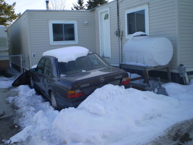

02-25-2009, 09:03 PM #64
this is the car I was going to look at but found out it was in alberta with a busted timing chain! it has a rebuilt 5 speed!
