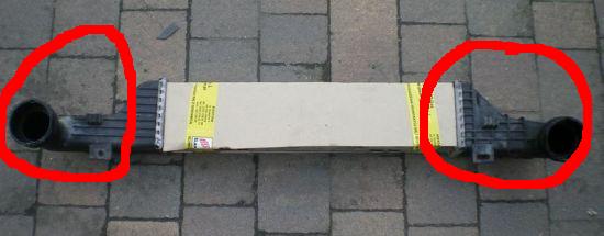

Intake MAF less to turbo:
[Image: 20121221_162844orpko.jpg]
Next step GIGANTIC INTERCOOLER ^^
[Image: 20121228_154705k9s92.jpg]

cutaresku
8
12-30-2012, 05:41 PM #76
You're kidding me, right?!
WHERE in the world are you going to mount that TINY piece of radiator?
You also got rid of the oil separator, as I see. There's also no MAF.
As for the boost gauge line, you're lucky enough not to have the shitty plastic intake manifold (just replaced mine several month ago, close to 500 euro). I'm therefore a bit hesitating in drilling a hole in that plastic...
Very, very inspiring work. Many thanks and keep it going!

W210, 2001, OM611.961 105kw, 6+1.
majesty78
226
05-30-2013, 01:54 PM #100
IC hoses connections is very simple.
Due to the 800mm with of the core + the with of the end tanks, the cooler is exactly as broad so that the meet up with the stock hoses position which leads to and from intercooler.
So there are just 2 pieces of straight aluminum welded on the rear of the end tanks and then connected to stock hoses. (removed the "click" adpaters which blew off several times)
The bumber is cut, on above pictures it is just the "raw" built to take it for test drive and see results.
The crash bar is not cut, this is still stock.
