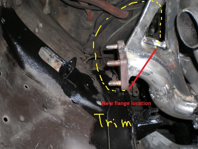

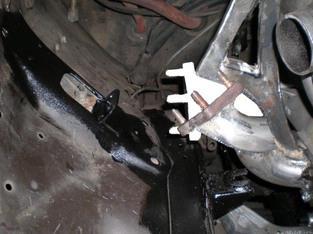

and I think the problem here may be clear. oops. Back to the drawing board.
[Image: 006-4.jpg]

starter in-
[Image: 005-4.jpg]
[Image: 006-4.jpg]

I don't know man, but I think the Cali Manifold and bypass pipe is looking way better at this point.
the spacer is on both sides, its some kind of soft, pliable rubber. I have no idea, but i think its oem to this 115. Maybe some kind of noise damper?
no no! Ill make it work! Big Grin
(plus I cut all that stuff up anyway to make this)
All I need to do is cut this apart, extend it, and pitch it back to open up the space. Also, secondly, the over the long runner manifold brace is too high, so ill be remaking that to run through the manifold instead.

Bam, I fixed it in like 2 hours welding:
This post was last modified: 09-27-2013, 03:21 PM by Simpler=Better.
09-27-2013, 03:20 PM #67

(12-02-2013, 01:06 PM)JB3 ok, throwing out all that earlier plan and remaking a 90 degree pipe instead of an S, and/or making a header.
Ive been doing several weird things-
1- Ive been making a compound curve S pipe because Im not familiar with turbos and didn't realize how easy it would be to reclock this thing.
2- A small diameter pipe S is incredibly restrictive right before a 3 inch exhaust. That arrangment makes no sense.
The feed pipe is seeing what, 20psi? The exhaust *should* be seeing "0" psi. The turbo outlet is usually larger piping than the inlet.
As for a header, oh it's going to be absolutely better than a stocker+S pipe. But you're going to spend a lot of time hunched over in there unless you have a spare head.
For the 5-1 transition there is a website that prints out paper templates for wrapping around a pipe, so that you can cut your weird merge angles for welding. I'll be darned if I can remember what it was called.
my plan for the 5-1 merge is to cut up toilet paper tubes and work it out. Big Grin
My issue with the feed pipe is that the S is restrictive needlessly over a much simpler and better 90 degree bend, that wouldn't have the rough surface inside, and would be essentially two welds to make it work, as well as eliminating the compound curve that ive built into this S. I could adjust the direction of the flange to point anywhere by just rotating it on end of a 90 degree section of pipe
