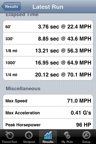

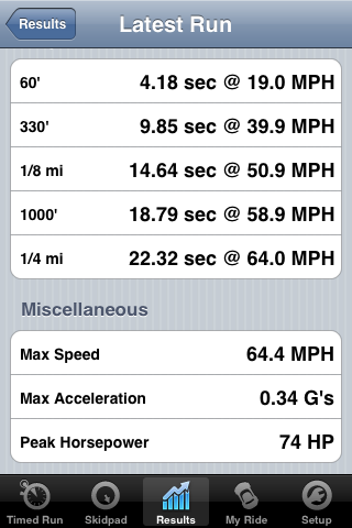

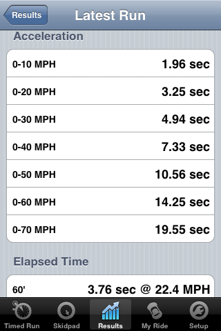

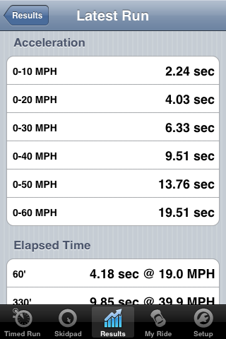

07-09-2009, 03:30 AM #53
This last weekend I changed the soggy and torn engine mounts, fixed the drivers door lock and discovered my odometer died at 530 miles. Looks like no mpg readings for a while...
New dynolicious run from tonight.
(Note: Stock settings M-Pump)
74hp is about right. I figure 88hp non-turbo fueling rate minus a few HP absorbed uselessly driving the turbo.
Compare to the stock MW-pump.
So "feels about as fast as a turbo" isn't a far off description.
This post was last modified: 07-09-2009, 03:36 AM by ForcedInduction.

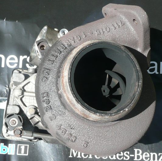

07-20-2009, 03:07 AM #59
The 2256V is off the 240D and waiting for manifold gaskets to arrive.
The 2256 was badly in need of cleaning. Soot was caked so bad its no wonder the 240D could boost to 15psi, the vanes weren't opening all the way.
I also swapped the Galant seat into the 300. The stock MB seat is just too unsupportive, high and bouncy.

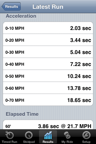

07-22-2009, 03:09 AM #60
Ihe 2256V is in. Big Grin I got a heck of a deal on manifold gaskets, two kits for $20.55.
Power is a little low, its only making 11psi and I need closer to 14psi.
It cut a tenth off the 1/4mile and 0-40 acceleration is significantly quicker but top end is lagging because of the low boost.

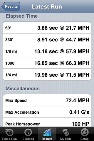

07-28-2009, 07:49 AM #64
New run now that I have my 15psi and full power. The pump still has some adjustment room left, I may turn it up some more before the races on the 2nd.
Finally, 100whp. Big Grin
When I get the air-water intercooler installed I'll do an official dyno.

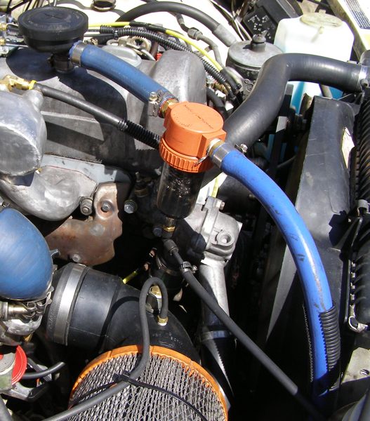

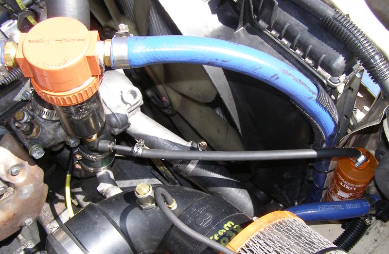

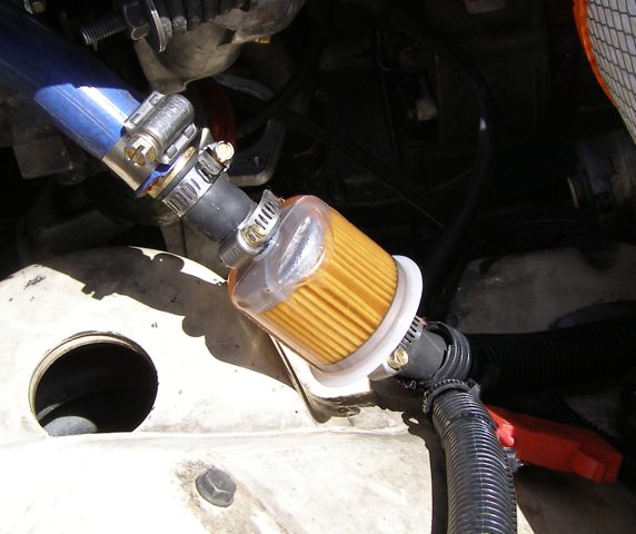

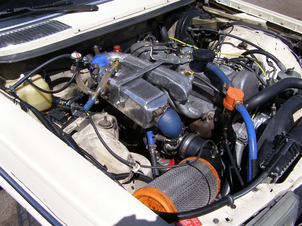

05-16-2010, 04:22 PM #89
Some advancements.
New and improved larger air filter design.
[Image: attachment.php?aid=2768]
CCV system is vented to the road to prevent intercooler fouling.
A coolant filter was added to try and remove the remaining sediment that triple flushing didn't get out. Its a g@s filter (Fram G3) but so far its working well at catching the water particulates without restricting flow.
I also added a bottle of Redline Water Wetter to both circuits. So far it seems to be working well, its staying rock steady on 82*c where before it would creep to 85*c at low speeds.

06-04-2010, 05:06 PM #91
What kind of stuff have you found in the coolant filter? Always been kinda curious what kind of "stuff" was floating around in our coolant...

06-05-2010, 05:59 AM #92
Mostly rust particles left over from the previous owner's old coolant. That filter plugged up and collapsed after a few hours so I removed it. I've got a leaking freeze plug so when I change it I'll do an acid flush to get rid of it all for good.

06-05-2010, 10:11 AM #93
(06-05-2010, 05:59 AM)ForcedInduction That filter plugged up and collapsed after a few hours so I removed it.
Woah!! How nasty did it look when you took it out?

06-05-2010, 05:20 PM #94
It was mostly that rust particulate, so pretty much a darker orange color. Though the waterwetter gave it a pink tinge.
