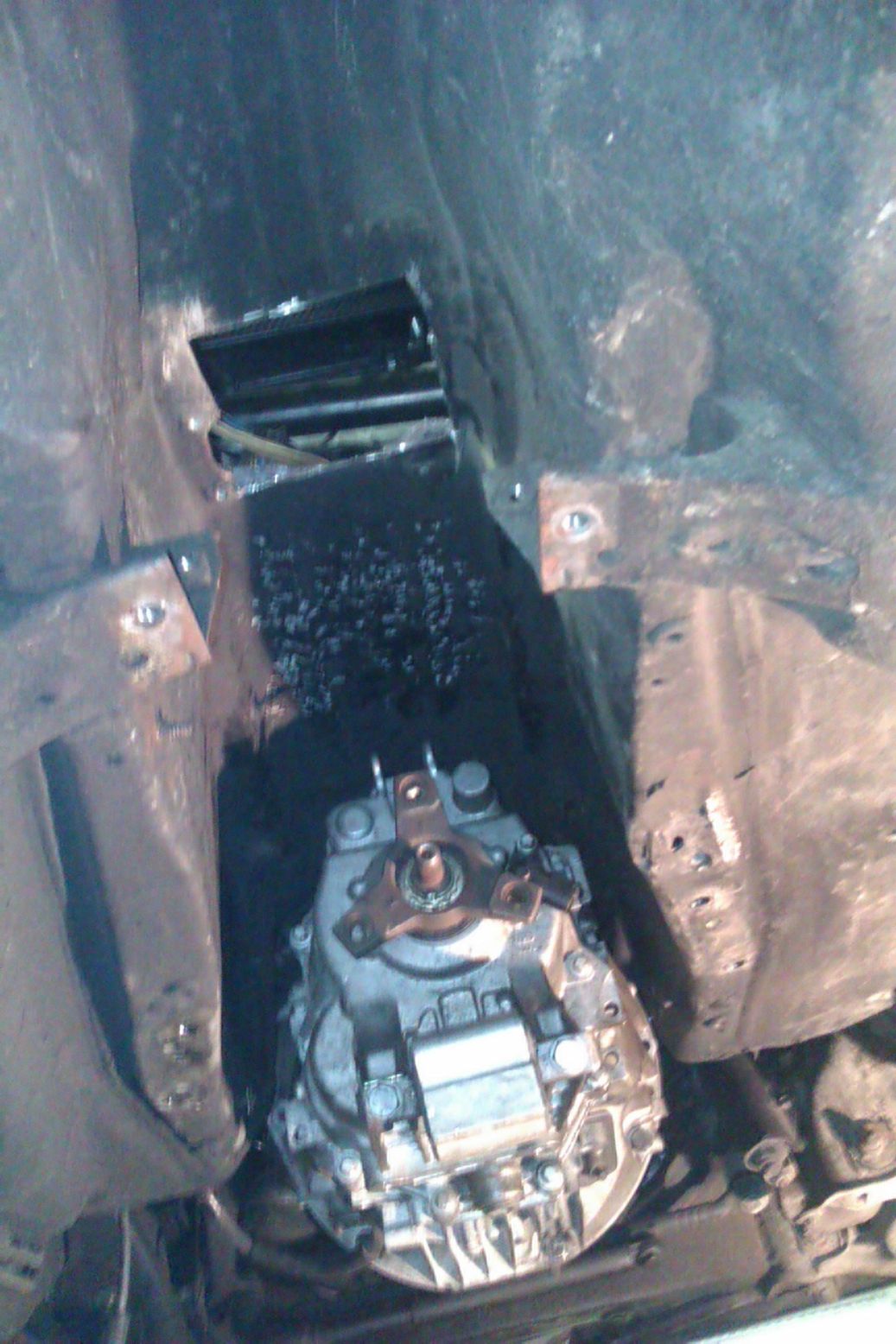

11-28-2012, 07:02 AM #67
(11-23-2011, 07:05 AM)hansebanger77 i think not many people look in drivetrain topics so im sorry i ask here again.
it was a 717 433 bevore and i bougth the same again. now its broken again. every time the 3. gear is damaged... 1. and 2. gear always spinning tires sometimes 3. too. because long diff. if i get grip the 3rd it break.. Sad
any better boxes on mercedes secor?
if it is not absolutely necessary, then I would shift myself. So no automatic.
thx
what car is that from??
is it a 5 speed from 124??
Ksteen2

EDH_Performance
537
11-28-2012, 09:21 AM #68
(11-28-2012, 07:02 AM)Ksteen2
thx
All 5-speed gearboxes from w201/124 is rubbish! 3rd gear will always break with a bigger dieselpump and turbo Big Grin
EDH_Performance
thx
erling66
SuperDieselVan
294
11-29-2012, 03:08 AM #69
Well, all the standard ones are but not the W201 2.3 16v getrag box and I heard that w124 300e 24v gasoline used a good getrag box too :o)

Ksteen2
304
11-30-2012, 07:48 AM #70
how's the 5speed cdi box contra the 6speed cdi???
