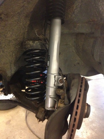

09-12-2013, 10:42 AM #52

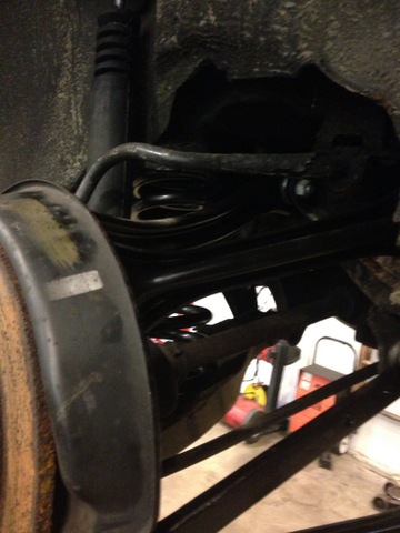

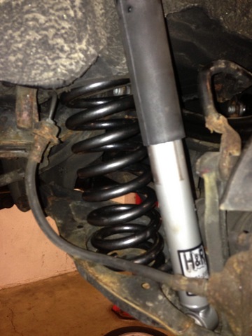

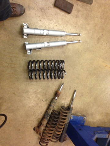

Pictures of the H&R cup kit as well as new rear control arms.

09-15-2013, 05:32 PM #53
Care to share the wire diameter of these springs?

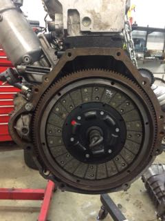

09-17-2013, 11:24 AM #54
(09-11-2013, 11:56 AM)raysorenson Did you go with a red plate? What disc?
Clutchnet's website stinks, so dont rely on their red, blue purple listings. Just call them, they always need to make the stuff from OE parts or full custom.
I sent them a 16V pressure plate and disc that they are modifying.They are building a custom friction disc with a HD organic material, don't get caught up in Kevlar or carbon Kevlar as they do not last long and offer only marginal holding power over HD organic, also they glaze very easly is slipped to much. I ran a 6 puk on my old Starion and it held great but was mostly undrivable, so hopefully i don't need to go that route..

09-23-2013, 10:54 AM #55
(09-15-2013, 05:32 PM)raysorenson Care to share the wire diameter of these springs?
Rear is 14mm
Front is 14.5mm

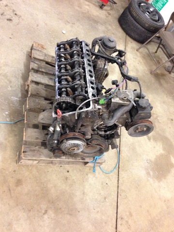

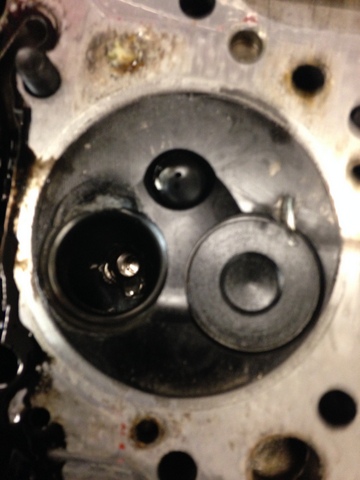

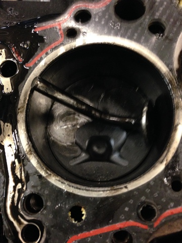

10-24-2013, 07:22 PM #56
:::SIGH::::
For those who follow you may have know my car clattered to an end the other night. Brand new valve broke at the top.... Hence my search for a 605 now.

10-24-2013, 09:39 PM #58
I'm following. I was gonna do all your valvetrain mods to my motor :-(
Any guesses as to the cause?

10-25-2013, 09:23 AM #59
(10-24-2013, 09:39 PM)raysorenson I'm following. I was gonna do all your valvetrain mods to my motor :-(
Shitty AE (Federal Mogul) valves. No reason that should have happened to a valve. No sing of overheating, the car doesn't see much time at 6000RPM. The M103 springs are only 20% stiffer then the OM602 springs so i don't believe that there is to much spring tension on them. Besides M103's use larger valves ( read heavier ) and rev higher with the same keepers, retainers ect.

10-25-2013, 09:38 AM #60
That sucks Can OEM valves be obtained from Mercedes? Is the head salvageable the block looks to be ok minus one piston

10-25-2013, 10:03 AM #61
(10-25-2013, 09:38 AM)willbhere4u That sucks Can OEM valves be obtained from Mercedes? Is the head salvageable the block looks to be ok minus one piston
Oh yeah OE valves are in stock in NJ, head the block has a big dent in it..so it's dead. I would need to machine it, press in 1 or 5 liners, new pistons ect... then maybe try to fix the cylinder head. At that point it's cheaper to get a used engine. Pistons are really pricey,

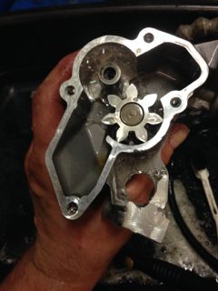

12-20-2013, 12:43 PM #62
    OM605 on the Boat.......

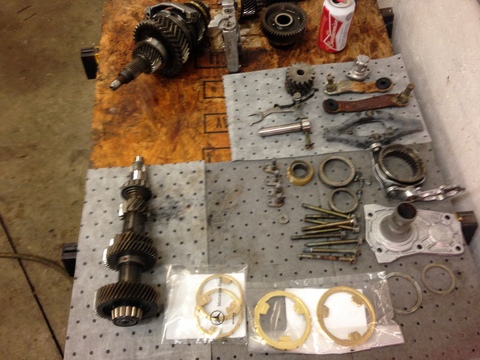

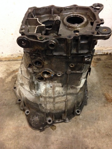

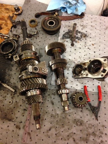

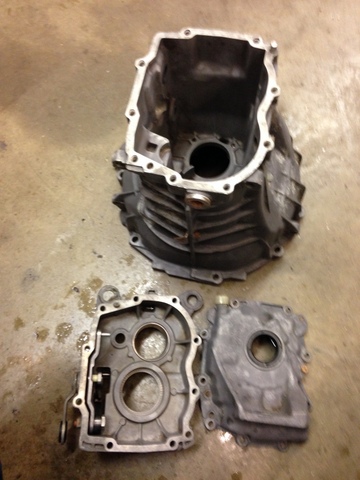

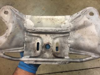

01-03-2014, 09:10 AM #65
Got the 717.430 all torn down and rebuilt. New syncro's, MB gasket kit and new counter shaft and main shaft bearings.

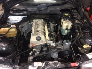

01-06-2014, 10:09 AM #66
First 605.962 in NH??
Thanks for all that helped!

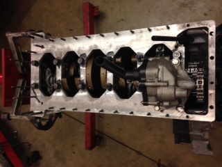

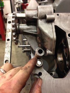

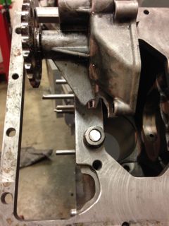

01-23-2014, 03:39 PM #67
605 Girdle being cut this week.
.pdf
605 602 girdle.pdf

HaavardPYA
189
01-23-2014, 03:48 PM #68
What gauge are you using? Both egt, boost and back pressure? 52mm? Need link Big Grin
This post was last modified: 01-23-2014, 03:51 PM by HaavardPYA.
HaavardPYA

EDH_Performance
537
01-24-2014, 11:52 AM #74
(01-23-2014, 03:39 PM)Duncansport 605 Girdle being cut this week.
I am very curioius what you are gonna do with the oilpumpSmile Longer chain?
EDH_Performance
Duncansport
526
01-24-2014, 12:27 PM #75
(01-24-2014, 11:52 AM)EDH_Performance
Yeah. Same type of chain as a saab b234, I'll add a link or so.

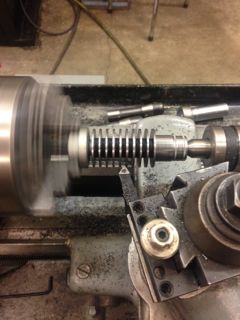

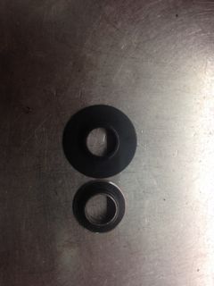

04-15-2014, 07:26 PM #82

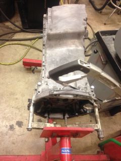

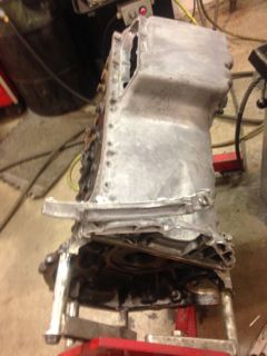

So it's been a slow go here, waiting for the machine shop, parts , etc..
But here i have modified the oil pump and oil pan (due to the girdle)
Turned down some Ford modular spring seats to fit the head
Duncansport

Duncansport
526
05-07-2014, 07:37 AM #84
(05-06-2014, 07:36 PM)led-panzer How's the 605 coming?
Good, slow but good. the bottom end is all set. Took a bit of time to modify the oil pump, drive chain, oil pan and get the oil jets installed and adjusted.
Waiting on the cylinder head, and still trying to buy a flange from KKD (which is proving very difficult ) i may just make my own flange and offer up the drawing.
Duncansport

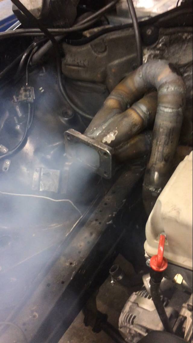

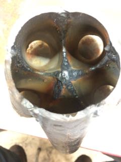

11-14-2014, 07:04 PM #85
Well its been forever getting my cylinder head done as the exhaust valves were on back order from M-B Germany. Heads done with new guides, seats, valves, springs, lifters, welded cam. The engine is 98% back together and should start next week. Ill get some pictures up soon.
Ive also finished building my merge collector.
Duncansport
11-14-2014, 07:10 PM #86
Was the cam welded for a regrind w/same base circle or just to weld the gear to the shaft?
Good to hear of progress on this beast. It was already pretty impressive with shitty trans and a 602.

11-15-2014, 03:57 PM #87
(11-14-2014, 07:10 PM)raysorenson Was the cam welded for a regrind w/same base circle or just to weld the gear to the shaft?
I welded it due to the know slippage. And with adding double the spring pressure and a 1700 rpm rise in rev limit i didn't want it to slip on the cam
Duncansport

11-17-2014, 07:32 PM #88
https://www.facebook.com/video.php?v=102...=2&theater
not sure if this will work for you, had the first start up today...:-)
Duncansport

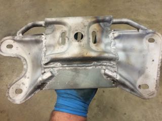

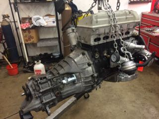

11-23-2014, 06:19 PM #90
http://youtu.be/pm8cFG7FPpM
give that a try folks.
Got a lot done this weekend, had to make a transmission cross member, lengthen the shift rods, install the shifter, built new wiring harness as well as the other related wiring and vacuum lines all incorporated into into one. Got the assembly installed in the car. Started striping parts off the old 400E loaner car we had.
Duncansport

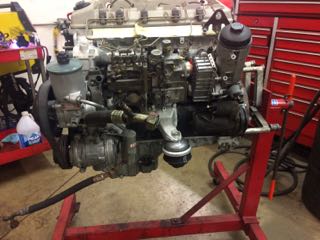

11-24-2014, 05:53 AM #91
Some pictures
Duncansport
Some pictures

02-11-2015, 01:37 PM #92
Duncansport
Duncansport
526
02-11-2015, 07:49 PM #93
well theres some pictures that dont work ;-/. More to follow
Duncansport
02-12-2015, 12:28 PM #94
The manifold work looks great. Are you going to have to rotate that flange?
Forum attachment pics don't work for me using Chrome. I have to left click ->open image in new tab. Off-site pics using the img code seem to work fine.
