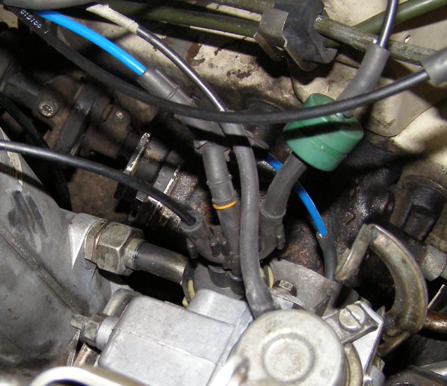

The shift flaring was fixed at the vacuum control valve by installing a 0.8mm orifice to the main vacuum line and moving the 0.5mm orifice that was there to an added Tee to the vent line via 4-way (pictured).
