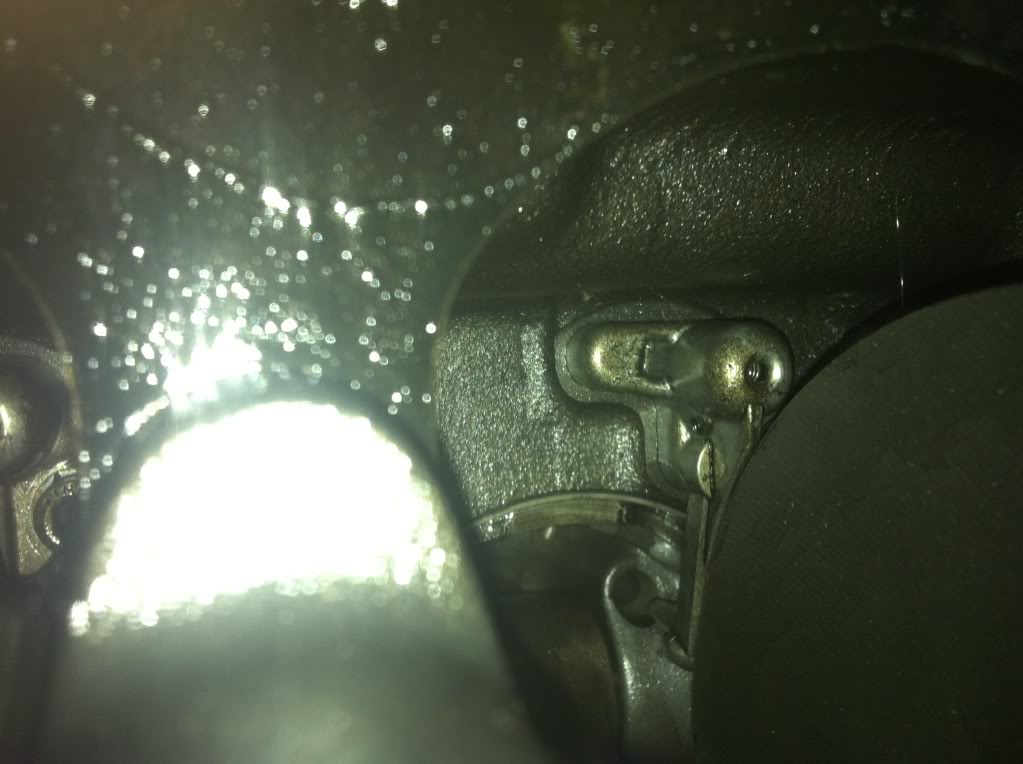

10-22-2013, 08:33 PM #54
If you still need pics, these are the best I have right now. Took them when I was tearing down a 617a I plan to put in my 240d. But as it turns out #1 piston was melted above the top ring. So my hunt for a decent used piston continues...
I can get pics of the piston and rod tomorrow when I'm at the shop. Can also measure the rod length if you need that.
decent view of squirter and piston in #2 and #3 cyl
[Image: 2nta3a0.jpg]
#1 piston squirter already removed
[Image: 24vr69h.jpg]
#2 view of exit hole in piston
[Image: 2411krs.jpg]
#1 and 2, 1 squirter removed
[Image: riclsn.jpg]

10-25-2013, 11:37 AM #55
Nice pics.. Thanks!!
Looking at them gives me some worry that the 616 block doesn’t have the area that the 617a does where the squirter nozzles are. And the nozzles do not look like they would be use full with a 616 piston because they are aimed so close to the skirt, I would want them to be aimed at the dome as much as possible...
Now I could make some nozzles... But still concerned that the 616 casting is not adequate...

10-25-2013, 09:18 PM #56
Yes, there is an extra boss cast there for the squirters. The outer 2 holes are only lineup dowels though. Might be able to machine off part of that. In the last pic the squirter is on the ground, blurry but might help.
The squirter hole is indeed right next to the skirt. Not optimal but I assume the duct through the piston corrects that?
Rod lengths are the same between the motors and I assume compression height is on pistons is too. Seems like If you COULD get the squirters in the 616, 617a rods/pistons would be the way to go. But personaly I've had a hell of a time just finding one usable piston. Lemme know if you find the motherload somewhere LOL

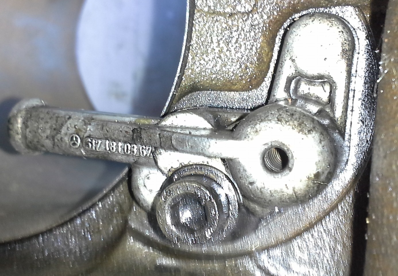

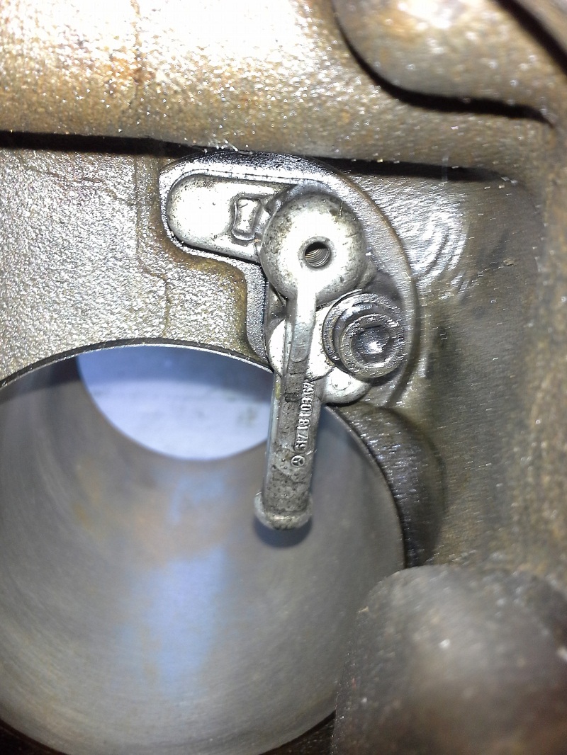

10-02-2014, 09:11 AM #68
5 of these badboys available, a 617 block with 1 scored liner, 4 looking ok liners, and a crank that appears to be okay-although one of the main caps has a 615 part number?!?
If you need more pics/dimensions I can get them for you

10-02-2014, 10:21 AM #69
Simpler=Better, many thanks for the great close ups!!
I am planning on picking up a 617a engine in state to rob the pistons, rods, squirters, and use the block as a template.
The 616 block I have is still in the truck, but looking at your pics, I am questioning, 1 if there is enough room for the 617a squiter between the cylinder and the oil supply in the block which is humped up, and 2 the oil inlet to the squirter is not in a good place given where the 616 supply is in the block.
I definitely want to have the 20psi check balls in the squirters so I was hopeing that I could use the 617a ones, but I may have to make custom ones, which does not really excite me in the least.

10-07-2014, 04:01 PM #70
I just got the block out of the back of the truck, and got the pistons and crank out of it.
The #1 rod is completely gone as is the lower half of the piston, split at the wrist pin. All the bearings are like new, and the oil pump looked to be in great shape, so it was not a lack of oil that caused the rod to disintegrated.
Anyway... After looking at the bottom of the cylinders, there is no way that 617a squirters will ever work in the 616 block. The oil supply is in the right area, but the casting is not even close to machineable in order to mount them.
I have been figuring I would have to make some if I want them, and it looks like each one may be unique to each cylinder. I will have them printed out of aluminum so they will be just like the real thing, but made for the 616 block with some careful machining to the block for them.

Well I got the block up on an operating table and under a working light lol... After spending some time looking at it, I came to the conclusion that I need to get a 617a squirter to see just how small it really is. It’s hard to get perspective from the zoomed in pics lol...
There still may be a chance that the 617a squirters may work, I'm fearful of machining back into the side wall too far, I don't want any cracking long term.
I also noticed while inspecting the pistons that there is concentrated scuffing where the two rear PC ports are, obviously heating the piston at those locations causing more local expansion. Nothing scary, the anti detonation grooves are still there, just worn a little more in those spots. Could have been from running it to hard before it was warmed up in the winter time.. I think cooled piston domes would be a plus for sure when really pushing the power for sustained periods of time, but for short bursts, quality NA pistons would probably be just fine IMOP.

thats interesting. i always thought the #1 rod throw due to low oil and the wrist pin not receiving proper lubrication. seems like its something to do more with the wrist pin itself(or the rod) but im not sure why it would happen to #1 a significant amount more then any other rod.
I wonder how much lower comp would help? i mean to between 18-19. Seems to do wonders for the old chevy 6.2. stock is 22, and gutless, turbo it and you have power but no longevity(unless you live by your pyro), but it seems marine piston(they r 18) will solve the longevity problem. this is not from personal experience just wat ive heard.

What about building up the block with brazing rod to have a boss to build on?
