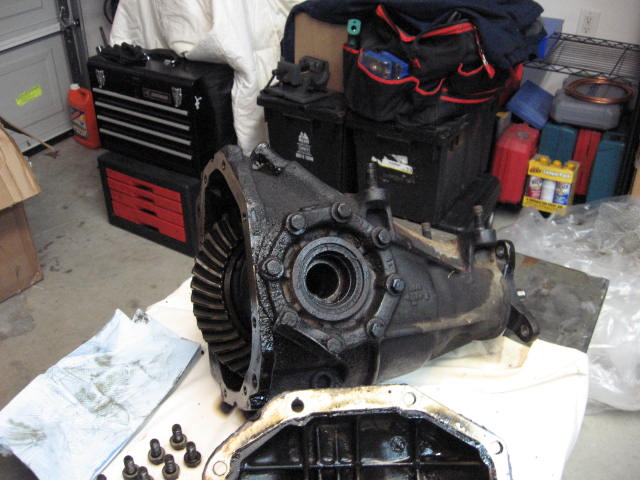

Here's a picture of the Diff. Is this the LSD ? Just want to make sure.
Is there a stamp on the side like the normal differentials in the W123. For example, on a 1985, it is stamped on the side 2:88.
Would this have it too ? EG, 2:65 LSD ??

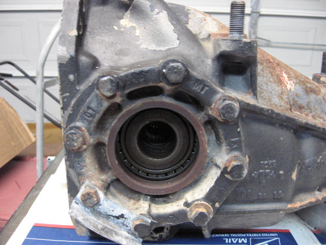

02-09-2014, 05:38 PM #52
The ratio should be stamped into the lower left rear flange as here...
[Image: 11.jpg]
Not sure about LSD info.

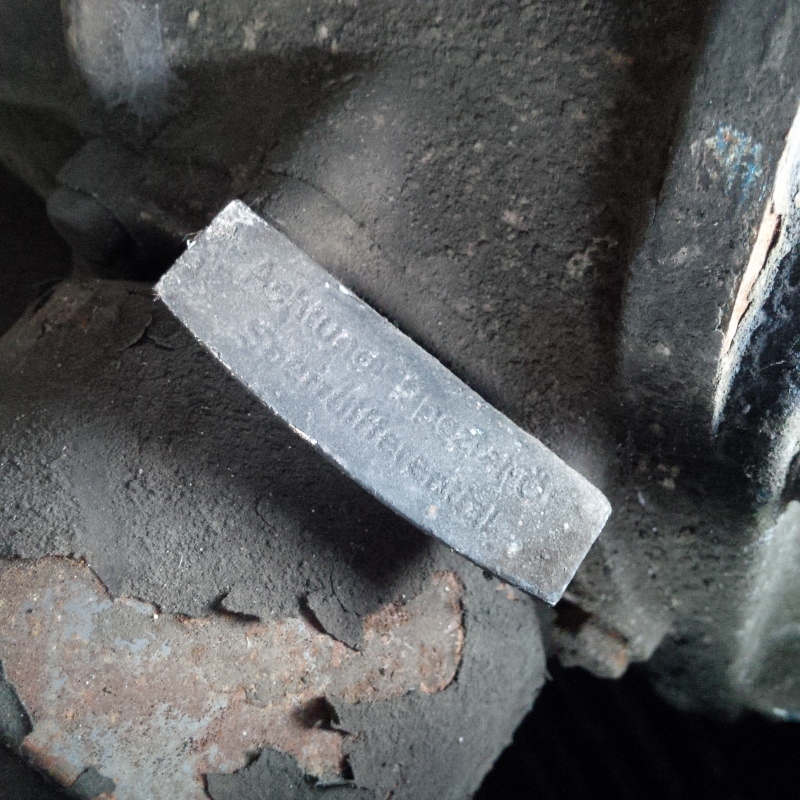

02-09-2014, 06:25 PM #53
(02-09-2014, 03:44 PM)Greazzer Here's a picture of the Diff. Is this the LSD ? Just want to make sure.
Achtung, Spezialol (attention!: Special oil!)
Sperrdifferential (blocking differential, i.e. limited-slip)!
On the lower rear left at 8 o'clock to the cover is a flat flange which will have the differential's serial number followed by ratio ("2.65" you hope) and below that "SP" (SPerrdifferential) stamped.
Yep, that's the housing of an LSD all right. Of course, to be sure you have to look inside and see the clutchpack.
I'd show you a photo of mine, but haven't opened it yet. I'm against opening up a diff except in dry weather, on principle. There's 5 inches of snow on the ground and just above freezing right now.

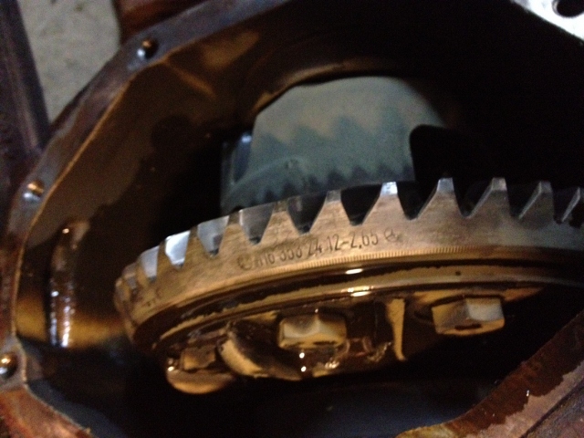

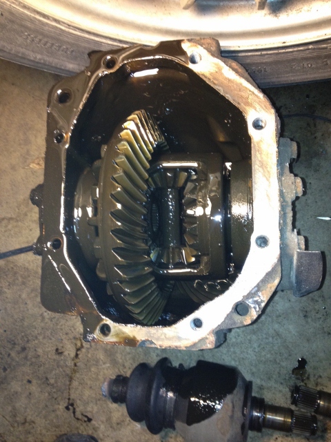

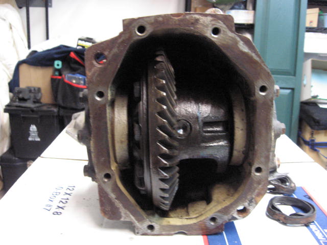

03-12-2014, 09:22 PM #60
Ok, got 2 pictures of the inside.
I am thinking this is the real McCoy !

03-13-2014, 04:55 AM #61
(03-12-2014, 09:22 PM)Greazzer Ok, got 2 pictures of the inside.
looks like you have the LSD in there somewhere beneth that dirty oil Smile
change of flange + clean it out and you should be good to go Smile

03-13-2014, 08:03 PM #62
what is this out of again '85 300d?

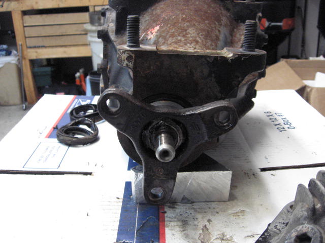

03-14-2014, 07:10 AM #63
I physcially got it ! Picked it up last night. It must weigh 50 pounds. It is definitely heavier than a 2:88 from a 1985.
What LUCK and TIMING ! To have to go to Fort Wayne, IND and have someone who just got a M-100 (1979 SEL 6.9) all within the same time period... Now, will the airlines accept it ??? LOL

03-14-2014, 08:06 AM #64
(03-14-2014, 07:10 AM)Greazzer I physcially got it ! Picked it up last night. It must weigh 50 pounds. It is definitely heavier than a 2:88 from a 1985.
50 pounds? id guess more around 125punds Wink i couldnt send my 2.65 with one shipping due to the wieght, and their limit was around 90pounds Smile
my 2.88 weighted 50pounds...
good to hear its the real deal, hopefully the clutchdiscs isnt to worn and it will work great Smile
(03-13-2014, 08:03 PM)Austincarnut what is this out of again '85 300d?
naa, that should be a w116 450SE 6.9, it is an 2.65 LSD differential.
the flange will have to be changed + spacerbushing + 30mm nut, tightened, and will fit his current car Smile

03-16-2014, 08:20 AM #65
Well, I was wrong by a mile on the weight by ALOT. Weighs 89 pounds according to the airlines. The airlines wanted $250 to ship it, so off to the UPS store. UPS Store and to ship 89.4 pounds ended up being around $138 which is more than what I paid for the differential itself.
Clutch Pack Worn ? Hmmm, another thing to worry about.

03-17-2014, 11:58 AM #71
(03-16-2014, 08:20 AM)Greazzer BTW -- is there an easy way to measure for shims? That is, which ones to use.
Clutch packs ... I trust they are incredible expensive and/of difficult to rebuild ...lol
The saga continues ....
The easiest way to measure the shims is to insert the axle, install the "c" clip, push the axles into the diff and eye ball the gap between the "c" clip and the spider gear. I like to use my extra spacers as a gauge for the gap of what I will need or use feeler gauges.
The FSM of diff rebuilding with clutches..
http://www.w124performance.com/docs/mb/o...ld_FSM.pdf

03-17-2014, 12:16 PM #72
Thanks DV.
I figured out the relationship between the shim on the outside, on the axle and that shim thickness effecting the clearance or gap from the "C" clip and the amount of space at the end of the axle. Thicker the shim, the more the axle is "pushed" or moved away from the inside where the "C" clip would go.
Do you (or anyone) know the amount of clearance per the specs ? I would assume it should not be really loose or really tight. I am guess a feeler gauge would work to measure that gab. OR, is it something "universal" as .10 (tenth of a mm)???????

03-17-2014, 05:14 PM #73
(03-17-2014, 12:16 PM)Greazzer Do you (or anyone) know the amount of clearance per the specs ? I would assume it should not be really loose or really tight. ....
I don't know the spec, but your assumption is good enough for me.

03-17-2014, 05:36 PM #74
dont go to tight, or to loose, it isnt exactly brainsurgery Wink
the only thing it does is keep the driveshaft somewhat still...
put it in, is there a large play to the C clip, get something thicker in there, is it somewhat tight, go for it...
ive had sizes between 0.3mm to 1.3mm.. (i think)
This post was last modified: 03-17-2014, 05:36 PM by swampmonkey.

03-17-2014, 05:41 PM #75
Clearance spec for a 'normal' diff is zero. Manual says circlip should be tight to turn in it's groove when adjustment is OK.
For 'normal' read...not LSD. Don't know about them but it would be well worth checking. Unnecessary endfloat on driveshaft might result in C clip dislodging. I measure endfloat with dialgauge then add/subtract shims till it's right.
Druk

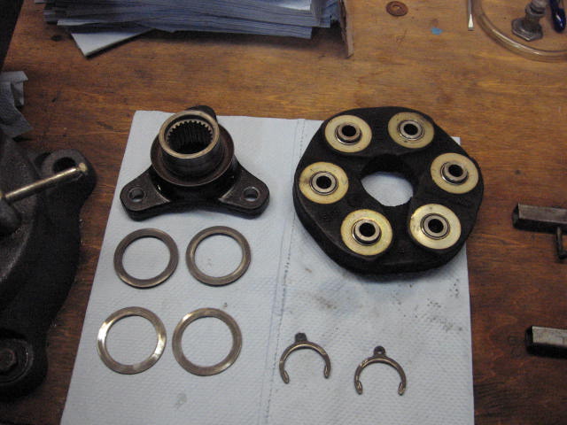

03-19-2014, 06:20 AM #76
Thank you Gents for the information and assistance along the way !
OK, the ol'e girl is home. Found my new German flex disk (front one is almost new, replaced when I did the drivetrain install). Found a nice, correct yoke, and 2 sets of shims, one set is .90 and .95 and others are 2.60. The reason I need an assortment of shims is that once I start the swap, I am 100% committed and I need to get the car completed while I have access to a car lift.
Off to the machine shop for a complete cleaning and off to the drive shaft place to get my mod'd driveshaft balanced.
I found the part # for the "C" clips and they really do cost about the same as a small bag of chips, i.e., .50 cents a piece.
I should have everything in place so that by next weekend, I will have my 2:65 installed. BTW -- yoke is held in place with the really funky four prong nut versus the 30mm funky nut, so need to grind down a socket for that operation ...lol
I will take a bunch of pictures of the install so I can share my trials and tribulations with the swap for anyone going the same route.
Again, thanks !

03-19-2014, 08:58 AM #79
No arsholes ... lol
Well, a bunch of reasons:
1. I already have the flexdisk. Don't want to buy a different one (or a set).
2. I already have the correct yoke for the swap
3. I already ordered and paid for the correct 30mm funky nut as well as some other odds and ends
4. I already own a mod's driveshaft which has grease fittings which is designed specifically for the W123
5. I have to swap out the front part of the drive shaft anyways (shorter section) since the dipshit prior owner hacksawd off the front of the driveshaft about 2" and jammed it into the center bearing (remember, I have the 5 speed which requires an odd front drive shaft section). Instead of getting the correct driveshaft section for the 5 speed, I got a pretty shitty butcher job from the prior owner.
6. Welding the larger yoke will take a bunch of time finding someone in my area capable -- or shipping the driveshaft off to California or Missouri or someother place which has an good reputation
7. The time to swap out the yoke is probably going to be about 5 minutes or less versus the above which strikes me as a time bandit and will probably cost more than the entire LSD project in its entirety.
And, not sure what "real" benefits I would gain by a larger yoke and a larger flex disk. I highly doubt that the torque created by my mod'd engine will snap that yoke or snap the flex disk.
HOWEVER, if you got a good reason to override the above, PLEASE let me know since this is the time to do it (or not).
So, fire away ...

03-19-2014, 09:06 AM #80
(03-19-2014, 08:58 AM)Greazzer No arsholes ... lol
So, fire away ...
No real point in doing so, just that changing the yoke/flange can be somewhat difficult to get done properly...
and, incase you ever stumble upon another v8 LSD, say a 3.27LSD a 2.82LSD or a 2.24, it will be a direct fit.
my future rebuilds i will get the larger flange on the driveshaft right away, and thus, will be able to switch differential however i want, straight when i get it Tongue + the tad sturdier flexdisc...
not that important thou Smile go for what you already planed Tongue

03-19-2014, 09:20 AM #81
OK, dumb question ...
Assuming I won't be doing any swaps since LSDs are pretty tough to find and this is probably my first and last swap. DeliveryValve was 100% correct on their scarcity and but for my STD-Luck in finding one and finding one inexpensively, please tell me the benefits of the larger yoke and larger flex disk.

03-19-2014, 02:49 PM #82
(03-19-2014, 06:20 AM)Greazzer ....i BTW -- yoke is held in place with the really funky four prong nut versus the 30mm funky nut, so need to grind down a socket for that operation ...lol
Get a chisel and a hammer, and tap away.... This according to PP's whunter.
As a tool junky, I have the correct tool, so I have not tried that method.

The "rebuild" begins. Got it back, and it's surgically clean right now.
I will try to chisel out the seals this evening. Machinist indicated they started tearing apart while trying to remove, so I will tinker with it tonight.
03-20-2014, 11:46 AM #88

Made it to this point:
1. It's as clean as it's going to get;
2. The axle seals are out. Not a biggie once I tapped on them with a screw driver and collasped them, rather easy;
3. No dice on chiseling out the 4 prong nut that holds the yoke, plus Delivery Valve got me on the rotational torque bandwagon now. I got my torque wrench which goes down to 5 foot pounds, and there's no way it's even close. So, looking for an accurate INCH pounds torque wrench;
4. Getting loaner 4-pin wrench socket;
5. All seals and parts to be delivered on Monday; and
6. Differential Manual in hand compliments of W116.org
What was thought to be a simple swap / project has turned into a decent sized project. Now, contemplating re-doing my axles since I am taking the car's rear end apart and swaping out the driveshaft. So, maybe this weekend I will score some of those 2-part axles ... hmmm

Personally think you're opening a whole can of worms changing the input spider. That crush washer referred to sets the interference distance between the pinion and crownwheel and is critical for quiet operation (never mind wear). Messing with it might just ruin an expensive diff. Safer option would be to mod the shaft to suit the existing spider as has been suggested.
By '2 part axles' do you mean like this?
[Image: 11.jpg]
Instead of this...
[Image: 107diff005.jpg]
If so you will need to do this...
[Image: 24-5001.jpg]
[Image: 10.jpg]
to make them fit because the bolt heads foul the flanges.
