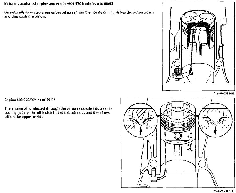

gsxr
Gone to the M119 dark side
103
04-02-2010, 09:48 PM #65
I thought the NA606 motor had the oil squirters for the pistons, same as the turbo 606, and that the NA606 would tolerate a mild turbo treatment...?
Also, the NA and turbo OM60x have the same compression ratio. The turbo engine does NOT have a lower ratio. The OM606.962 has a 22.0:1 compression ratio, exactly the same as the OM606.910
The Finns have been pushing the 603 turbo to 450hp with stock internals and no blown pistons. I'm not sure what that mechanic was talking about. I wouldn't worry much about pushing a NA603 to a measly 147hp, but I don't think I'd go past that. Better to get a proper turbo engine to start with.

Tymbrymi
Klatta Klatta
185
04-05-2010, 01:05 PM #66
(04-02-2010, 09:48 PM)gsxr I thought the NA606 motor had the oil squirters for the pistons, same as the turbo 606, and that the NA606 would tolerate a mild turbo treatment...?
The NA606 has oil squirters, but it doesn't have an oil galley in the piston like the turbo's do.
