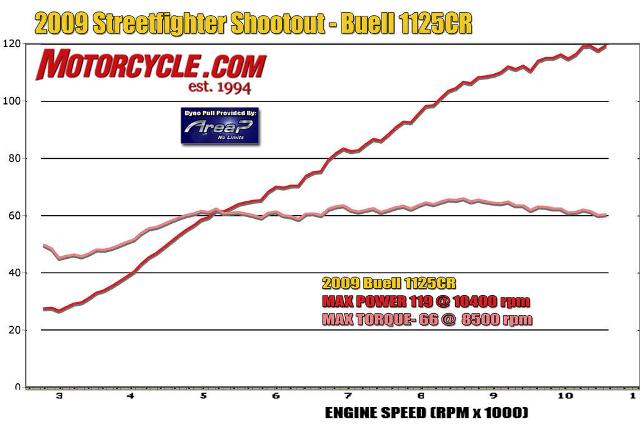

Technically yes but at that rpm the poor gsxr isn't making much at all ... haha not that it ever did Tongue
(12-07-2010, 10:24 AM)ForcedInduction Horsepower is nothing more than math for torque over time.
The GSXR is faster on the high end because it makes its power in the 11krpm range while the Buell is mid-9krpm peak power. Its the same way a 3.0L car engine makes only (for example) 200hp yet a 3.0L F1 makes over 900hp and a 1.3L Geo makes 80hp while a 1.3L RX-7 makes 145hp. RPM. Ditto with many Finns revving their engines over 6000rpm to make inflated power numbers.
Yeah GSXRs only make power over 10k, under that they are useless. The Buell is just a torque monster with a flat line of beauty
If I could revv my Buell to 18k i'd make all kinds of ponies!

12-11-2010, 09:54 AM #121
(12-07-2010, 02:06 PM)Captain America If I could revv my Buell to 18k i'd make all kinds of ponies!
And a dyno graph further emphasizes the point about horsepower's math-only base, EVERY engine has exactly the same horsepower and torque at 5252rpm!
Quote:Why gasoline engines rev higher? What is the broplem if diesel make power high rpm?
What is the problem our engines because they give maxs power at 6000rpm?
Geezer got it correct; Flame front velocity, g@soline burns much faster.
At 6000rpm your piston velocity is only 16.8Meters/second, yet a stock small block Chevy has 17.7MPS@6000rpm (and goes to 23.6MPS in modified 8000rpm SBC engines).
So Jemmu, why cant your superturbo's pistons move as fast as a stock 'merican pushrod all-iron antique?
Quote:I vote duel charge VGT off the line and switch to Holdset at the top of the of the power band and you can have the best of both worlds!

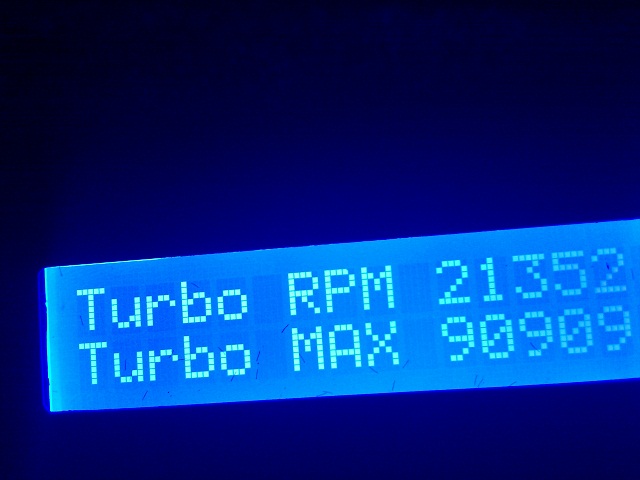

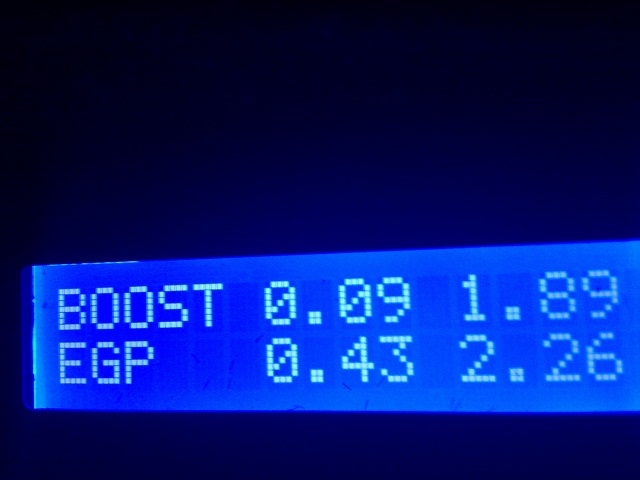

01-03-2011, 02:05 PM #129
Just got my homemade Boost / Turbo RPM meter to Work.
It is an Audrinoboard + a cheap LCD screen.
OM606, HE351VE, myna 7mm, 3",
I wonder that i can make 1.9 Bar Boost almost 30 PSI at 5000 RPM, at only 90,000 TURBO RPM, What is max RPM on this turbo. ?
If i rev the engine to 6000 RPM i need around 110,000 Rigth.

01-03-2011, 04:53 PM #130
90k is the service limit, should be fine to 120k though.

01-04-2011, 12:08 PM #131
(01-03-2011, 04:53 PM)ForcedInduction 90k is the service limit, should be fine to 120k though.
Thanks OK it seams i am far from the limits on this Turbo. and dont even have a external wastegate.

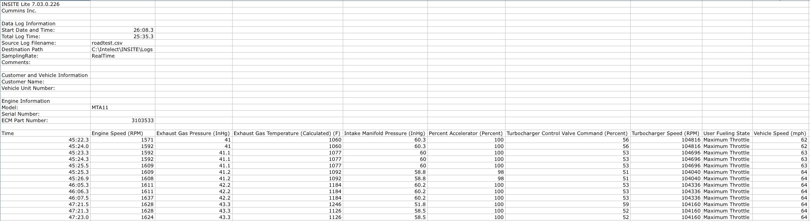

01-04-2011, 04:00 PM #132
Yep, even the larger 451 turbos are spun up to 100k rpm stock.
Here is a capture from a road test with one.
See even stock the turbo has a EMP:boost ratio better than 1:1! (21psi:29psi)

01-05-2011, 01:55 PM #133
UPS maby there is a software issue it seams to max out on 90909 RPM every time.
I will try to find the Error, so maby it spins faster ?
Get back when i find out.
1996 MB SL320 Now OM606 7 mm pump elements (myna), KKD manifold, HE341VE, 3,5" downpipe, 3" exhaust, big IC, 722.6 gearbox controller, also controls (Turbo VNT, EGT, BOOST, EGP.)
olefejer

Im pretty interested in your RPM gauge. Are you using the stock HE351VE shaft speed sensor?

01-23-2011, 11:14 AM #135
(01-23-2011, 10:59 AM)Aero83
(01-05-2011, 01:55 PM)olefejer UPS maby there is a software issue it seams to max out on 90909 RPM every time.
Yes it is the stock sensor, 2 wire the one wire to ground on the arduino board.
And the other wire directly to an digital pin.
And then counting emery time the pin go high
And it is working i have had it to 103,000 RPM now. motor at 5200 RPM Boost 1.9 Bar

I haven't worked with an arduino yet. Does the digital pin have an internal pullup or does it require one?
Do you know what kind of sensor it actually is?

01-23-2011, 11:27 AM #137
(01-23-2011, 11:17 AM)Aero83
(01-23-2011, 11:14 AM)olefejer
(01-23-2011, 10:59 AM)Aero83 Im pretty interested in your RPM gauge. Are you using the stock HE351VE shaft speed sensor?
Yes the arduino has internal pullup.
Iam pretty shure it is an inductive one, so only metal has to go by it. and the magnet is in the sensor. i actually just connected it and was quite chocked it worked :-)
You can see the code here.
http://pastebin.com/VtDinRrp

01-23-2011, 12:05 PM #138
Its just a hall effect sensor like used on the crankshaft pin. The turbo shaft has a flat on it which breaks the signal. Some turbos do the same except they use the compressor wheel's blades instead (My HE341Ve used this).

01-23-2011, 02:30 PM #139
(01-23-2011, 12:05 PM)ForcedInduction Its just a hall effect sensor like used on the crankshaft pin. The turbo shaft has a flat on it which breaks the signal. Some turbos do the same except they use the compressor wheel's blades instead (My HE341Ve used this).
I just pulled the sensor out of my spare turbo and you can see the flat on the shaft through the hole.
Someone had told me there wasn't anything on the shaft. Rolleyes

01-23-2011, 02:49 PM #140
Nope. It's a VR sensor, since it produces AC voltage.

01-23-2011, 10:37 PM #141
Better be careful, at 100Krpm, you could be generating some pretty high voltage spikes from a VR sensor.
The clamping diodes in the AVR on the arduino board might handle it for a bit, but you really should look into a preconditioning circuit. I know the megasquirt guys use them for their vr sensor inputs, not much to them.

01-24-2011, 01:51 AM #142
I was having issues with my vr signal doing that with megasquirt on my Volvo. It would do weird stuff around 9000rpm. I changed a few things in the conditioning circuit and it cleaned it up.
