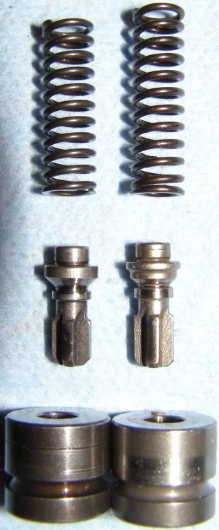

tomnik
587
12-06-2008, 03:09 AM #104
GREASY_BEAST But the question remains: Why does removing the collar from the delivery valve mean more fuel goes in? Is it just due to secondary injections or is it actually more volume per injection?
And: Why does increasing the injector hole size yield more power?
I'll try again:
it is the collar getting out the bore when the DV moves upwards that opens the way for the fuel towards the injector. No collar and you have a sudden start of flow (just when the increasing pressure of the element lifts the cone).
At the end of injection the damping effect is missing and here you also have a sudden shut down of the flow. Here I am not sure about what happens exactly. The risk of a pressure wave is higher and cause a second injection, depending on pop pressure and if there is a restriction orifice above the DV.
nozzle:
in general I would say it is the duration of injection that is just shorter. Only this might got provide more power but you simply have more time to inject more fuel. That is the original reason on stock engines with better nozzles: decreasing the duration of injection (the same amount of fuel is injected but within a shorter time will increase the efficiency=better mileage and lower emission).
I will collect different DVs for comparison. 616, 617a and 606 and my new custom made one to see the evolution.
How can I upload a xls file?
Tom

tomnik
587
12-07-2008, 04:28 AM #106
<!-- m --><a class="postlink" href="http://www.freepatentsonline.com/EP0061534.html">http://www.freepatentsonline.com/EP0061534.html</a><!-- m -->
(not our DV but the principle is the same)
out of this I read that there is a gap between collar and DV cylinder that has also influence on damping. The smaller the gap the smaller the lost volume, but then tends to bounce back (depending on pop pressure).
collar width and location: smaller and the more towards the cone = earlier delivery
collar diameter: smaller =more damping (safer regarding double injection) but more back flow
no collar: max. earliest delivery, but higher risk of double injection (more fuel flowing in the line) and there is absolutely no damping= double injection.
This is just regarding the collar. Weight of DV, spring, pop pressure and line length (time for the reflection wave to arrive at the then closing DV) are not included.
Tom

lightly modded OM606
211
01-17-2009, 03:31 AM #117
Last insight for me on the cut DV:
It is simply the addition of volume from lost metal in the plunger cavity. This explains the overfueling and smoke at low throttle, whereas upper percentages of throttle seem normal.
the ratio of added fuel to stock fuel supply approaches 0:1 as throttle increases.
low throttle ratio of added fuel to stock could be 1:1
expecting the fuel delivery components to accurately 'add' volume due to expansion (especially after 25 years) completely negates the purpose of the $100,000 machine Forced has presented to the equation.
This post was last modified: 01-18-2009, 07:54 PM by totaldisaster.

09-04-2009, 12:59 AM #124
Here are the DV's from the 617 and 606a M-Pumps.
The numbers are 102-201 and 102-210.
The 617 DV holder is marked 0.030, the 606a 0.024
This post was last modified: 09-04-2009, 01:01 AM by ForcedInduction.

09-04-2009, 08:48 AM #128
I am of the opinion that modifying the DV is a false economy. In the picture is om617 on the left?
09-04-2009, 01:03 PM #129
(09-04-2009, 08:48 AM)winmutt In the picture is om617 on the left?
Yes.
Yes.
09-04-2009, 03:23 PM #130
IIRC then it looks like it has a greater volume than the om60x one. Odd that.
09-04-2009, 04:09 PM #131
(09-04-2009, 03:23 PM)winmutt IIRC then it looks like it has a greater volume than the om60x one. Odd that.
that would make sense as they have the same displacement, no?
09-04-2009, 04:26 PM #132
(09-04-2009, 04:09 PM)SurfRodder that would make sense as they have the same displacement, no?
Per cylinder the 617 has more air volume, but the 606a pumps nearly 2x the fuel per cylinder.
09-04-2009, 05:47 PM #133
(09-04-2009, 04:26 PM)ForcedInduction Per cylinder the 617 has more air volume, but the 606a pumps nearly 2x the fuel per cylinder.
wow, I didnt know that... makes me wanna build up a 606 even more!
09-04-2009, 09:48 PM #134
(09-04-2009, 05:47 PM)SurfRodder wow, I didnt know that... makes me wanna build up a 606 even more!
Don't forget that I'm talking about the non-turbo 617. 88hp vs 178hp.
This post was last modified: 09-04-2009, 09:49 PM by ForcedInduction.
