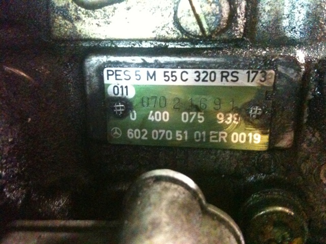

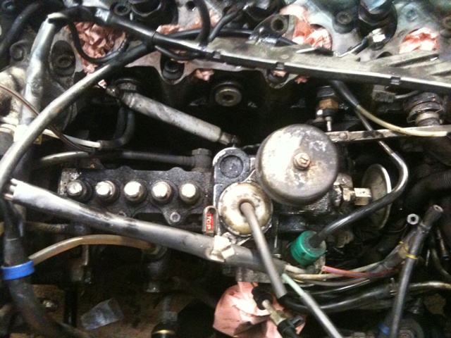

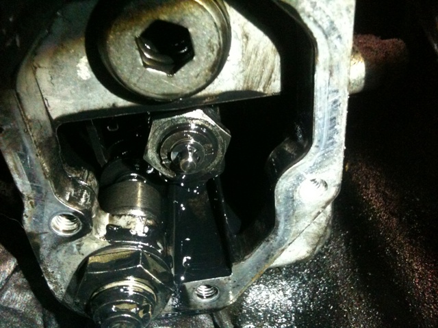

03-29-2011, 06:22 AM #136
Hi there!
Can someone help me to point out where to do what on my pump?
I cant find any picture on this forum thats exactly the same as mine so im just sending you some!
There are some thats similar but i wanna be sure on this before messing with the pump!
Thanks!
/Degen

03-29-2011, 11:43 AM #137
The 10mm allen at the top of the first photo is the high-idle setting. 1 turn clockwise/tighter is approximately 150rpm increase.
