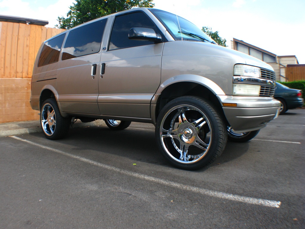

A set of oversized Twenties will take care of that wheelwell space.
But seriously, looking good!
