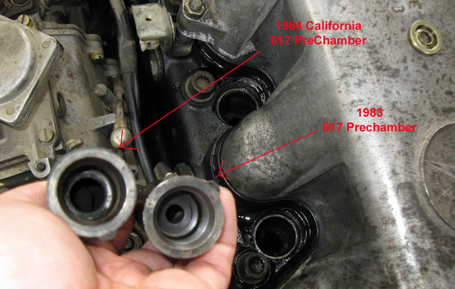

(01-29-2011, 09:11 AM)ForcedInduction [quote='yankneck696' pid='23822' dateline='1296308579']Also, Hercules stated that on an otherwise stock engine, that chamfering the holes on the outside benefitted.
A bell-mouth form will improve flow efficiency into any tube, its simply not cost-effective for a manufacturer to do that on a large scale production. Increasing flow efficiency is a good thing, increasing flow volume isn't (in this case).
Holy Shi-at. Am I reading that FI is moving from the hardline stance and states a certain modification of a pre-chamber will be a benefit!?
(01-30-2011, 05:28 AM)Hercules What prechamber best to mod. (my opinion )1984Ca.or 1985Ca.and Fed. My reasoning,this information from 1984 Mbz new modler year book. Title: prechamber,to reduce smoke emissions at partial load, the prechamber has been modified as follows:
Nozzle seat 1 mm deeper
Bore in upper half enlarged from 8 mm to 14 mm
Production phase-in:
California version at start of model year.
Will be gradually phased-in on Fed.version engines. Pertaining to 617.95 engine
Have cleaned,reset,or ( rebuilt) hundreds of Mbz nozzles,these gave the least amount of troubles.
Also set pressures at 950lbs +0- best performance,smoke levels.
Interesting that you posted this. I always wondered what were the differences when I first saw it. It has a distinctive "open" neck. As opposed to the previous "collared" neck.
Here is a shot of a couple of pre-chambers one from a model year 1984 Cali 617 and the other from a Model year 1983 617 motor. Same number 617/03 stamped on both.
This post was last modified: 01-30-2011, 04:55 PM by DeliveryValve.
01-30-2011, 04:41 PM #119
(01-23-2011, 11:11 AM)ForcedInduction
(01-22-2011, 05:52 PM)DeliveryValve ...
Quote:My understanding is the stock Prechambers are just fine for higher HP output and any modification would hinder and not improve performance.
They are, you're correct.

01-30-2011, 09:31 PM #120
AH!!! i heart pictures.. thank you
I have smoke on the top end as well but not nearly as much when im down around 10-15 psi or below.
The larger diameter is to reduce carbon buildup between the injector heat shield and PC which affects long-term emissions. It has no effect on performance.

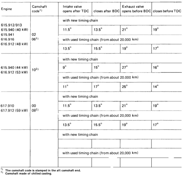

"Thats only because your non-turbo camshaft has valve overlap. Its allowing exhaust to be pushed back into the cylinder"
Sad.. seriously though how much overlap could the cam in these have? anyone have any cam degree info?

Quote:Sad.. seriously though how much overlap could the cam in these have? anyone have any cam degree info?

Leave it to the germans to complicate a cam card... either i am having trouble going from charts with only tdc values or the 616 has zero valve overlap. exhaust closes 14 degrees before and intake opens 11 after so that would be negative 25 degrees of overlap? basically?

01-31-2011, 08:04 AM #128
I don't have any 61X engines(only 606) so I can't take measurements, but if that cam card is correct, It is easy to see where you can gain power from a 61X.
Maybe Forced can teach us amateurs how to read his cam card?Smile
erling66

(01-31-2011, 02:10 AM)ForcedInduction Holy crap, don't quote an entire friggin post!
(01-31-2011, 01:36 AM)Hercules Most often reason for replacing pre 84 injector( overheating),sunken distorted injector tip end,and or pintle bluing(overheating)distortion again,sticking causing poor spray pattern.Cause,Heat transfer to tip from seal being to close to pintle end.
Using the correct (small opening) crush seal solves that.
Quote:After the changes in prechamber and seal, these conditions were seldom if ever seen again.
How was it never seen again when it didn't happen to start with? The 100,000 617a's made from 79-84 have managed to survive very well without any need for retrofit.
Was not a matter of survival,but of reducing smoke emissions.
Mbz thought it enough problem to make the change,But what do they know any way??
Hercules
01-31-2011, 02:53 PM #129

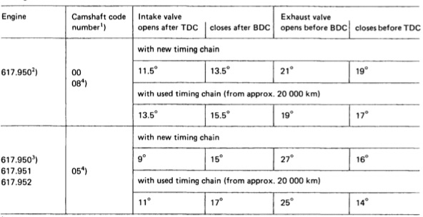

02-04-2011, 08:19 PM #143
Came accros this today
OM616

02-05-2011, 01:50 AM #144
Hard to read those, care to repost a larger version?
300D50

Quote:Came accros this today
The precup design has little in common with Mercedes' design.

(02-05-2011, 01:50 AM)300D50 Hard to read those, care to repost a larger version?
Tried, I can't attach a larger file. Magnifying glass perhaps? It doesn’t have any information in the text anyway. It is just another Prechamber design to ponder.
