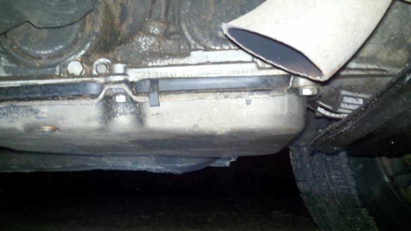

01-31-2012, 11:29 PM #119
(01-31-2012, 09:03 PM)Serial Crusher If you have an open downpipe and any kind of aftermarket air filter you really need to keep up on filter maintenance. Idling it will dry out a cotton gauze filter in no time. Something to watch out for.
Thats one reason why dry filters are far superior.
(01-31-2012, 02:59 PM)capflya You sealed the deal... it's comin' off! Turn-down or not... It's getting removed lol
I would bet a turn down faced off to the side might help with any in-car noise. But then again my stereo will help with that anyways haha
This is what mine looks like to give everyone an idea
(01-31-2012, 03:44 PM)sassparilla_kid I think I should just dump the exhaust out behind the passenger side front wheel, that way when I get a big fancy pump I can smoke out anybody to the right of me lolol
People at the bus stop dont particularly care for me exhaust.... haha It's not even pointed in their direction and I can still leave em in a cloud
This post was last modified: 01-31-2012, 11:35 PM by Captain America.

04-02-2012, 10:31 PM #131
Since I'm on spring break this week, I plan on getting as much stuff done on the car as I can.
So far I have straight piped the exhaust, it could use with an ALDA adjustment, lots of smoke when I press the accelerator in neutral. Hopefully it spools up nice. Also need to get a tip that's turned down, so I won't be go-go-gadget smoke-screening/deafening any officers of the law
04-03-2012, 02:47 PM #132
(04-02-2012, 10:31 PM)sassparilla_kid Also need to get a tip that's turned down, so I won't be go-go-gadget smoke-screening/deafening any officers of the law
My exhaust is proly 3-3.5" down pipe back. The last 2 feet or so has this chrome trucker stack welded on. Pack o' smokes is 3.5" So i think I smoke screen out about a 4.5-5" pipe. Just don't press hard on the pedal when the fuzz are behind you. Angel
My vanity plates coming say "SOOT" hopefully this does not increase my chances for pull over. (I know it does)
04-03-2012, 03:04 PM #133
(04-03-2012, 02:47 PM)lgreeley83
I agree no fast take-offs when around the fuzz. And those vanity plates are gonna be awesome!! I just cut out the mufflers and welded in some 2.5" pipe in their place, so not as big as yours but it still spools much quicker now! I'll try to get a video of the exhaust in a little while, I need to have breakfast first and take a shower and all that stuff

04-03-2012, 03:08 PM #134
[/quote]
[/quote]
Mine is unnecessarily big, but it was there when I bought it. SOOT BAZOOKA!
