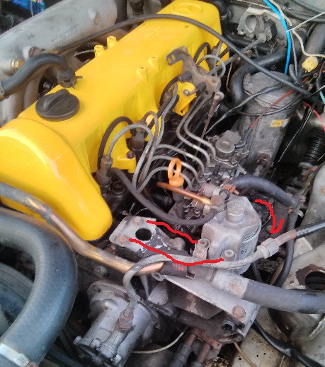

(08-08-2013, 12:48 PM)Simpler=Better Roll cage and 6pt harness installed?
lol my seat it about to fall through the rusted floor. No passenger seat belt....
Reading that is the rack damper bolt in the other picture. I guess i gotta read to know if I can remove that temporarily.

You can clear the rack damper bolt. Just take the shutoff valve off before trying to pull the IP.
If you need to run without the rack damper you can, just plug the hole with something and expect a rough idle.

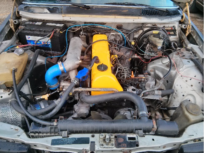

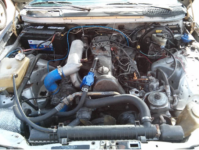

Before recent mods (M pump, valve cover yellow, no power steering)
After
Painted headlight bezels clear corners
Thinking of trying to move fuel filter mount, i wonder how a vehicle stock with no power steering mounted the fuel filter with no need for a power steering bracket. The bolts seems the same distance apart however, i haven't measured yet. Ill get around to it.
When i pull side trim I also ditched the 300d and Turbo diesel badges. Debating whether or not to lose the merc symbol too. I may cut the outer ring off.
and no i didn't black out the tail light, its just covered in soot.
Yellow valve cover because I asked my wife what color it should be and she said yellow. Anything to keep her partially interested in the ride.
Oh yeah side note... I finally got all my doors to lock today. I had an unlocked car for two years. I never left anything in it. In doing that I gutted every vacuum lined for the locks, trunk, and fuel door.
In doing that I got a look at what I've been in denial about for a while, rust in my floor. I knew it was getting worse because my seat is sagging more these days. That under body rubber is a good hiding trick. I post pics later on it, the one I took today came out like crap.
Also... More about pump, I still haven't measured chain stretch or can timing. I know "wtf idiot!" I assume my can timing is off. Before pump swap I think my pump may have had retarded timing. I always had great smoke. No coolant loss. Now with advanced pump I smoke black at the lightest touch of the pedal. Yeah I've got more fuel but I doubt it should be that bad when lightly touching pedal. Also idle smoke is less than before almost none. Still playing with fuel. Trying to find max sweet spot so I can floor it on the highway without melting things.the garret 60 trim characteristics seem to be similar to before. Boost to 18psi is quick but I don't think I am going to destroy the turbo. Than again I have no clue of what I'm doing lol.

[undefined=undefined]Your fuel filter can move to the bracket holes, that's how mine is setup. You will need new clear lines though (tygon/fuel-rated nylon/etc.)[/undefined]
I left my power steering bracket on too when I went to manual steering as it has a bolt for the dip stick and holds the vac line with the fuel filter mount. Figured why reinvent the wheel, the whole piece isnt that heavy, and I won't have to figure out how to support these two items if I left it in.
How are those done on yours? how are you supporting them, can you show a pic?

It's all in my build thread, I was also playing with putting an AC compressor where the PS was. Read my damn build thread it's full of nifty tricks!
I added the photos to my first post
I have the vac pump removed on my engine, but I imagine the bracket can be relocated. The dipstick and fuel filter don't have the perfect spacing by accident Smile

Question: those clear fuel lines, how important is it to use that clear plastic stuff?
Simple-> thanks for the pic. I remember reading a while back your build. I figured it would go.

(08-13-2013, 08:50 AM)lgreeley83 Question: those clear fuel lines, how important is it to use that clear plastic stuff?
not important at all. Actually, whats really cool is if you pull the line off and cut the line off the banjo fittings exposing the hose barbs, 5/16 rubber hose fits perfectly. All you need is a hose rated for the pressure, which is low, and some band style high pressure hose clamps.
I think the max pressure is 20-25psi, so look for some 50psi rated fuel hose, available in almost any parts store. should be printed on the side.
I have all 5/16 rubber hose in my van on the pressure side of the injection pump because I relocated the fuel filter
