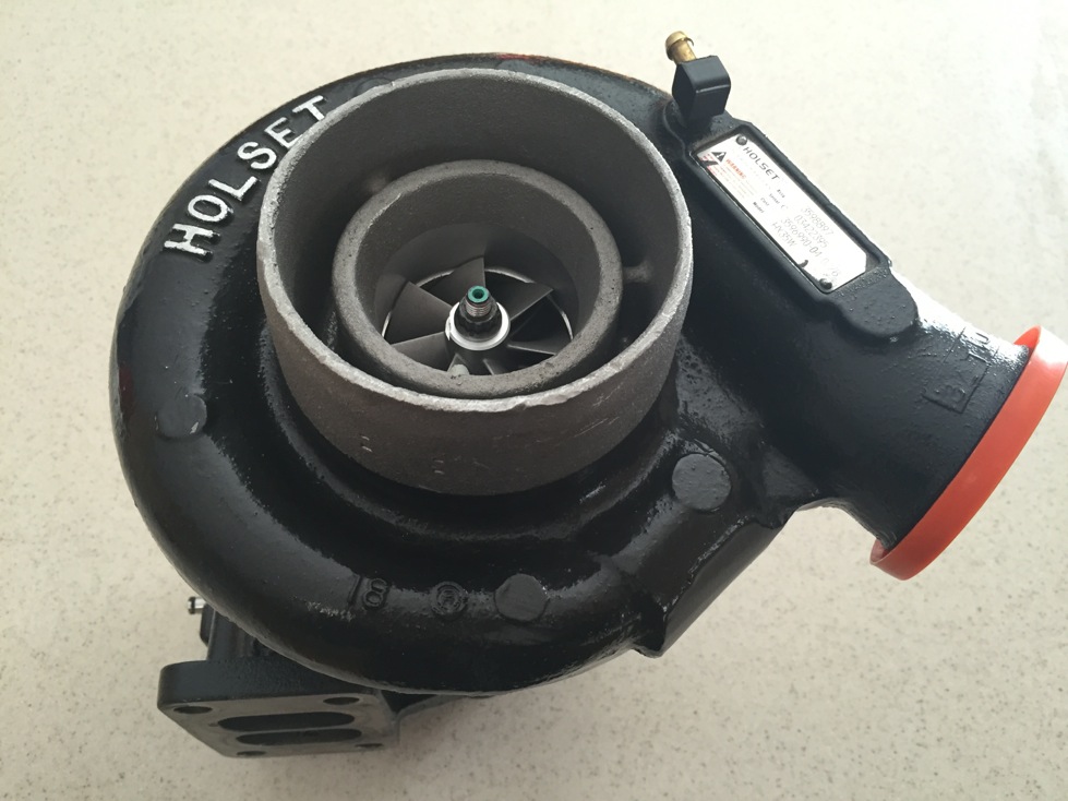

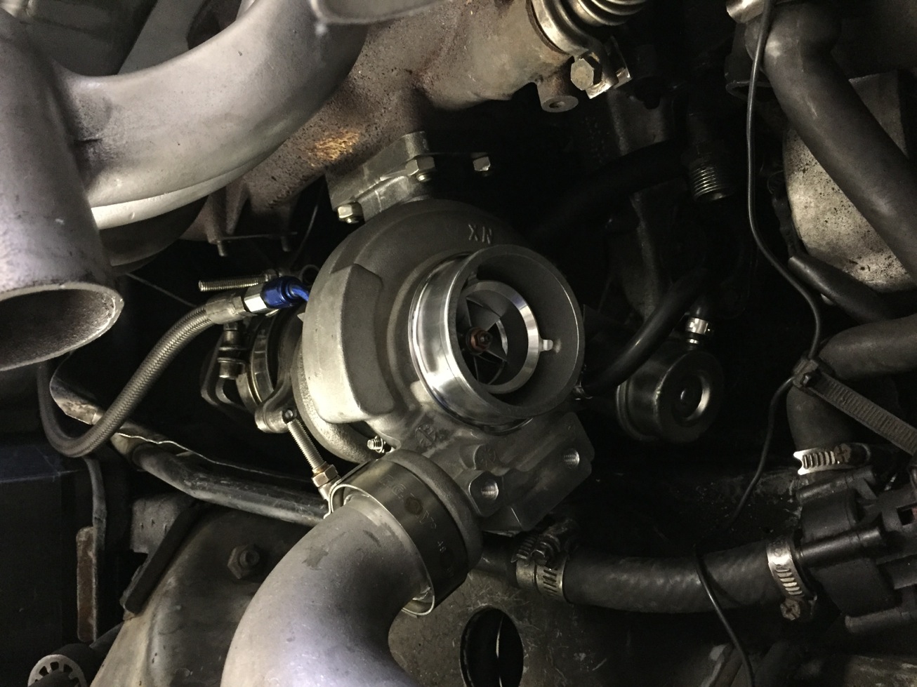

02-02-2015, 12:23 PM #109
Mike - I will post results of the clutch for sure, nobody has any information or review of an HD clutch for a 617 that I can find. Ill be trying a Spec stage 3. I was going to try clutchnet but decided against it after reading multiple bad reviews about their service.
Got the HE221 installed.
Unfortunately its February in Cleveland, and theres over a foot of snow. Have to wait till spring.

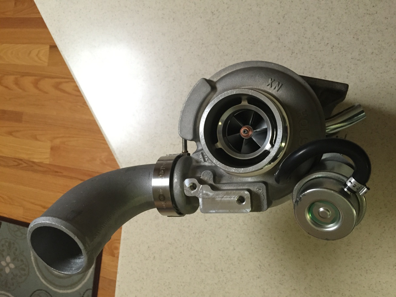

02-02-2015, 04:28 PM #111
(02-02-2015, 03:22 PM)mike-81-240d So does this mean your old Holset is for sale?
Not yet. I want to see how this turbo works out before I get rid of the HE341.
My reasons for trying the HE221:
Looking to move the power down a little lower in the rpm range. I'm also looking for a more "driveable" experience. The 341 is a fun turbo that I know will flow all the air I could ever use, at least until I start bending rods. However it spools HARD.
For example, turn a corner, shift into second and give ~60% throttle. Go from 5psi to 22psi in the matter of a few hundred rpm, breaks back tires loose and/or makes clutch slip.
I think a more linear boost curve will make the power transfer to the ground a little more linear. If that makes sense.
My 6mm pump as it sits now should be 100cc (turned up a little since I first got it, dieselmeken said it would be very easy to get 100cc from it) which is enough for around 250hp at the crank. The HE221 should be well sized for that power, I've seen dyno proof of 285hp at the wheels with one.

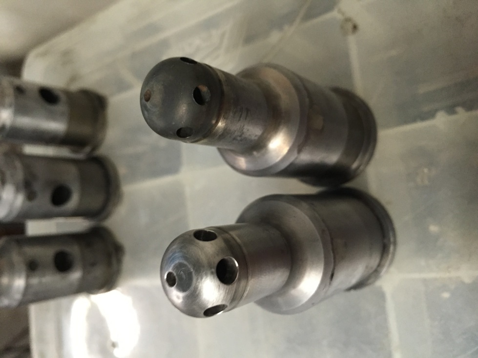

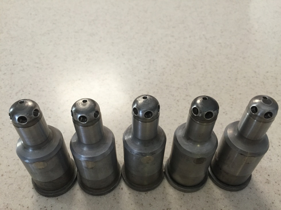

02-20-2015, 06:26 PM #112
So I stopped at the shop I used to work at and bought the owner lunch, in exchange for a couple hours use of the mill.
Got these installed today. Along with new injectors with 315 nozzles from Greazzer.
Unfortunately it will be a while before I can test them, as it is still winter and my pump is on its way to Sweden.
I know the "laboratory" way to do these things is to change one thing at a time but oh well.
