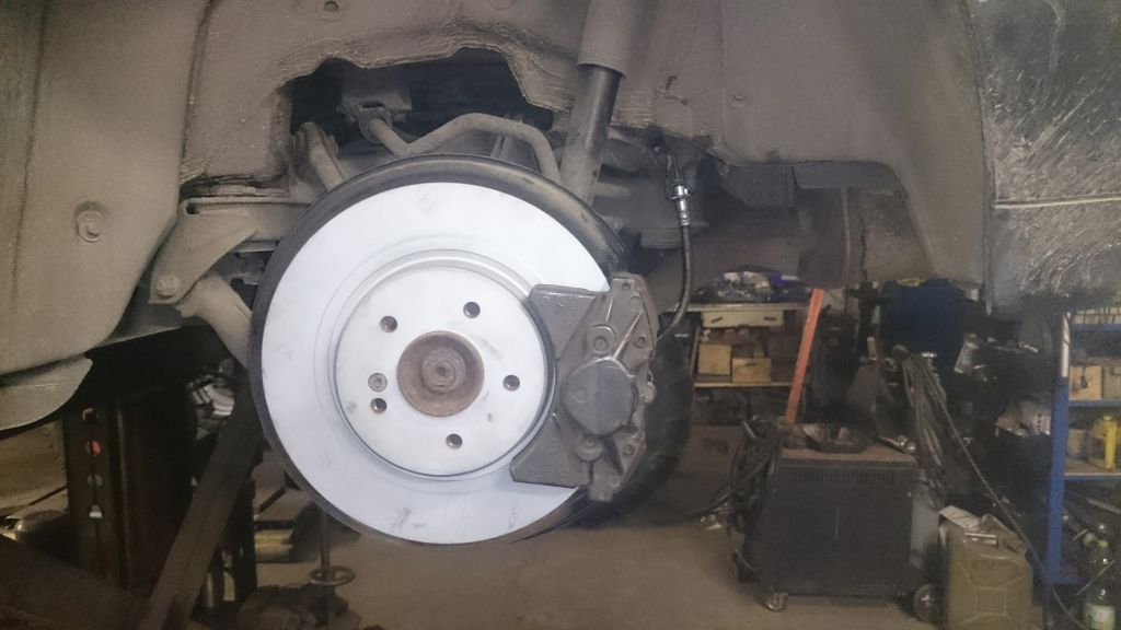

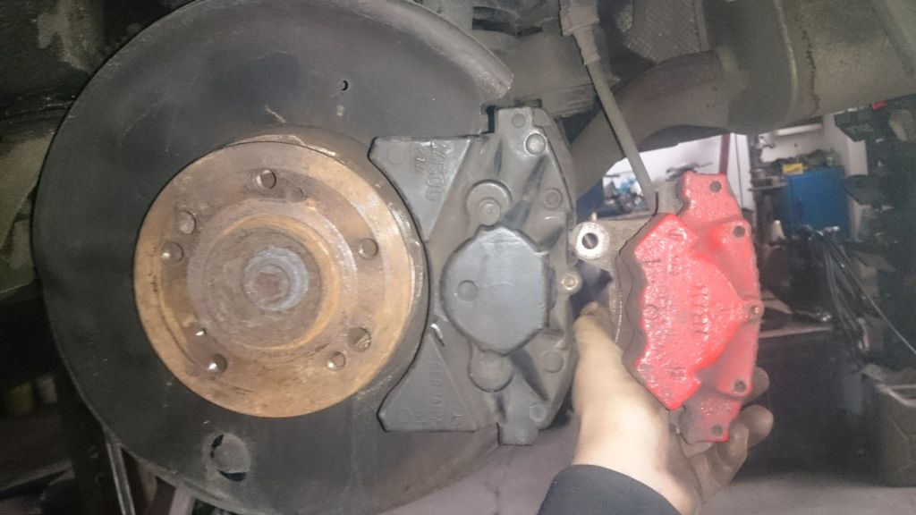

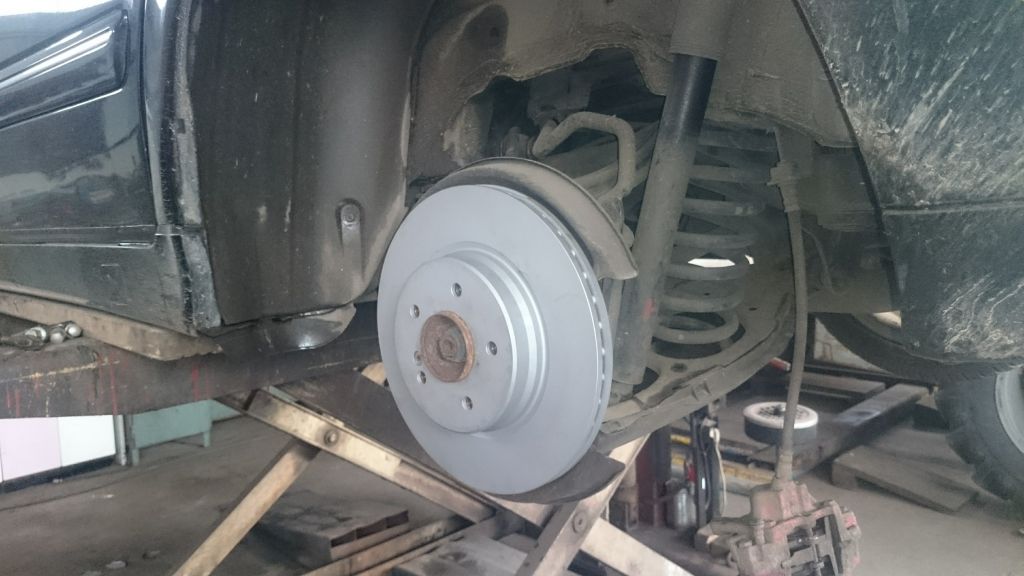

04-06-2016, 05:54 PM #109
Wow, nice numbers - go to dyno Smile
I have to do something with turbo outlet silencer and completely block the EGR. I think there is still air leak somewhere. And after this I will go for remap. Now I am like locomotive. I want at least 250HP/500Nm. I think, It´s possible with these parts.
I installed also new bigger front brakes. 345×30mm discs. Really nice brake power.

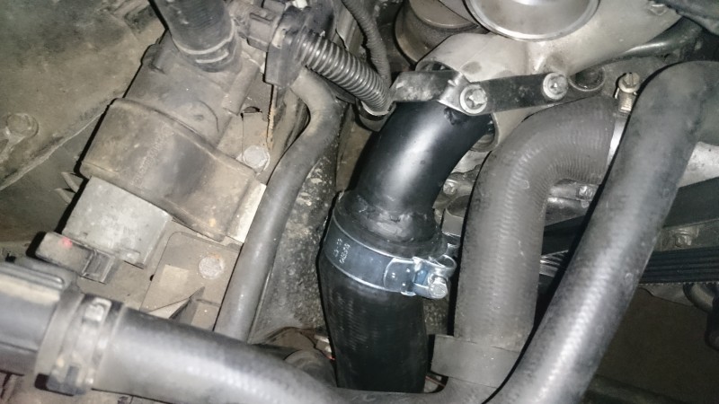

Yes, I did away with that silencer. Well it did have some function to it, now when it boost it makes a lot of noise in IC audiable inside of car. Also mounted 550x230 FMIC right behind the grill (mounted upwards). IAT did not go above 50°C on long WOTs.
starynovy
04-09-2016, 02:55 AM #112

Well I doubt that silencer had any impact on power since its inside diameter is the same that of turbine. I got rid of it because I welded on turbo to acomodate 63mm silicone hose but in your case I would leave it be and do its job. Certainly it will do no harm to power output at 200-230HP. Somewhere I read it makes sense to delete it above 300PS.
starynovy
04-12-2016, 04:10 PM #117

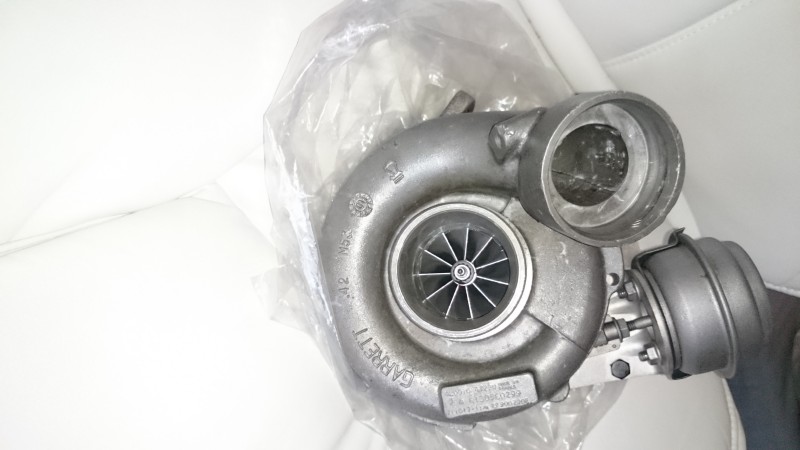

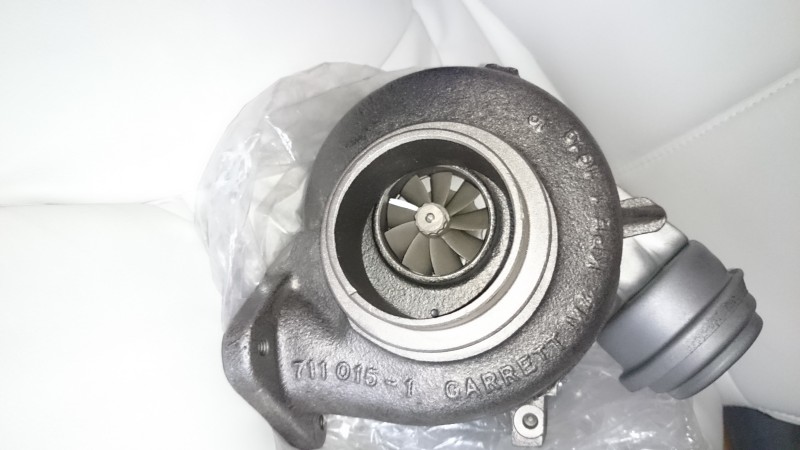

06-03-2016, 01:36 PM #121
GT2364V Ready for madness  Big Grin

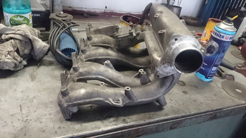

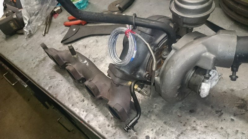

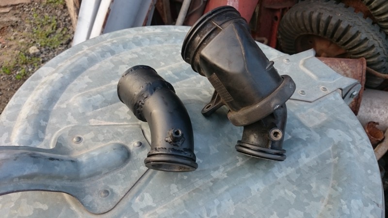

11-19-2016, 07:31 PM #122
HW by me
SW by starynovy
This post was last modified: 11-19-2016, 07:33 PM by MartinB.
W210 E200CDI 185kW Manual, W203 C30 CDI AMG 210kW Manual
MartinB
HW by me
SW by starynovy

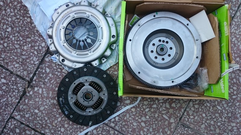

11-21-2016, 04:02 PM #123

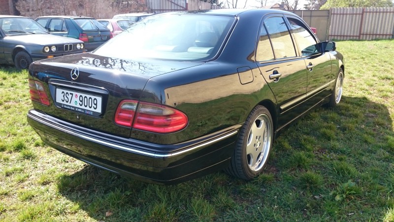

Some pictures..
MartinB
Some pictures..
barrote
1,627
11-21-2016, 11:11 PM #124
is that the famous sprinter DMF conversion kit?

MartinB
OM605 Power
154
11-22-2016, 11:31 AM #125
Yes Smile

barrote
1,627
11-22-2016, 12:09 PM #126
after u install, can u post info about the resonance vibes ? and how it is compared to the original DMF, regarding vibes and noises...
much apreciated, clutches is a hard issue to solve in MB´s , at least for cheap .

MartinB
OM605 Power
154
11-22-2016, 12:16 PM #127
I am driving with it. I sent video with acceleration. Little bit vibration in acceleration in about 3000-3500rpm but nothing horrible. Idling absolutely smooth.
This post was last modified: 11-22-2016, 04:25 PM by MartinB.

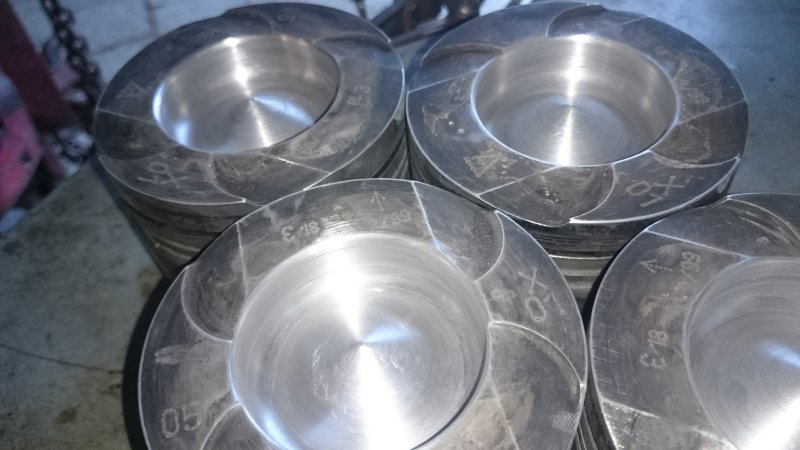

You did eliminate piston bowl lip. For what purposes? Only to lower CR? Or also for bowl shape optimisation? What is CR now?
Rom1
12-03-2016, 01:12 AM #130
MartinB
OM605 Power
154
12-04-2016, 01:37 PM #131
Because of heat stress and lowering CR. Didn´t measured it. Original is 18:1 now about 16.5:1 but i don´t know.

Is it smokes on idle now? Or smoke problems during wot? Because of not re-entrant bow shape, without lip. I want to lower CR on similar engine, but everyone told me that eliminate a lip not good idea because of bad air fuel mixing, not full combustion and smoke. What's your experience with lower CR and "Mexican Hat" bowl design? What about cold start? If you have problems with cold start, you can try to use glow plugs from later OM646 "Evo" engine, it's ceramic.

If is cold it smokes and stinks. But only if is cold. Now here is -7°C and starts perfectly like in summer.

02-05-2017, 08:25 AM #134
Few more pictures and video. Only update is bigger rear brakes. Car behaves still very nicely. Power is ~195kW, RP 1650bar, boost 2.3bar, IQ 120+mm3
Another power increase will be soon.
100-200km/h: 15,6s

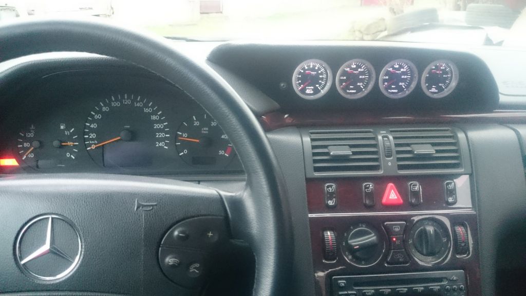

03-22-2017, 01:51 PM #135
New gauges - EGT, Boost, EMP, Oil pressure
EGT is very good. Very long WOT: <800°C
New video

06-16-2017, 03:07 PM #141
This is the one, that I owned previously.
Now there are ~about the same injectors, than in Black smoke racer.
Modded gt23 vnt  garrett, amg turbine + billet compressor.
Clutch from 320 V6 cdi
And 400 000 km.

MartinB
OM605 Power
154
06-16-2017, 03:35 PM #142
That's huge amount of torque. Turbo is GT2564V with 11 blades?
MartinB
tuikku
132
06-17-2017, 01:02 AM #143
(06-16-2017, 03:35 PM)MartinB That's huge amount of torque. Turbo is GT2564V with 11 blades?
Compressor is orig size 6+6, but billet.
I do not like "owersize" compressors in small engines, nothing but harm ...
Boost is 2,8bar - practically no smoke, at all.
This post was last modified: 06-17-2017, 01:02 AM by tuikku.
