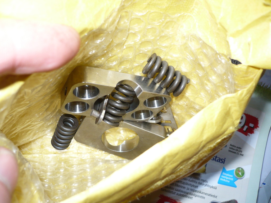

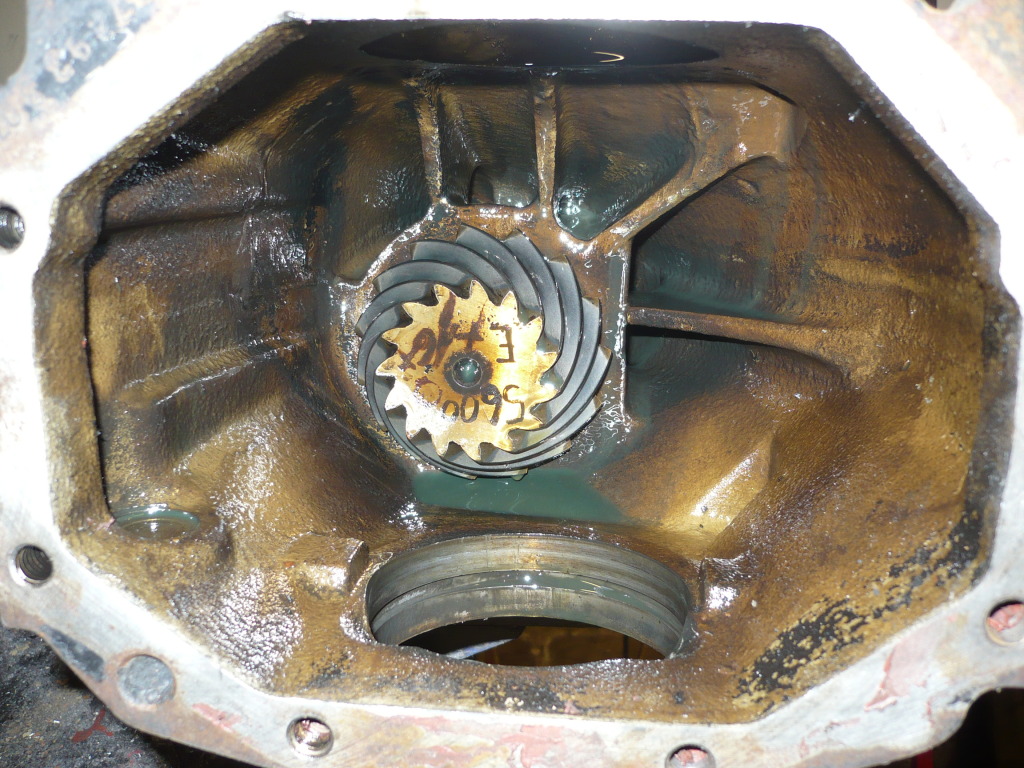

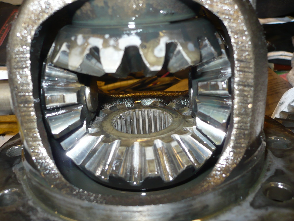

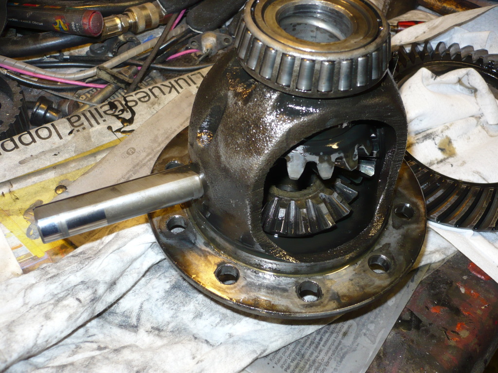

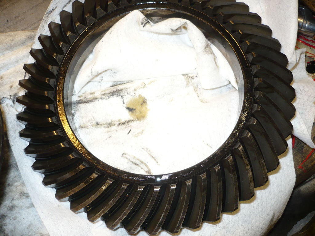

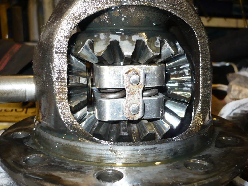

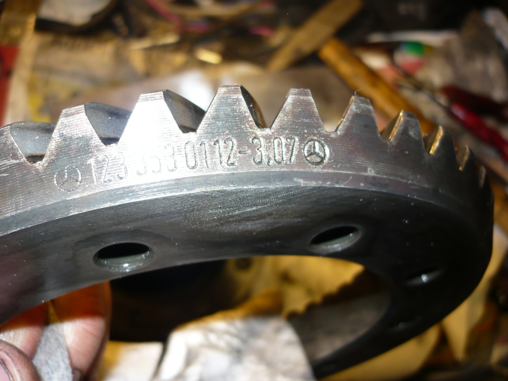

(06-13-2010, 04:56 AM)JTY Some update, I installed a LSD unit in the diff
Few shots of the LSD unit:
[Image: p1040914.jpg]
[Image: p1040928.jpg]
Empty diff case
[Image: p1040932.jpg]
Looks good
[Image: p1040933.jpg]
Middle shaft seems to be in good shape
[Image: p1040934.jpg]
Spiders are pretty bad :roll:
[Image: p1040935.jpg]
LSD unit installed
[Image: p1040937.jpg]
Gear ratio
It's no much more fun to drive and it's very stable when you do an fast launch.
Empty diff case
Looks good
LSD unit installed
Gear ratio

01-09-2013, 10:57 AM #113
(11-25-2012, 12:51 PM)peter
Empty diff case
Looks good
LSD unit installed
Gear ratio
Empty diff case
Looks good
LSD unit installed
Gear ratio

It did'nt hold for long, I needed to change even stiffer springs and after that
I got the grip I wanted. No serious problems after that, just need to use quality
oil in the diff ( I use MAG1 85W-140 diff oil)
