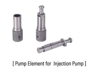

The pics above are of the Delivery-Valve. These are NOT the Actual Plunger. Plunger lives Under the del.valve Inside the body of the pump. It cannot be removed without a full pump strip-down.

No, The pics of the parts above are the del.valves. The Elements/Plunger-Barrel combo lives Under the outer part of the del-valve (not pictured)
--I'm guessing the 'Large Washer Thing' you're thinking of is the Outer Part of the Del. Valve
The 'Element is comprised of two parts. The Outer part is its Barrel and the Inner part is the Plunger. The Plunger is cut with a spiral groove and sometimes the top part has a specially arranged angle too.
Here--
When these devices are changed in a pump, the position of each one is critical and they all need to be set to deliver the same amount of fuel at the same rack-position,--this is done on a Diesel-Pump test-bench, like a Hartridge 2000--The pump is motor driven and each outlet attached to graduated tubes of high accuracy through special pre-set 'injectors' The pump is driven and say, 1000 shots of fuel are delivered from each outlet on the pump The readings of fuel quantity is taken and compared to the pump 'Test-Plan' for That serial pump and at that throttle-setting.
--There are normally three different throttle/operating condition settings the fuel is checked to
--The Governor is set to these values after all elements are ballanced.
The Rollers running on the Cam (M-Type) are carefully chosen as to size (40 different sizes I believe) to allow the same point-of-injection -timing-setting for each cylinder,--the so-called, 'Phasing' adjustment.
Now--IF you Change an Element for a different Size--(And in a perfect world, all the other characteristics would be the same) then all the above settings will need to be altered and the new amount of fuelling determined for the amount of power required.
--But, The new larger elements often have different characteristics (Because they were intended for a completely different application engine) as well as their dimensions and this also must be factored into the setting of the elements/rollers and the Governor.......
