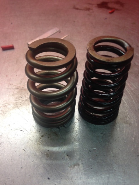

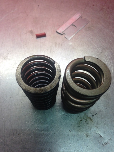

02-02-2014, 03:57 AM #155
(02-01-2014, 02:49 AM)hansebanger77 No ksteen , never opend. If I blow the head up from the engine I want make some good head update. Not shure about the harder springs. There are a thread with big fail on valve ?
I think i have power enough up to 6000 I dont must rev higher. Ok if I must rebuild the head I could think about it :-)
Can you link to that thread?
I think it is because high revving on stock valvesprings...
Stock springs is really rubbish, only 17-18kg ratingSad
Kmcams spring is good for about 8000rpm and have 38kg rating

02-02-2014, 07:40 AM #156
http://www.superturbodiesel.com/std/Thre...514?page=2
Do you have mod some other things with this high ratio springs. I remind you have weld some stuff at the camshaft to the wheel for timing chain? Is it not more stress for the chain or some stuff ore harder to crank the engine ? Thx dani:-)

02-02-2014, 08:45 AM #157
i suppose, when you are running supercharger, injector pump with larger plungers and then stronger valve springs it going to put more pressure on the crank and cam sprockets.
those km springs at 38kg should be ok,
just saw mitsibishi 4g63 springs data,
Seat @ 1.50" = 85lbs
.473" = 202lbs
Max Recommended Lift: 12mm

Duncansport
526
02-02-2014, 07:46 PM #159
I found that these springs from a ford modular 4.6 are about the same size and offer twice the seat pressure at 1.470 as the stock 605/606. You do need to change the lower spring seat.
These are 90lbs @ 1.470 and i measure my 605 springs at 25-40lbs at 1.500.
I think the KM cams springs are the best bet for most as they are a drop in. But for me ( someone who always does things his own way ) i was happy buying the spring seats and springs from someone local (comp cams) for $250 shipped.

EDH_Performance
537
02-03-2014, 03:52 AM #160
(02-02-2014, 07:46 PM)Duncansport I found that these springs from a ford modular 4.6 are about the same size and offer twice the seat pressure at 1.470 as the stock 605/606. You do need to change the lower spring seat.
You newer know, they look like the ones from kmcamsSmile
