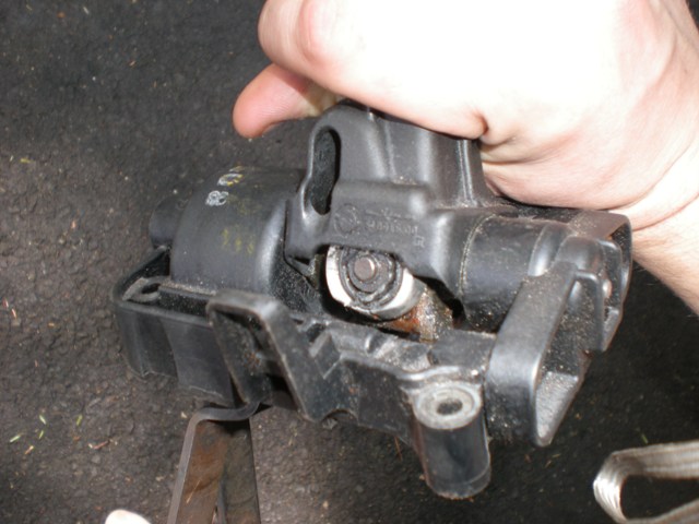

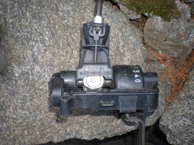

have to head upstate again, but I am still having strange issues with overdrive which I will think about throughout the week. So, now its adjusted fine, throw of the stick moves it completely into gear, but most of the time it won't stay unless you hold it, sometimes it works perfectly, sometimes not.
If I don't get it figured out, im going to toast the gear accidentally. I swapped the shifter assemblies, and its really amazing how different it is to shift based on the quality of the shifter!
The first one is really clean, and it shifts beautifully, the second one is crusty and nasty, and its really hard to shift. I would assume it were in the transmission if I did not have this comparison.
I took a really close look at both shifter assemblies and I think the problem could be in them. Things are unbelievably complex. They both have a steel ring worn to various degrees in the bottom. The ring has a boot which must be to soften the shifting I guess.
heres a pic of the good one-
Notice this metal ring that is worn here, and the crack right on the bottom? the bad one does not have that, but its even more worn in the center rubber section.
The crack widens when you put pressure on the shifter towards where the overdrive position is, and on the crappy one, the boot is worn out completely. They both are broken in a different way, but Im not sure whats broken has anything to do with the issue.
just in case I am going to pull apart my 717.412 next weekend and check it against my photos of pulling apart the 717.411 to make sure something is not missing from the tranny, or if something is misadjusted inside. Fortunately, if it is an internal problem related only to overdrive, its on the end of the transmission thats accessible.

05-26-2010, 09:08 PM #162
(05-24-2010, 01:20 PM)dropnosky have to head upstate again, but I am still having strange issues with overdrive which I will think about throughout the week. So, now its adjusted fine, throw of the stick moves it completely into gear, but most of the time it won't stay unless you hold it, sometimes it works perfectly, sometimes not.
Isn`t that worn part, the brass bushings they are using that I listed up in post#111?
http://mercedes-190.co.uk/single/?p=8160322&t=6576914
Charlie

05-27-2010, 07:59 AM #163
Charlie
[/quote]
Yeah, you are right, thats exactly what it is! Somehow I completely missed that part of the shift mod they were doing. Ive got the crappy shifter turned into a short shift, but I did not remove them to do that, I just cut and welded them on the unit. maybe I should just go all brass for these bushings.

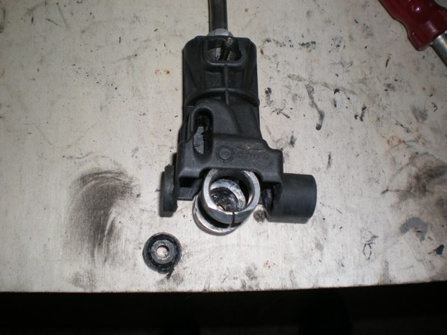

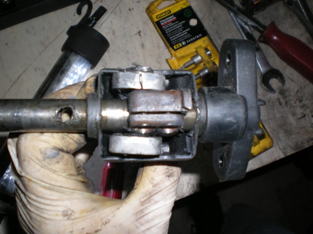

05-30-2010, 11:04 AM #165
well, I need parts for the good shifter-
Its got this aluminum piece that looks like a yoke that it cracked like a said before. I took the thing almost completely apart, there is some trouble with a peg that keeps the spring loaded end of the shaft in for the reverse lock out, so I have not completely removed this plastic piece.
some pics-
The rubber parts for this one are in way way better shape than the ones for the other one, but the other one the metal is in better shape. I am taking that one apart now to see If I can't just get the flipping thing to work for the interim

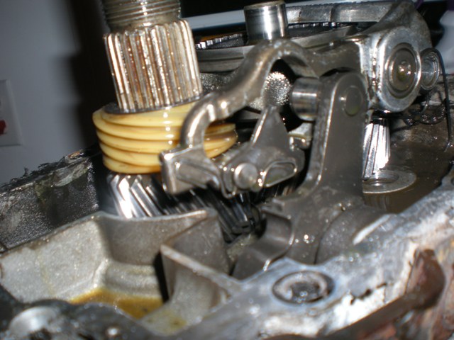

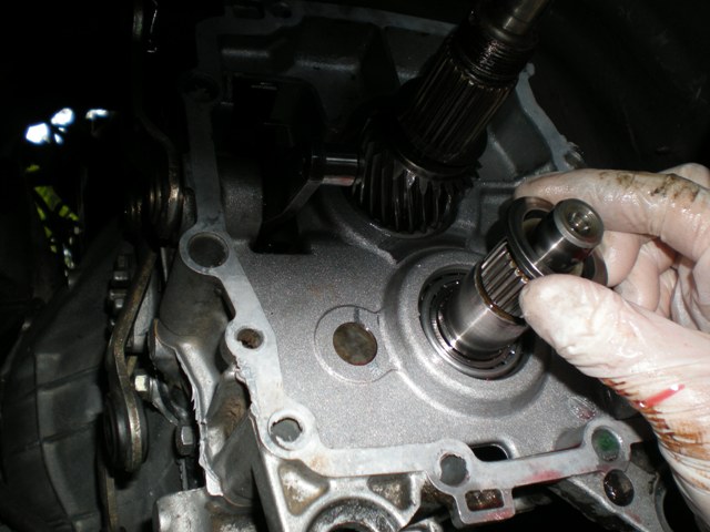

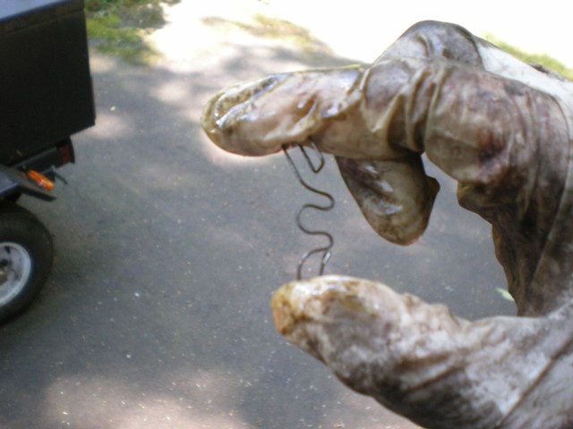

05-30-2010, 08:00 PM #166
Eureka! I know what the problem is! Have been doing research of old photo archives of mine.
I am missing a detent spring, here is a pic of when I first took apart this tranny a year ago. I must have lost this spring in transit when I moved.
There is a swivel lockout on the reverse/overdrive internal shift arm, and the spring missing would mean it would sort of randomly swing back and forth.
This totally explains the sometimes working, sometimes not overdrive. I took the thing on I think 12 test drives with the linkage and shifter in different adjustments, and moved it all over the place. I even went so far as to weld in a little extra length on the lever, now I have to remove it. Those components are totally eliminated from the problem
To fix this I have to pull the forward driveshaft, linkage arms, and the rear cover on the tranny, hopefully tomorrow morning.
Also, took care of the shifter temporarily, combined the best parts of both shifters and fixed the bad bushings with something we all have around the hosehold. Big Grin The pic does not show it clearly, but take a guess what fits almost perfectly in that bore-
Removing the rubber bushing there totally changes the feel of the shift, I really like it, its a closer harder feel, but I still have the rubber underneath so not jarring. Now the shifter moves into gear and slots in firmly vs kind of a spring loaded feel they normally have
05-31-2010, 05:12 PM #167
still not fixed, despite playing with it all day today. There are actually several tiny parts missing from the reassembly.
The problem here is that I disassembled the darn thing a year ago, moved jobs and apartments several times carrying it around in a box, then put it back together when it was no longer fresh in my mind. This was an incredible mistake, should have put it back together then and taken it apart later on.
Water under the bridge, just prolonging it working correctly. Out of time again this weekend. Angry
So, here is one of the parts that was missing-
the transmission can actually be 90% disassembled while bolted to the engine, but still I had to remove a LOT of stuff to get it all apart. After buttoning it all back up again and taking it for a test drive, realized that I failed to put back in a crucial snap ring which was missing also. AngryAngry You can imagine how angry I was, fortunately I am calm now. Big Grin
This piece fits on the end of the countershaft and locks the central part of the overdrive synchro. Without this, Im guessing that the syncro can slide down a bit and actually disengage the gear. It sure as hell needs to be there, thats for sure. This plus the missing spring are all parts of the greater problem with the overdrive issue.
heres a pic of the snap ring-
Ill have to break it down again next weekend.

06-06-2010, 04:23 PM #169
we're in business for real this time! Big GrinBig GrinBig GrinBig GrinBig GrinBig GrinBig GrinBig Grin
http://www.youtube.com/watch?v=3vZEJbGeuSk
Ok, admission time-
Why this did not work immediately was because I forgot no less than THREE important pieces directly related to the overdrive gear. Actually pretty interesting what was happening, otherwise I probably would not be admitting this on the forum.
When I reassembled the transmission, I forgot (1) a small shift detent mechanism spring that controlled a little swinging lock, (2) the snap ring that holds the overdrive synchro in place on the splines, and (3) a thrust washer behind the overdrive gear between it and the case.
Frankly, I can't believe that it even went into gear at all. When it made that horrific noise, that was actually not the gears grinding, that was the overdrive gear being forced into a division plate in the case. When I would "put" it in overdrive, the central part of the synchro would slide back because of no snap ring, and the lever would push the gear into the aluminum housing, resulting in that god awful noise. This would only happen every now and then, because the swinging lockout without its spring would sometimes prevent even that.
whoops. Rolleyes
All that stuff is in there now, and its working great! Now to finish up the floor of the car and put some miles on it to see how she holds up! More importantly I get to start on adapting my second 717.412 to the 617 to drop in my wagon! heres a few pics of it disassembled on the car, overdrive exposed-
Important thrust washer, you can see the scoring on the case above the lay shaft for overdrive, the cut is not too deep-
