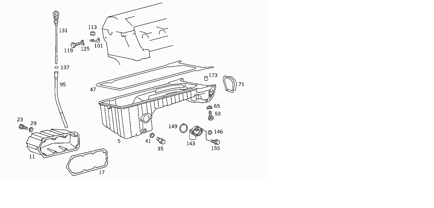

I would like some help With what I can do With two things. Smile
1: I need to reweld the oilpan, because it is 3cm under the lowest point of the car, and the first that will hit anything if I og of-track. What can I do with the oilpump? Can I shorten the original pipe Shorter, or can I use oilpump from something else?
2: Sinse I am building compound and put more money in the engine, I am thinking of do some work on the head. First tought is stiffer walvesprings and new camshafts. Is the N/A camshafts better than the turbo ones? What else would you have done? Smile
Thanks for any help Smile

(12-16-2013, 02:08 PM)Stamsaas 1: I need to reweld the oilpan, because it is 3cm under the lowest point of the car, and the first that will hit anything if I og of-track. What can I do with the oilpump? Can I shorten the original pipe Shorter, or can I use oilpump from something else?
You can cut and weld the oil pickup, no problem. But maybe you should consider a pump with more capacity? you need oil for 2 turbos so maybe a pump from 606? (look at my oil pump thread)
You can cut your 605 pan but you will have less oil, maybe a problem?
I have a 603 turbo pan you can modify and use. Call me if you need more info.

Duncansport
526
12-30-2013, 12:11 PM #167
(12-30-2013, 03:52 AM)erling66 I don't know if the 606 oil pump is bigger. measure your 605 pump and I can tell you if it is.
Can the 605 pump deliver enough oil volume for one extra turbo? don't know, but do you want to try to find out the hard way?Confused
The 603 oil pan has an extra chamber(for more oil) bolted to the side, that is why I suggested to use it, but it will require some serious welding since you have to shorten it.
Couldn't he use a 602.962 pan? Same bump out as a 603
Duncansport

Any pics of this 602/603 pan? Smile how much different is the hight compared to 605/606? Smile

Duncansport I have never seen a 602.962 pan, but if it has the same bump for extra volume it would be greatSmile Do you have photos?

(12-31-2013, 03:59 AM)erling66 Duncansport I have never seen a 602.962 pan, but if it has the same bump for extra volume it would be greatSmile Do you have photos?
Duncansport
12-31-2013, 10:11 AM #170
erling66
SuperDieselVan
294
12-31-2013, 10:34 AM #171
That looks very similar to the 603 turbo pan, so try to get that one. I believe that all the 602/3/5/6 pans have the same depth, so you will have to cut off 2-3cm but should be ok.
Oil splashing around and hitting the crank is a different concern so don't fill more than max, or even better is to stay close to minimum(if you don't loose oil pressure during acceleration or curves)

12-31-2013, 01:03 PM #172
(12-31-2013, 10:34 AM)erling66 That looks very similar to the 603 turbo pan, so try to get that one. I believe that all the 602/3/5/6 pans have the same depth, so you will have to cut off 2-3cm but should be ok.
I thought that 605/606's use windage trays? My 602 had one installed OE
