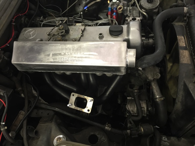

04-19-2015, 05:36 AM #153
Yea I have the pump, it's in and running. I shipped my intake to Sweden, and the government there is for some reason holding up the show.
With a lightweight flywheel and a big turbo, I'm going to lose low end torque. Shorter gears should make it so I don't miss it too much. I'll have an absolute top speed of 120mph, which I can not ever forsee myself doing. Mostly light city, back country road driving, some highway but I really only do 75 anyway.

It is! Currently at F-tune performance.
Fred is cooking something up that I'm sure will be amazing Big Grin

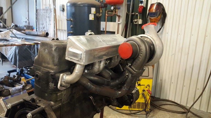

The new intake flange for the om617 Tongue
[Image: 210381-f97c1406f4ac379427f4c09546839a42.jpg]

(05-13-2015, 03:18 AM)F.R.A.S The new intake flange for the om617 Tongue
Big GrinBig GrinBig Grin
Can't wait to see the magic you guys work Big Grin

Makes more sense than hacking up a w115 intake.

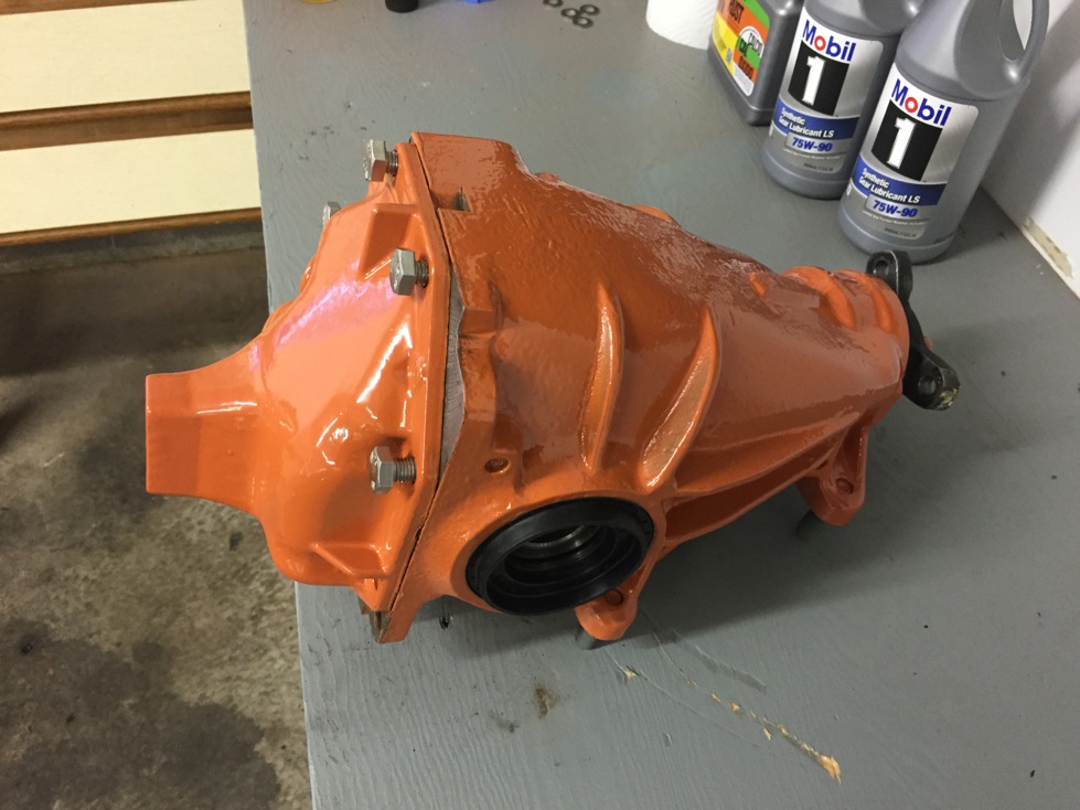

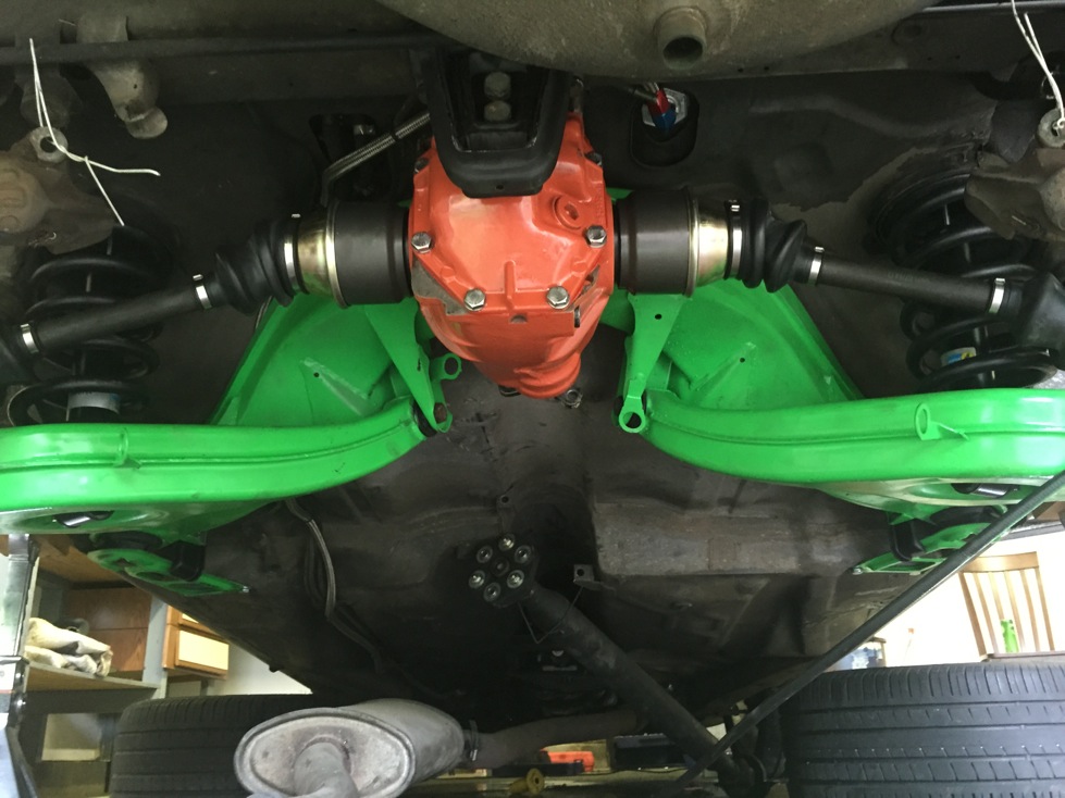

06-08-2015, 03:19 PM #169
Moving slow lately due to a variety of things.
- new subframe bushings
- new control arm bushings
- new axles
- new diff mount
- 3,69 differential
- 18mm rear springs
- Bilstein HD shocks
- metal swaybar links
This post was last modified: 06-08-2015, 03:20 PM by led-panzer.

Got my big box of parts from Sweden this morning, courtesy of F-tune performance Big Grin
The flywheel, clutch, and pressure plate all look great. Flywheel weighs 18lbs. Rev Rev Rev.
The manifolds fit great in the chassis. No interference or issues
The issue I do have is the HX35 compressor housing is too big, and hits the hood.
So. I've played with this every way possible and there's no non-hack way to fit it.
Which means I need to find another turbo. Ideally the same flow rates and wheel sizes, just in a smaller package. Looking at maybe a GT3076R.
Thoughts anyone?
Thoughts anyone?
