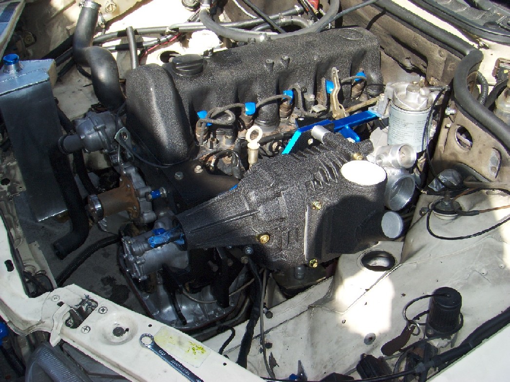

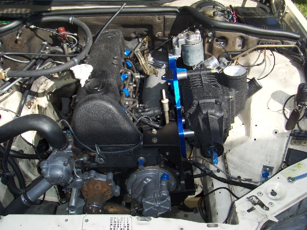

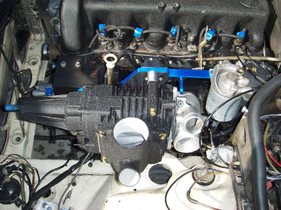

05-24-2010, 06:37 PM #151

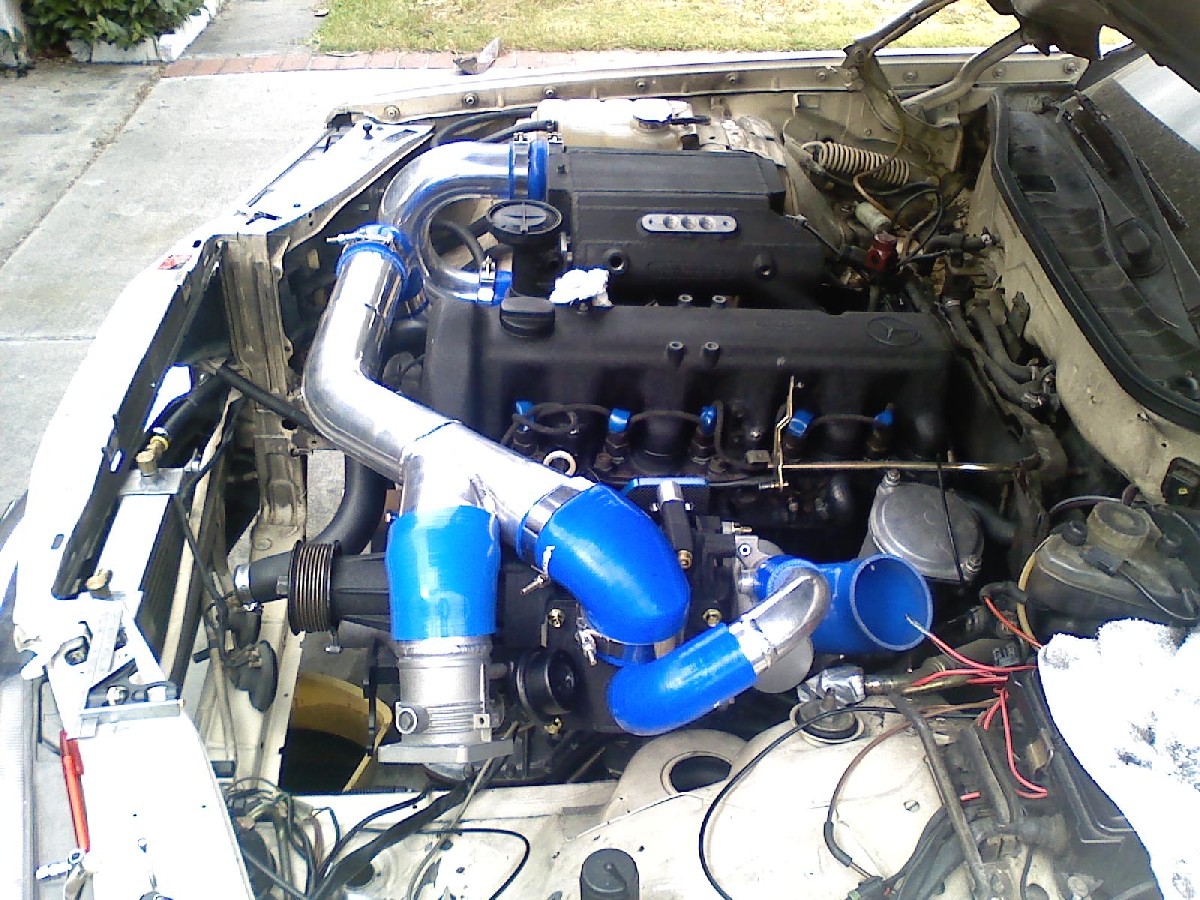

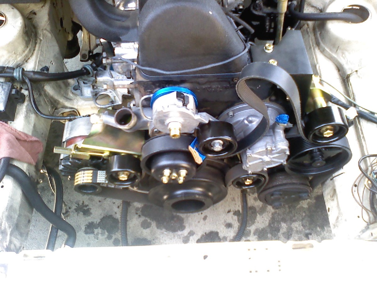

I installed the S/C today for fitment and I am very happy!!!!Big GrinBig GrinBig Grin
As anticipated, I may have to modify the shock tower, but I am still working on a solution to that.
Here a few pics, enjoy:

05-24-2010, 07:58 PM #152
Hope you dont have to lean that IP to far to adjust for timing Big Grin. Looking good. Did you paint the block at some point?

05-24-2010, 08:03 PM #153
(05-24-2010, 07:58 PM)winmutt Hope you dont have to lean that IP to far to adjust for timing Big Grin. Looking good. Did you paint the block at some point?
The M-pump is MUCH smaller than the MW and I have plenty of room to and fro. If I used the MW then injector lines would be in the way.
The block was that color when I go the car, Is it not the OEM color?

05-25-2010, 02:00 AM #154
Are your oil cooler lines in good shape? I need a set so I might be interested Big Grin Send me a PM with your price. Thanks!

05-25-2010, 02:49 AM #155
(05-24-2010, 08:03 PM)Rudolf_Diesel The block was that color when I go the car, Is it not the OEM color?
I don't think black with rust polkadots was an option. Big Grin

05-25-2010, 11:16 AM #158
(05-25-2010, 10:50 AM)George3soccer Hey rudolfdiesel. Great project by the way love it.
Got a question what are you doing about the power steering issue, and the steering box.
Thanks. As far as power steering, I am using a pump from a Ford Contour with a pulley from a Lincoln Navigator and a reservoir from a 1970's vintage mercedes gasser. The fittings for the sterring box I bought from a place on the web to adapt to JIC fittings and I will use the reusable type hydraulic hose from Parker.
I am doing the same with the oil cooler as well. The A/C compressor is from a Ford S/C motor and I am still trying to figure the final adaptation of the hoses.

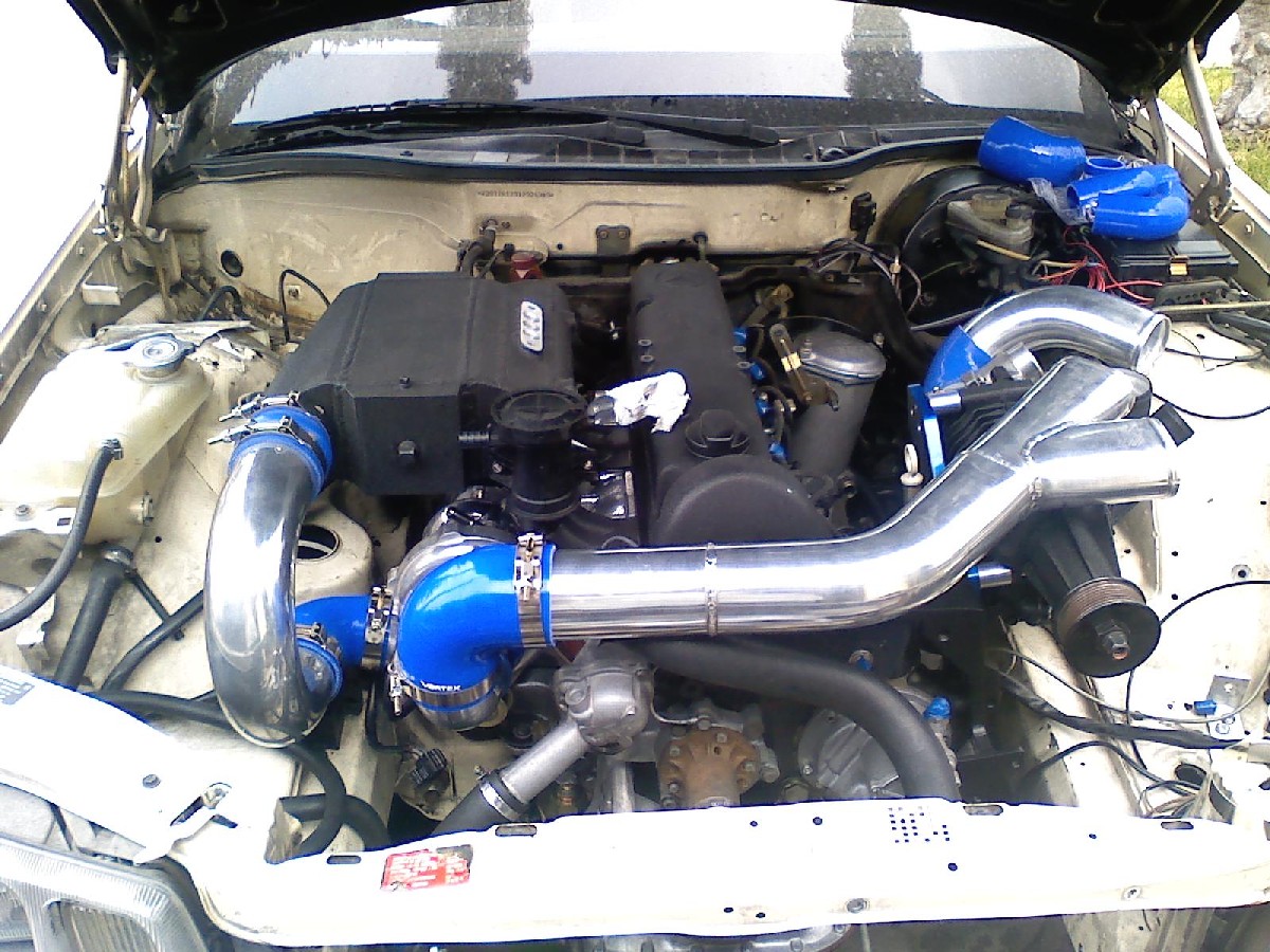

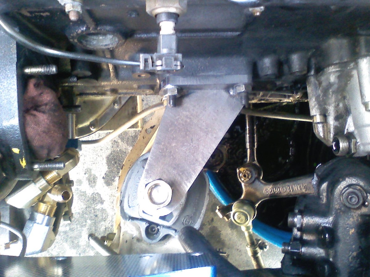

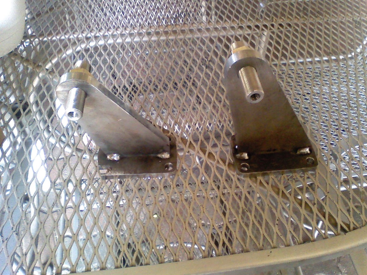

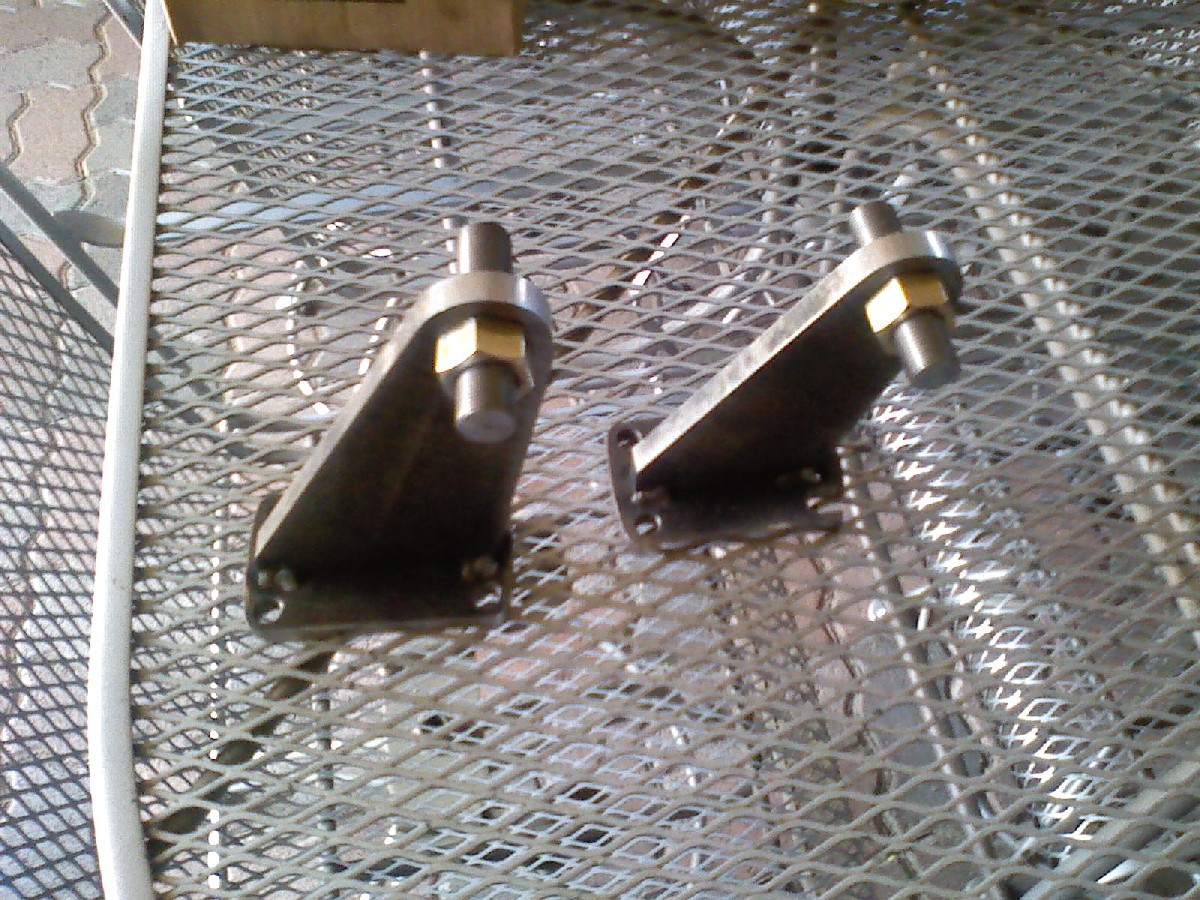

05-27-2010, 08:19 PM #160

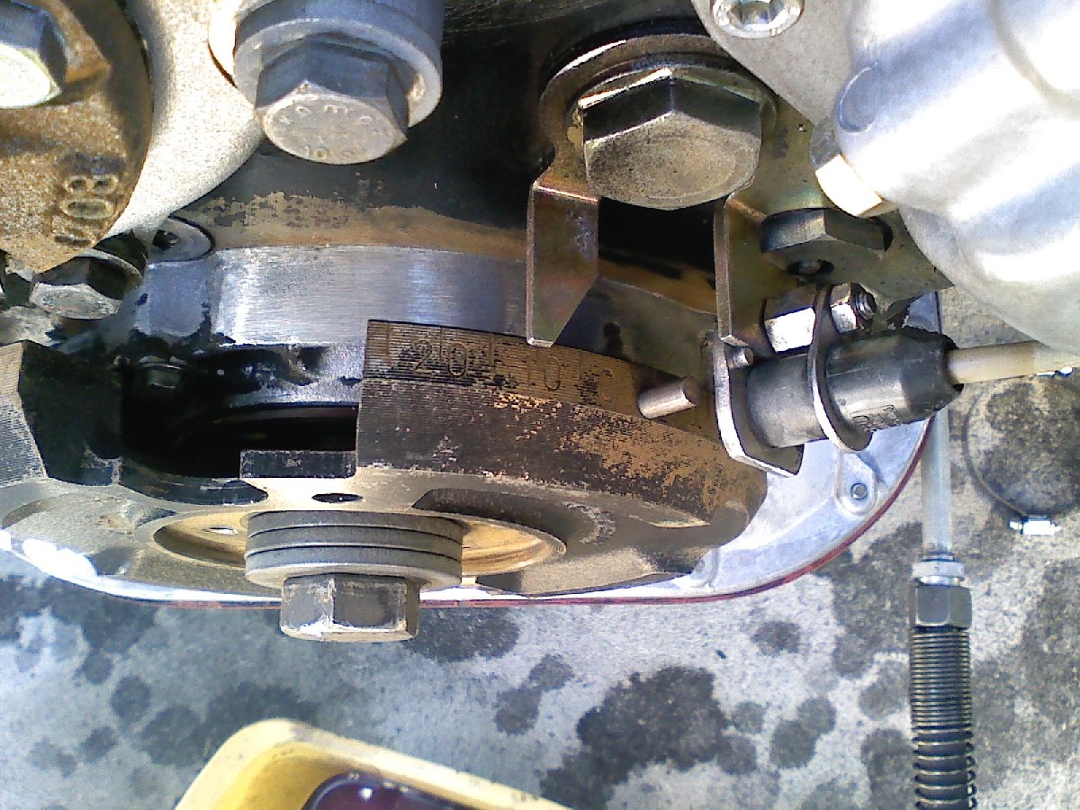

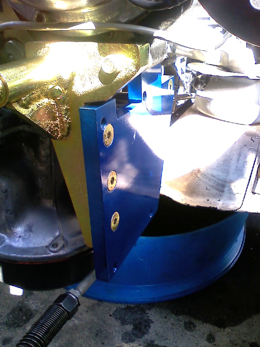

Making some progress, right now it is just a mock up from the engine on stand to the engine in car. No matter how many times you measure it you have to change something. I had to flatten the S/C outlet for hood clearance, but I could stand to have a 1/4" more. I had to change the inlet design of the S/C as well, but that is no big deal. The S/C bypass required a minor mod to make clearance for the intake tubing also. Changing the inlet design affected the mounting of the fuel filter, so I need to relocate it as well. Small revisions, no major problems. I need to fabricate or but a new reservoir tank for the A/W too because the turbo to IC pipe hits the old tank. This change allows me to get a bigger tank and more capacity - so a win-win. This weekend I am going to R&R the timing chain, before I swap it out I will check the stretch on the old one for comparison.
Here are a few pics:
This post was last modified: 05-27-2010, 08:23 PM by Rudolf_Diesel.
05-28-2010, 07:51 AM #161
Can someone hand me a tissue?

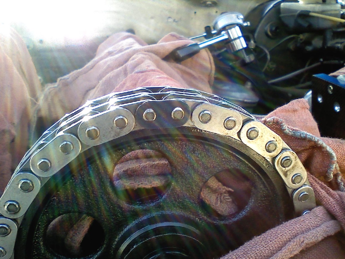

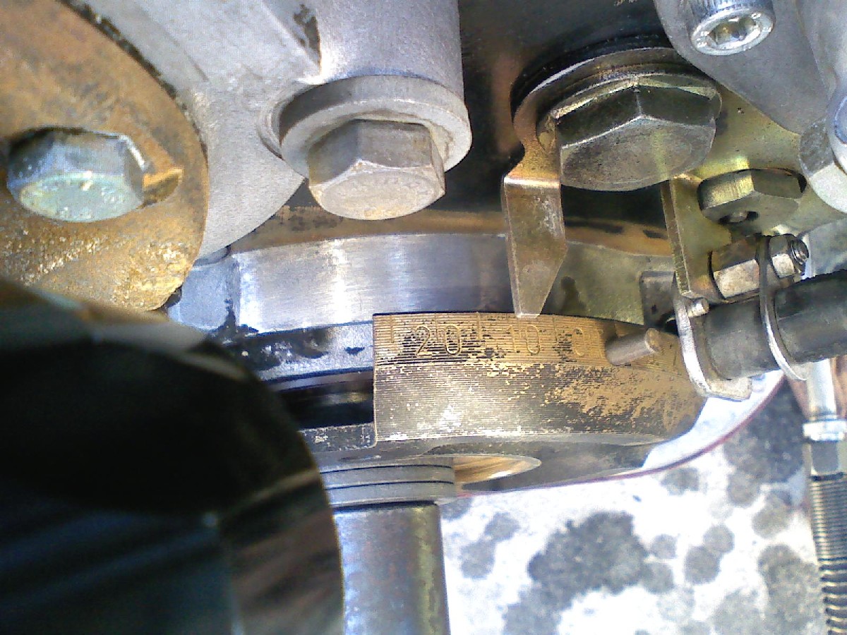

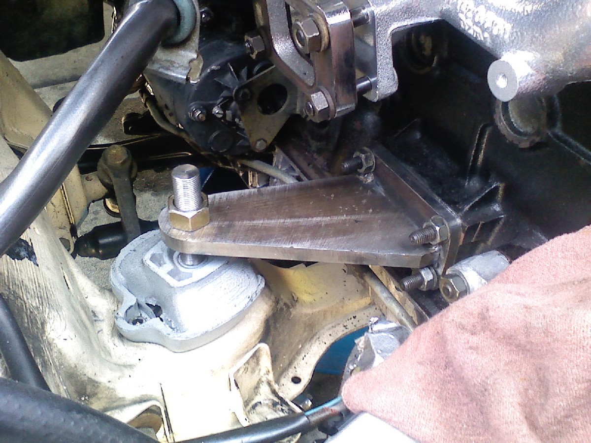

05-31-2010, 02:01 PM #165

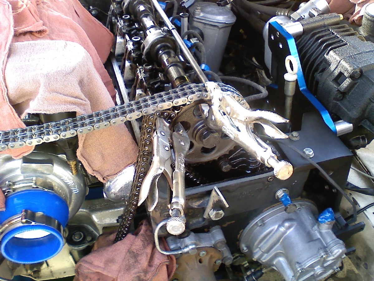

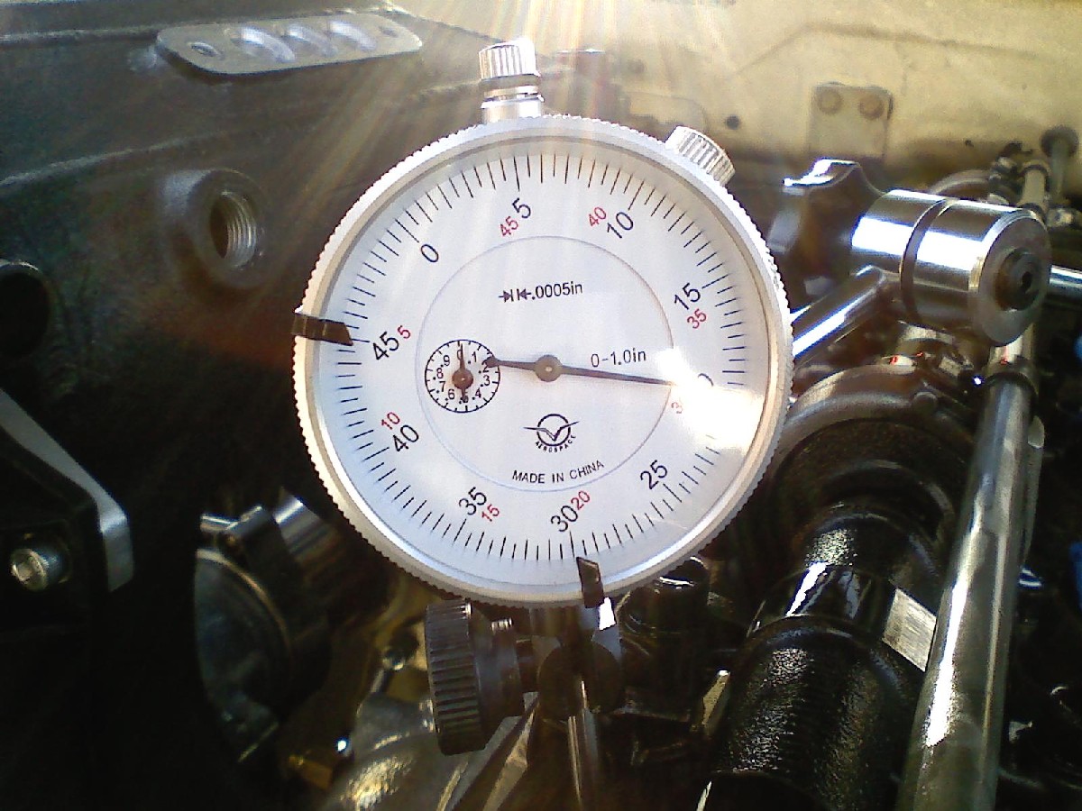

Made some more progress this weekend, I have some pics...
Measuring Tming chain stretch with .080" of valve movement
Looks to be within specs at about 11 degrees, but to be safe I am changing because of the nature of the project

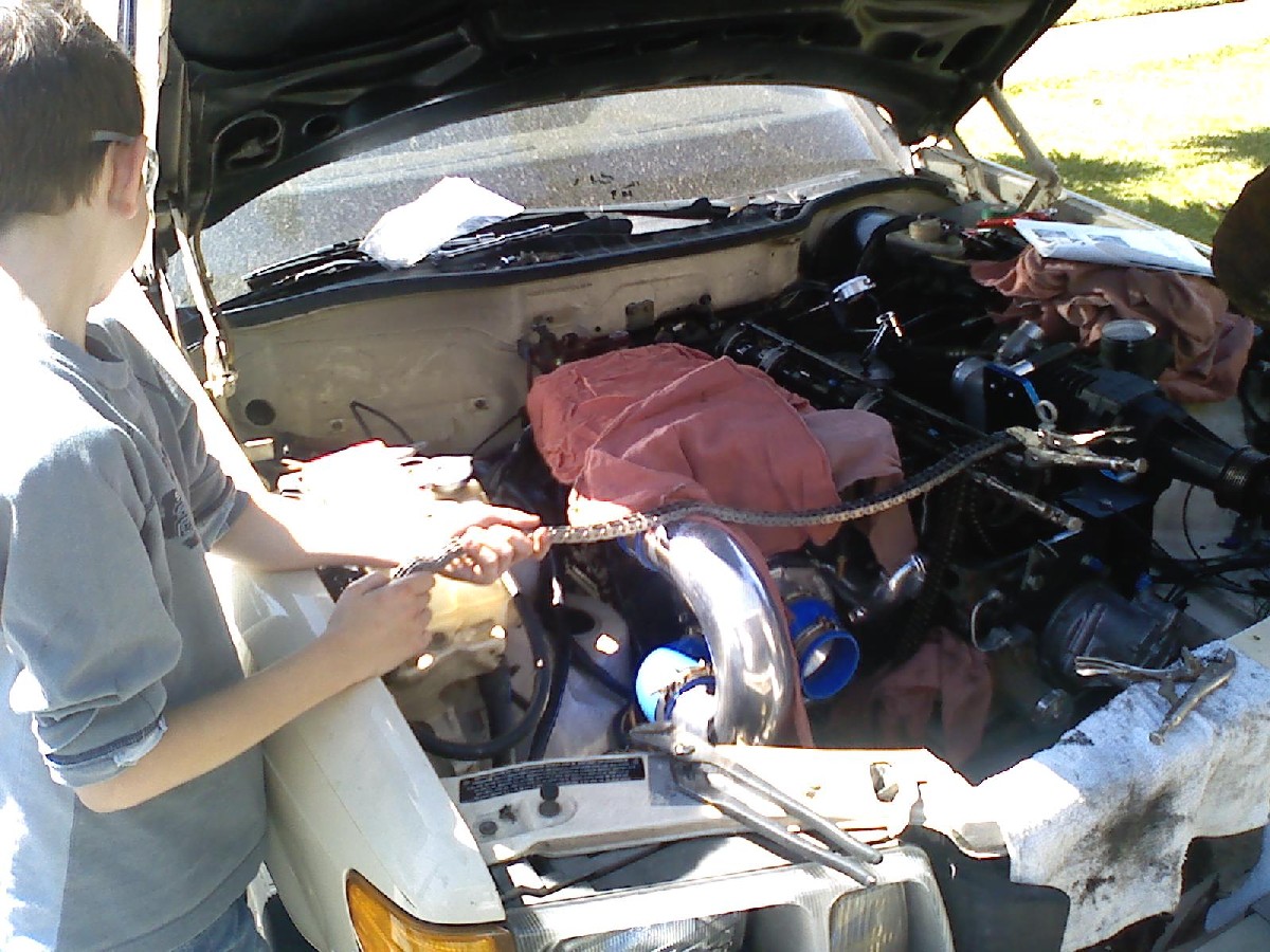

My two boys helping me install chain
View of chain with helping hands
Completed chain with proper crimps

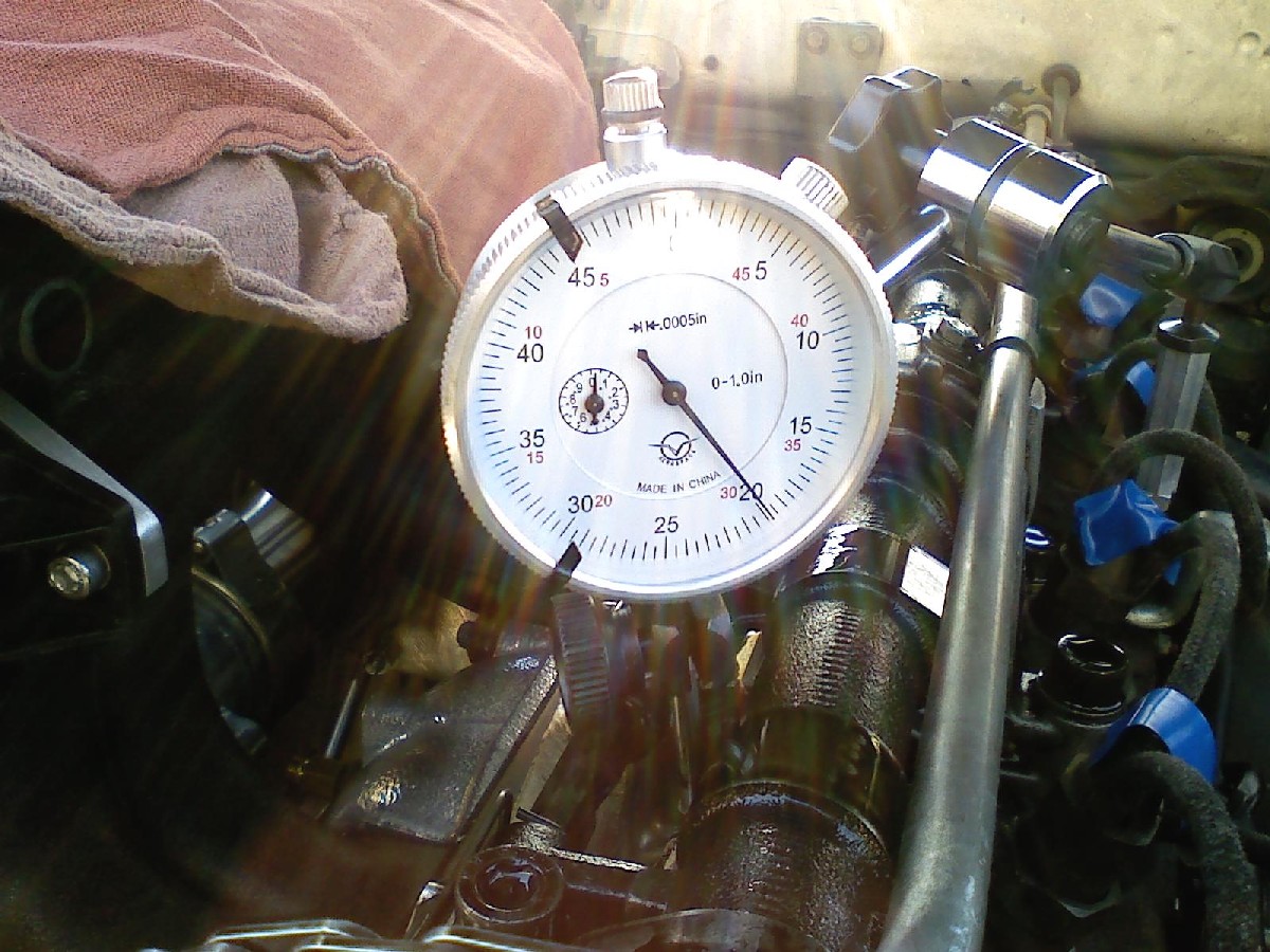

Checking new chain with 080" movement
Seems to be the same as old chain, but better safe than sorry.

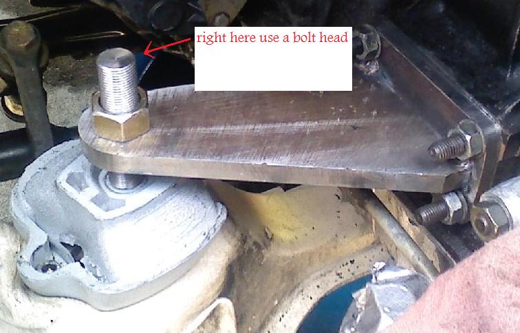

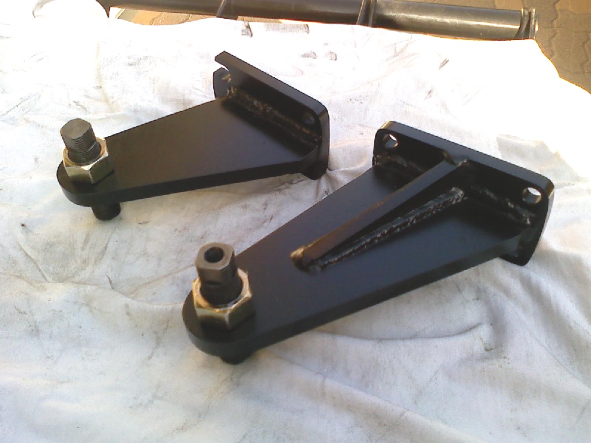

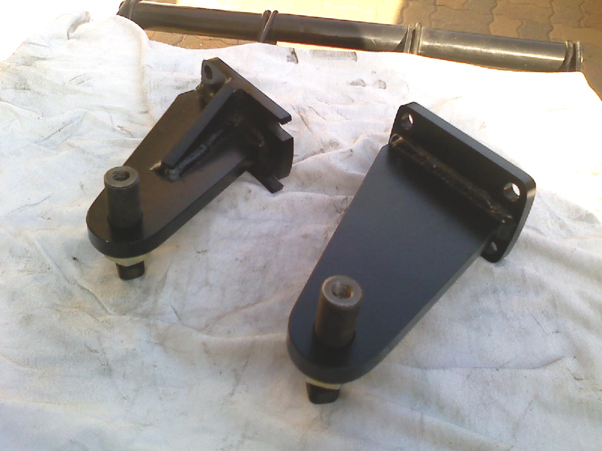

I also adjusted the valves and installed new motor mounts as well. The new motor mounts raised the engine about a half inch, which maybe a problem for clearance. Everything is a tight fit and I hoope they settle a bit. I plan on changing the trans mount in the hopes it is worn and will raise the rear of the engine and pivot the motor downward when installed.
I also installed the A/C compressor and bracket, power steering bracket and pump, alternator, and water pump pulley and idlers/tensioner. A few pics of progress...
A/C bracket sans compressor
Power steering pump
Alternator and other pieces attached.
I need to make some clearnace for the belt as it comes off of the powersteering pump, it will hit the body. A little altering of the molecular structure should do the trick - BFHBig Grin
I still need to order some new motor shocks, my old ones were shot as well as the bracket the houses the shock on the motor mount bracket. Little by little it is coming to completion - I just need the Uber Pump and I can time it and finish the S/C install.

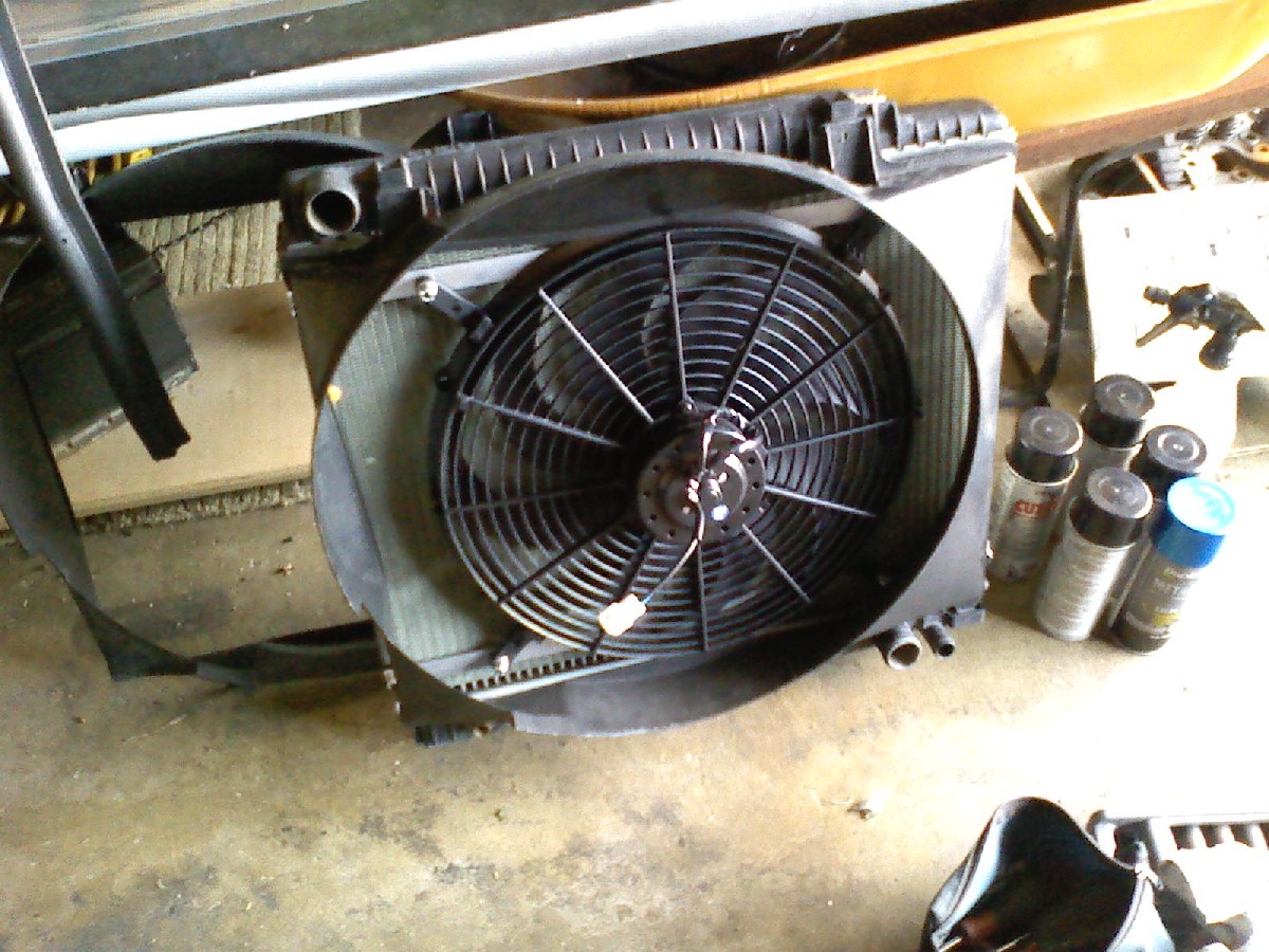

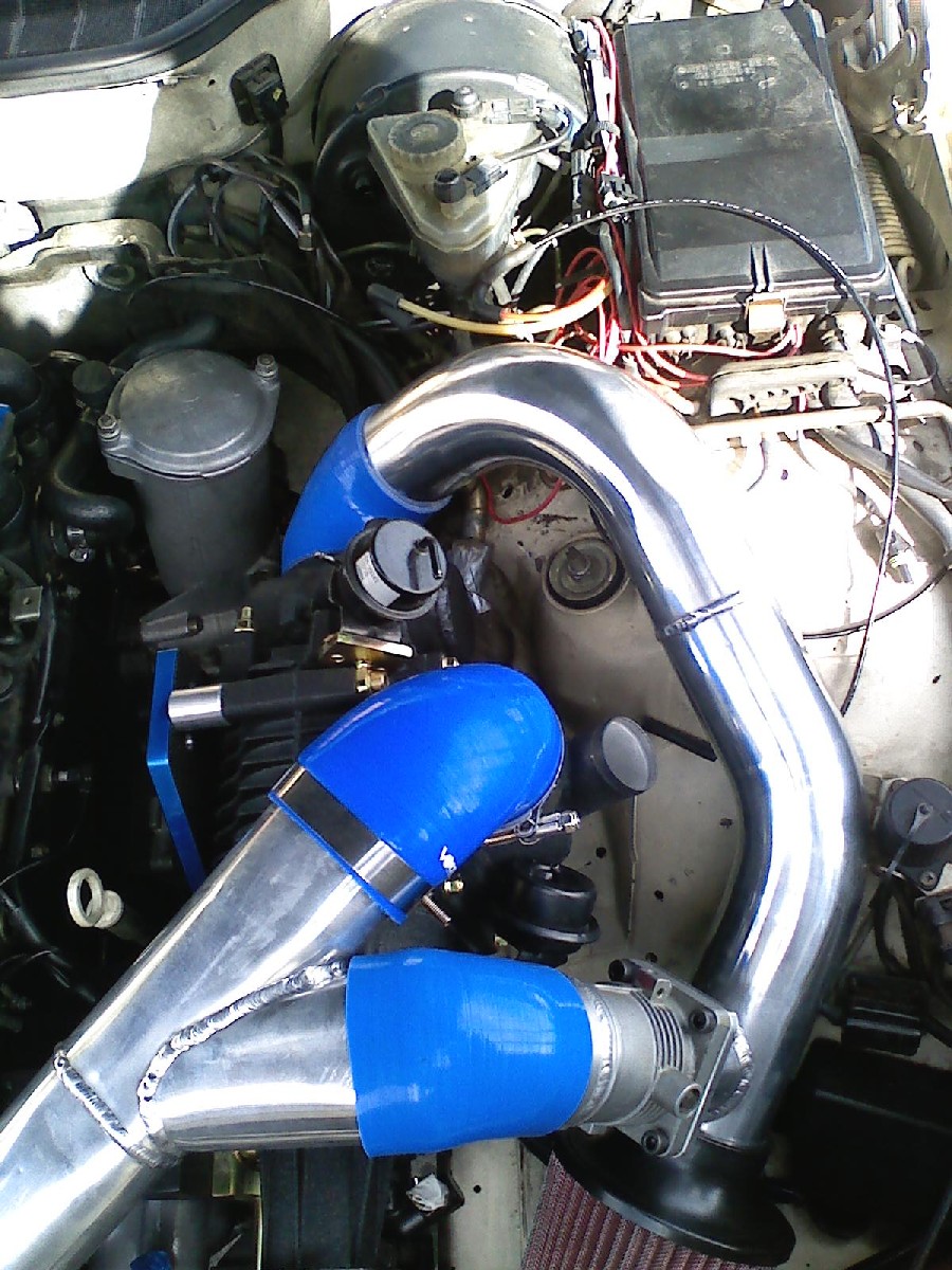

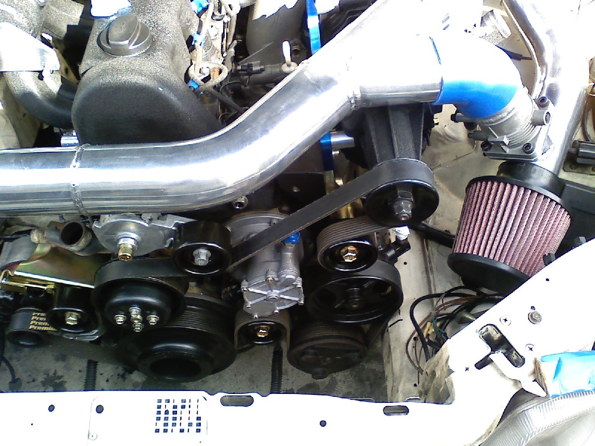

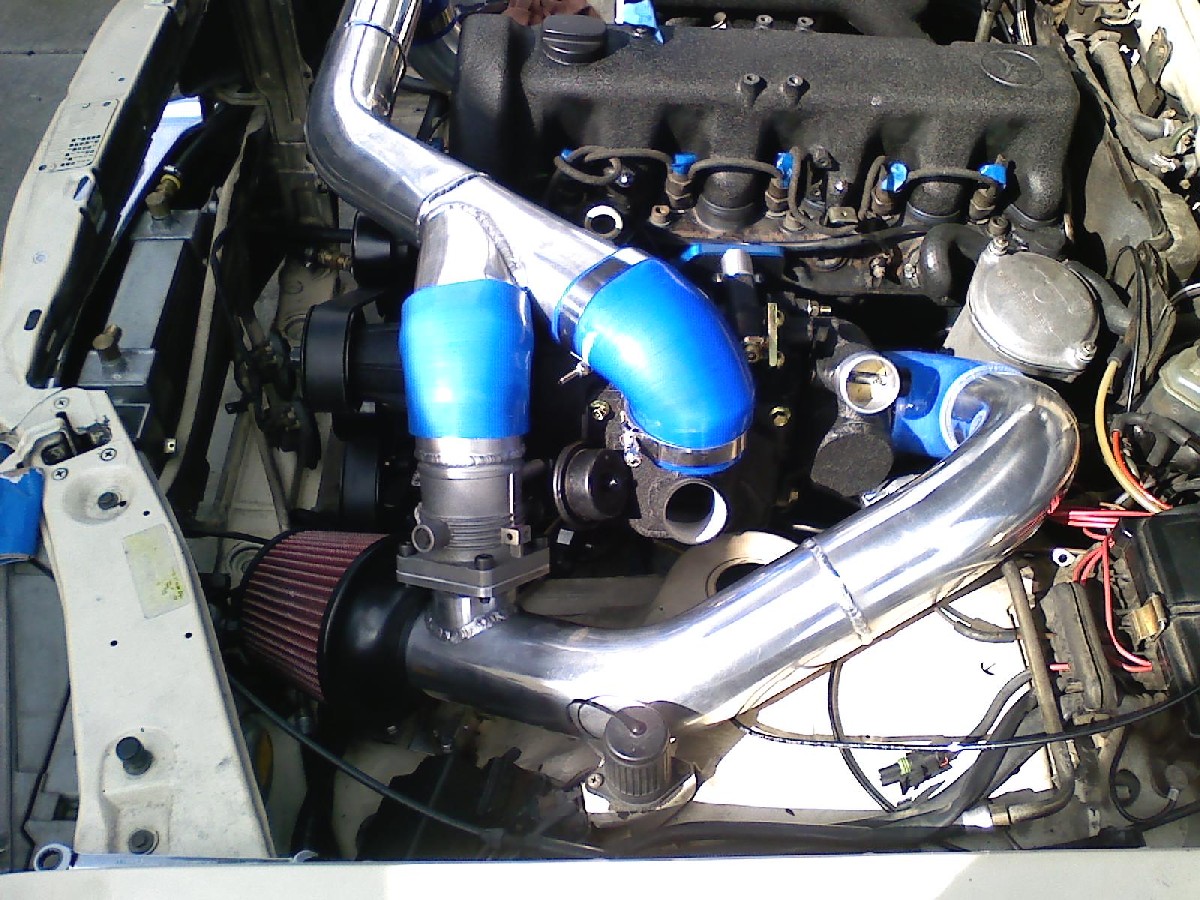

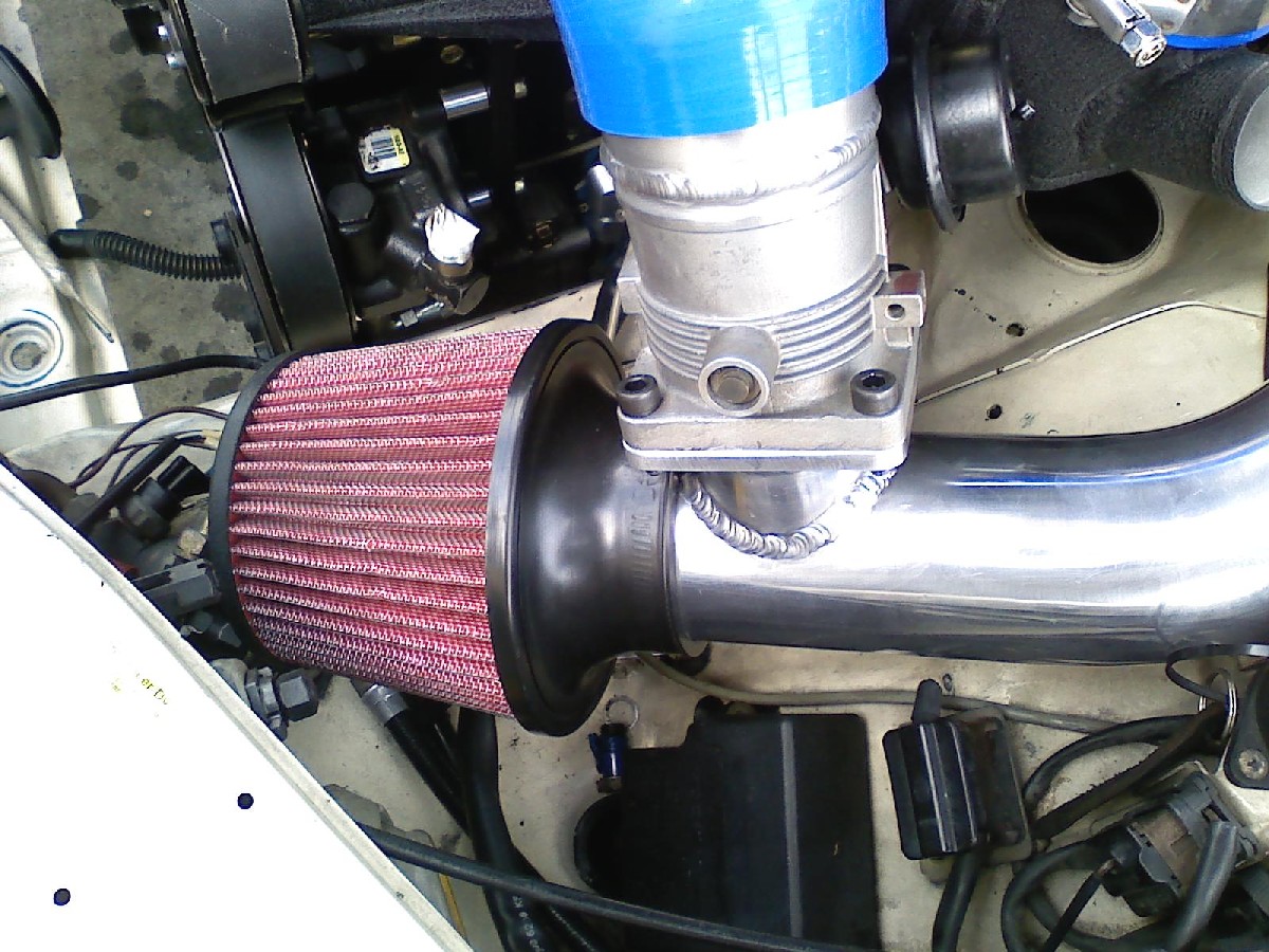

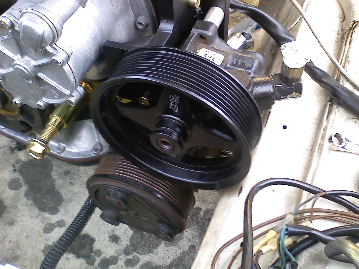

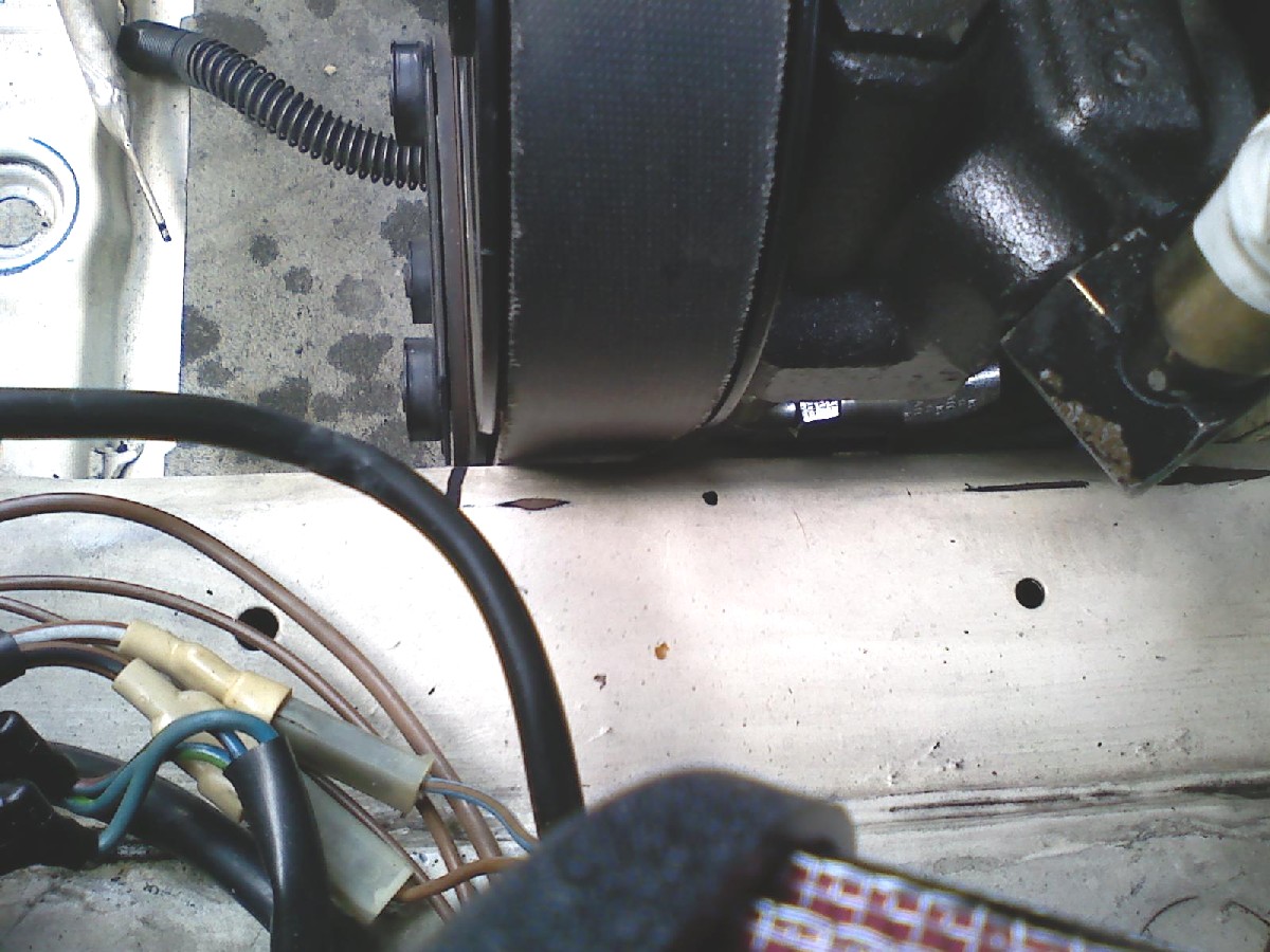

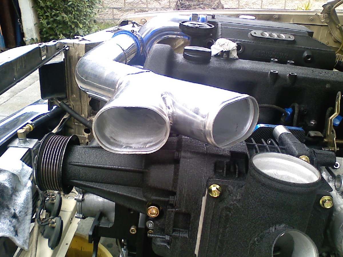

06-02-2010, 08:02 PM #170

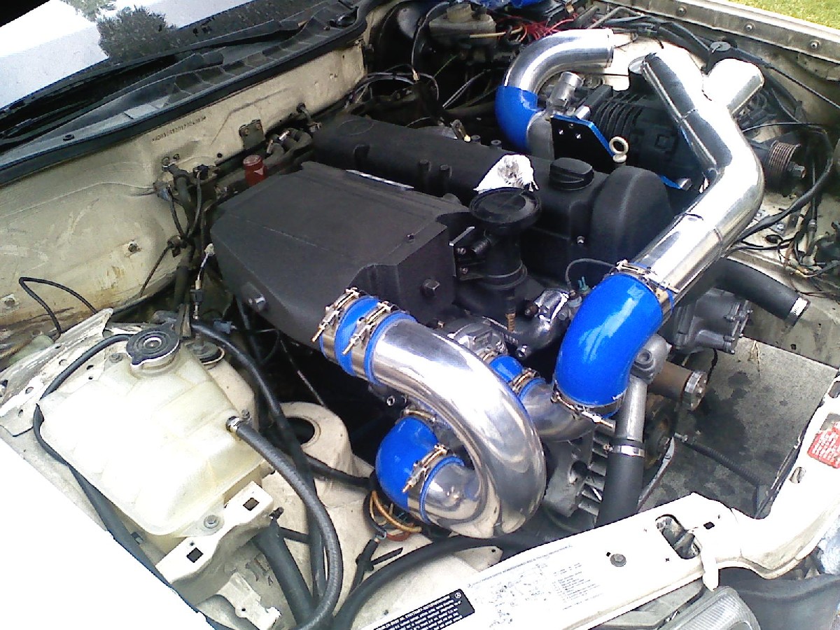

Got a few more things done, little by little it is coming together, a few pics of progress...
16" Electric fan
Power steering pulley/belt , needs a little more room BFH to the rescueBig Grin
Bypass with temporary air filter
Top view of inlet and outlet
Serpentine belt installed, I am able to turn over the motor by just turning the super charger pulley nut
Another view of plumbing

06-03-2010, 04:15 AM #171
Looking great so far, thumbs up Big Grin.
Are you planning to use the e-fan alone, or you going to use the clutch fan as well?

06-03-2010, 06:10 AM #172
(06-03-2010, 04:15 AM)Deni Looking great so far, thumbs up Big Grin.
Thank you. The fan is rated at 2700 CFM and should provide sufficient air flow for cooling. I plan on only running the electric with a t-stat control and bypass switch for manual operation and see how she works. There would not be enough clearance to run both. I have a tote in my trunk that I use for spare parts and I will carry the old fan for a "just in case" situation.

06-03-2010, 06:15 AM #173
What will be done about the vacuum pump inlet?
06-03-2010, 06:30 AM #174
(06-03-2010, 06:15 AM)ForcedInduction What will be done about the vacuum pump inlet?
I have a custom bent line that will mate to the OEM location. I don't have everything mounted yet, I am still waiting for the pump so I can install and time. Once I get the pump then it is balls to the wall to get it done. I plan on changing the flex discs, Bowden cable, trans filter and service this weekend.
06-03-2010, 07:33 AM #175
That filter looks awfully small.
06-03-2010, 08:02 AM #176
(06-03-2010, 07:33 AM)winmutt That filter looks awfully small.
It is only for mock up, I can use one that is 2 inches longer. The filter I am going to use is an AEM dry filter. The filter I was using with my T3/T4 was similar to the one pictured size wise and was rated at 800CFM.
06-03-2010, 10:55 PM #177

06-04-2010, 05:35 AM #179
What about the automatic's VCV? That would give a more linear response to throttle input.
06-04-2010, 06:38 AM #180
(06-04-2010, 05:35 AM)ForcedInduction What about the automatic's VCV? That would give a more linear response to throttle input.
I am eliminating the VCV's and using a later model throttle assembly with the micro switch and single cam to control the vacuum. The VCV control cam could work, but you are just using two switches and two cams and a awful looking mess to have a little more control. The switch is fully adjustable and I can set the actuation anywhere in the range of throttle movement. I could see a benefit if my driving habits dictated that I depressed the throttle in a slow and methodical manner, but it is such a miniscule amount of time from 0 to 3/4 that I probably won't see a problem. I will test as planned and see how it works, I am a more hands on tester than a theoretical tester.
It is essentially going to work as a control for the S/C bypass. On gassers the bypass is open due to manifold vacuum until you floor it and the vacuum drops and the valve closes. From the feed back I was getting on the pump testing, smoke was not a real issue, so at low boost, along with my ALDA unit, I should be fine. I am only trying to alleviate some parasitic loss at idle and low RPM function of the S/C.
This post was last modified: 06-04-2010, 06:43 AM by Rudolf_Diesel.
06-04-2010, 07:19 AM #181
(06-04-2010, 06:38 AM)Rudolf_Diesel you are just using two switches and two cams and a awful looking mess to have a little more control.
What mess? There is less tubing in my system than was in the factory EGR control.

06-06-2010, 07:10 PM #189
(06-05-2010, 07:52 PM)andrecorreia This is insane Wink good work there manWink
Thank you, it is almost sad this phase is coming to an end, but the trans will be a whole different thread.
I found a solution to my clearance problem. I made new motor mount brackets with an adjustable screw, some pics of the arms:
New arms sans gussets
Other side of arm
Driver's side
Passenger side
Gussets have been added and shock mounts to follow. This provides me with the proper amount of clearance and NO HOOD BUMP = Stealth
This post was last modified: 06-06-2010, 07:13 PM by Rudolf_Diesel.
Other side of arm
Driver's side
Passenger side
06-06-2010, 07:45 PM #190
ha ha, well, I guess it should come as no surprise that you would come up with some extremely well made elegant solution to that problem after reading the rest of this thread!
I love those motor mount arms, should potentially be better than the cast aluminum oem too for your application, I have a pair of cracked snapped ones just on on a stock 617. It would not be fun to apply a little throttle and have them crack
(BTW, you can keep that oddball bell housing to cut up or whatnot if you want if its any use to the later thread for the rest of the drivetrain. I used some parts of the original tranny to repair my utility trailer, its never going back together)
06-06-2010, 08:30 PM #191
(06-06-2010, 07:10 PM)Rudolf_Diesel ...
...... This provides me with the proper amount of clearance and NO HOOD BUMP = Stealth
I dig this solution. Another great idea... Gonna have to copy that one if I need it!

06-06-2010, 11:19 PM #192
just a feeling: I'd add stiffening ribs to the supports...
or try to combine the stock ones and the adjusting screws
Tom
tomnik
Tom
06-07-2010, 06:07 AM #193
(06-06-2010, 11:19 PM)tomnik just a feeling: I'd add stiffening ribs to the supports...
Tom
I took the picutres as I was mocking up the brackets. I have added gussets to the brackets, the drivers side is on the bottom to give clearance for the pump and the passengter side is on top.
The stock ones will not work because they are not completely solid, there is a cavity on the passenger side. My initial thought was to machine it to size, but that would severly weaken the arm. This design allows me to adjust for sag on the mounts and almost 20 mm of adjustment.
Tom

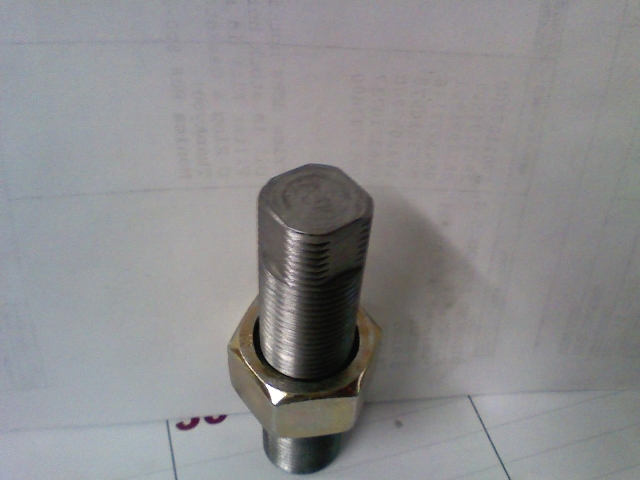

06-07-2010, 09:40 AM #194
I under stand that you have to unbolt the arm from the mount to adjust it but if it had a bolt with the lock nut you could adjust it a lot easier I would think?
Then all you have to do it loosen the bottom mount bolt, and lock nut and then turn it till proper height is desired and lock it all back down
This post was last modified: 06-07-2010, 09:43 AM by willbhere4u.
06-07-2010, 10:31 AM #195
(06-07-2010, 09:40 AM)willbhere4u I under stand that you have to unbolt the arm from the mount to adjust it but if it had a bolt with the lock nut you could adjust it a lot easier I would think?
You guys are getting ahead of meBig Grin
You mean something like this?
You must fit and then the final details grass hoppa.

06-07-2010, 12:27 PM #196
de de de well done!
de de de well done!
06-07-2010, 08:08 PM #197
(06-07-2010, 12:27 PM)willbhere4u de de de well done!
A Carlos Mencia Fan I seeBig Grin
I have the completed brackets, gussets and adjustment screws complete, a few pics - Shock mount design to follow.
