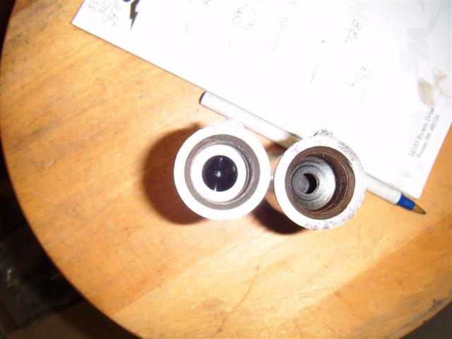

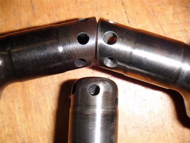

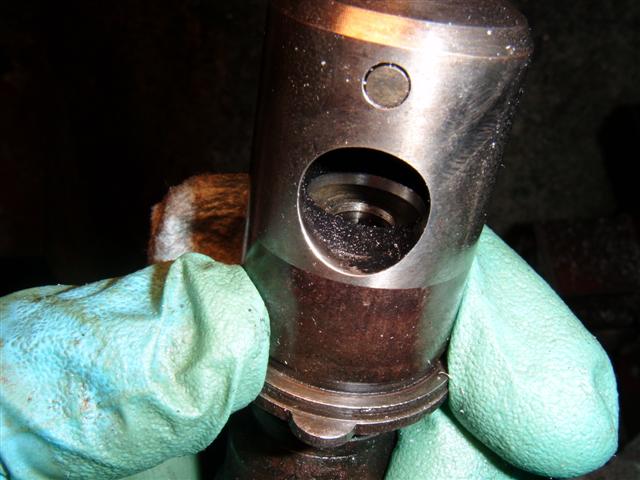

06-22-2012, 04:49 PM #209
Here are some pics of the most recent modded PCs for my 616 turbo.
One pic shows a stock up-rated PC, Ronnie's old PC he opened up to .125 and the same PC all 5 holes opened up to .136.
Another pic shows the injector seat has been modified per MB with a little more lowering than MB suggested, (1mm), I lowered it down 2.5mm.
One pic tries to show the injector in the PC after the modded seat.

06-24-2012, 12:47 AM #211
(06-22-2012, 04:49 PM)OM616 Here are some pics of the most recent modded PCs for my 616 turbo.
OM616,was there improvement with the .136 holes over the .125? Low,mid or top rpm"s ?
As much or more from the stock to the .125?
Did lowering the injector help? How? (less smoking etc...)
I only tapered (not enlarged),which worked well. Always looking for a little more GO POWER.
What is the difference between the round PC and the angled ones? The ones in my 123 are round tipped, I know they were changed later in life, are these an example of the change? MY on mine is '83 617.
Austincarnut
