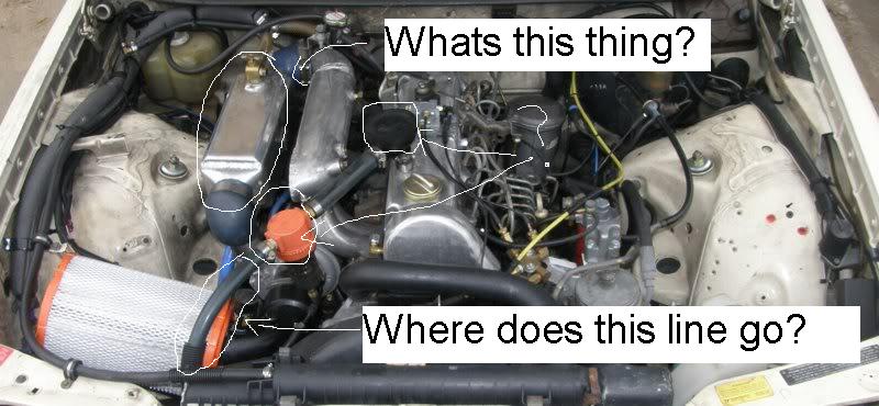

08-23-2012, 02:10 PM #210
this is what I want to do
http://i128.photobucket.com/albums/p169/...DP-top.jpg

08-24-2012, 10:00 AM #215
(08-23-2012, 02:10 PM)Purplecomputer this is what I want to do
what is going on here? Big air filter attached to some sort of cooler attached to some custom manifold?
what is the black thing coming off of the valve cover, that's the oil separator line, is it some sort of valve? then the orange thing is the drain back down to the oil pan?

08-24-2012, 10:22 AM #216
The thing on the valve cover and in the line are air oil separator's to separate oil vapor out before the turbo inlet
There is an air to water inter cooler above the turbo before the intake manifold.

08-24-2012, 10:46 AM #217
(08-24-2012, 10:22 AM)willbhere4u The thing on the valve cover and in the line are air oil separator's to separate oil vapor out before the turbo inlet
oh so not only does it go from the top of the valve cover to the oil pan, but into the turbo as well?
thanks for the heads up!
