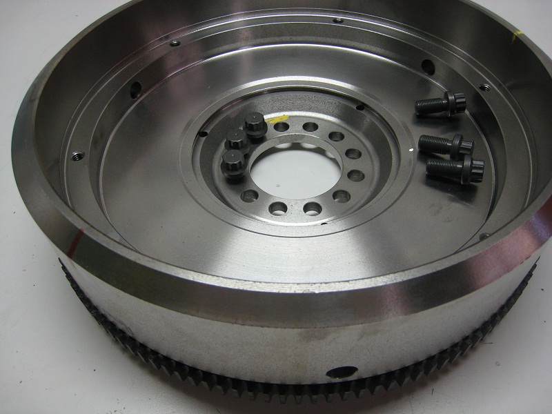

The transmission must come down again as I believe I have bolt to flywheel contact again, just like the first time. Its making that same horrendous noise it made in the very beginning, and ill be playing again with spacers. Oh well, at least I have this down to a science at this point.

going to go look at a POS rusted out 1996 1500 parts truck that has the NV3500 (hopefully, seller claims).
Ill never figure this depth issue out if I don't compare the transmission bell and input shaft depth differences with both transmissions side by side. The adapter is made for the NV3500, so I should be able to get some good measurements and either get the T5 to be exactly correct, or just use the NV3500 instead and put the T5 in something else.
Fortunately, there are no shortage of 500 dollar 5-speed rusty chevy trucks on craigslist at the moment in the correct year ranges.

01-28-2014, 04:45 PM #282
ok, im giving the T5 another try.
Reason being is ive been sitting here with the gearbox turning it in all gears, and nothing, feels great. No clicking, no play, no nothing that would cause worry.
After I pulled the flywheel, I had a good look at the groove cut in the back by my first problems. I finally pulled up a comparison pic of how it looked the first time-
[Image: 008_zps3743f7f3.jpg]
and now-
[Image: 0013_zpsb6a0ef02.jpg]
certainly looks like more, but weirdly, I can find no evidence on the bolts themselves showing they touched. It doesn't seem possible that they are making all that noise and vibration, BUT, its so close to my original issue, that there is definitely a likelyhood that this is the culprit. We will see
[Image: 003_zpsb5f07842.jpg]
so what ive decided to do is take that 3mm spacer that I had moved to the front of the flywheel, and move it to the back where I had placed it early on behind the 616.
I moved it around to the front because that was how the kit was designed, and I wanted to move the pilot bearing adapter back by that much, but the clearance is so close, that maybe its touching under load, maybe the flyhweel itself is actually flexing just a tiny bit under load?
anyway, its worth a test install to see what happens with that spacer behind the flywheel again.

01-29-2014, 10:30 AM #283
Ok, I have good news, a little more good news, and a serious blunder that will now be very difficult to resolve.
good news 1-
I have eliminated the metallic noise, there is no more clicking and destruction noises. It seems this was again, the flywheel contacting the adapter plate bolts.
good news 2-
the clutch is now working quite well, so finally have that worked out.
good news 3-
the big tires look good, and only barely touch on some corners. I still have to put the wheel stops in, but they should work well. Secondly moving the bumper up has totally improved the look of the van by a huge amount.
comparison of before and after-
[Image: 0012-4_zps57913167.jpg]
[Image: 0012_zps48f3a91f.jpg]
and now for the blunder. I make this admission because this is a crucial step I would never had made doing a 4-speed conversion on a benz, but rocketed right along on this van blowing right by it without thought, and have made some huge work for myself.
It suddenly occurs to me what the vibration is at low RPM (and its major). Its because I neglected to match balance the big aluminum flywheel with the existing benz flywheel from the 617 motor. Not only did I forget to do that, I also removed the benz flywheel from the donor motor WITHOUT marking it.
This means that I am pretty much screwed here on getting the balance right with no reference marks. I must have been on the 616 mindset thinking neutral balance, but ive blown it big time.
I can't think of any way to get the balance correct short of pulling the crank out and re-balancing with the flywheel. Unless someone has a labor saving scheme, this is what I think will have to happen now. whoops. heh, this thread is now dedicated to doing every bit of the conversion wrong 20 different times, and hopefully getting it to work. RolleyesBig Grin
On the plus side, the crank can probably come out in the van without too much issue. Ive done it to myself this time, thats for sure

01-29-2014, 10:48 AM #284
Find someone with a high speed camera, drop the tranny, and record the flywheel flopping around in there. The heavy point will be obvious. Grind as necessary, or re-clock.
Are you reusing the flywheel bolts?
01-29-2014, 01:01 PM #285
(01-29-2014, 10:48 AM)Simpler=Better Find someone with a high speed camera, drop the tranny, and record the flywheel flopping around in there. The heavy point will be obvious. Grind as necessary, or re-clock.
Rollguy over on PP and you have just about the same idea, and im going to steal it and try it.
im not even going to bother with the camera, im just going to pull everything apart, match balance the stock mercedes flywheel and the aluminum flywheel, then look at it in different positions on the engine.
Once I have the two flywheels matched, there are only 12 possible positions for it to be clocked, and one of them is correct. Even if I have to pull the gearbox and test each position individually for vibration with a driving test, it strikes me as less work than ripping the whole motor apart.
At least its a place to start. If I can't nail it down that way, I can always go further on the enigne later
I am reusing the flywheel bolts no more than twice, going through my large collection of them, none of them are loose or stretched out of spec yet.
However, Im thinking of just getting 12 grade 8 bolts that match the threads so I don't have to worry about it. the stock MB bolts are pricey

01-29-2014, 01:52 PM #286
Alternatively, hold a marker up to the flywheel as it's loping around. The outermost flung area will hit the marker.
EDIT: setup a camera when you're doing this just in case. That way your wife knows what happened when she finds your body.

01-29-2014, 02:07 PM #287
1st check the balance on the original 617 flywheel it may be neutral balance I have read that a 240d 616 flywheel Evan balanced and matched will vibrated on a 617 because it dose not have enough mass for the 617 engine. The 300d manual flywheels are massive and very heavy over 50# loaded I believe. On a diesel the heaver the flywheel the better for vibrations concerns!

01-29-2014, 10:46 PM #291
try and figure the heavy spot and counter with stick on lead wheel weights (if there is space) and then adjust by removing material
(01-29-2014, 10:30 AM)JB3 Ok, I have good news, a little more good news, and a serious blunder that will now be very difficult to resolve.

It will still vibrate Evan if you get the balanced perfect. If it dose not weigh enough that's the problem the 300d 4spd swap guy have running a 240d flywheels. Evan after matching balance on a 240d flywheel to the 300d's original flywheel. There is not enough mass to smooth out the natural engine vibrations on the 617. The 300d manual flywheel has a ring of weight on the out side of the flywheel to move the balance weight to the outside diameter of the flywheel
original om617 manual flywheel picture
This post was last modified: 01-31-2014, 10:47 AM by willbhere4u.
