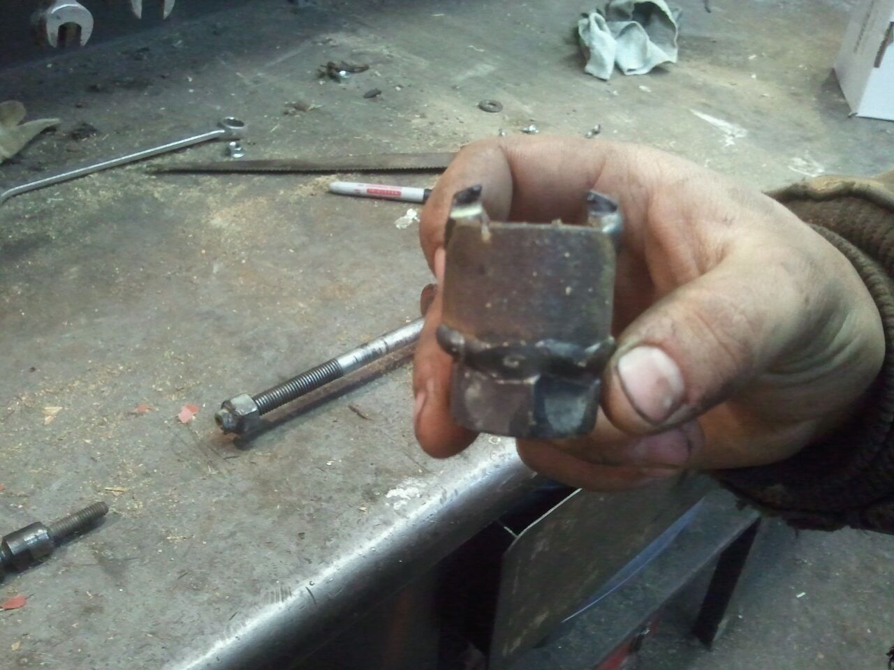

I got the crank puller today to make my own PC puller tool, Have to weld some stuff up then see if she works Big Grin

Well got the tool made, looks kinda jerry-rigged, but it works pretty good. Simpler=Better, I'll see what i can do.

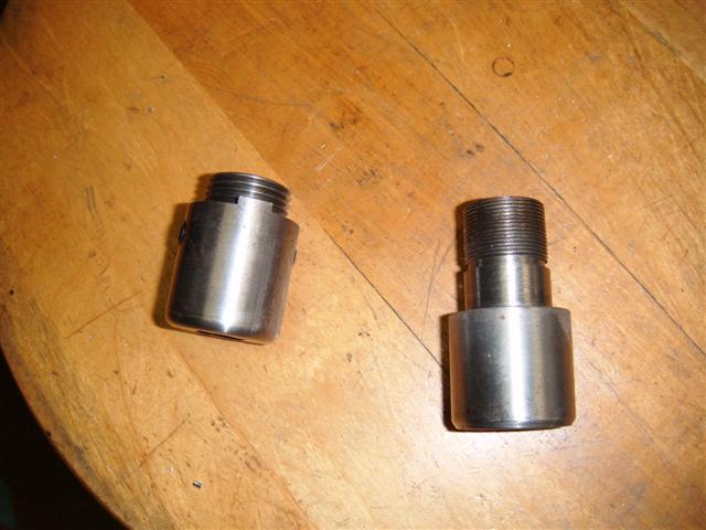

Pulled my PC's and the big middle hole measures .132, the smaller outside ones measure .120, and the small ones on the backside of the PC measure .092
I am going to have a local shop open up the seat ID to 14mm and drop the seat 1mm, then ream them out myself.
Any ideas on how much bigger I should go? Big Grin

I think that 0.136" was the biggest OM616 has gone so far. Can you try a homemade sandblast/extrude hone to radius the inner edge of the holes?

It should be noted that am currently running .136" dia holes on my 616 PCs which have a smaller burn tube ID than the 617a PC.
When I go to install the new injectors, I am going to increase the holes to probably .145"
My goal is to have more hole area than the burn tube has so the pressure head is at the base of the burn tube, which should increase the filling velocity and chamber swirl.
The 617 pc has a larger burn tube ID, so it would require larger holes to match the area % differential I am currently running in my 616.
It is possible to add a hole between the two on the back side, this would allow for overall smaller holes while increasing total area, tapering the inlets sounds like a nice thing too.
If you add an additional hole, do not use a regular drill bit, I would recommend using a M.A. FORD, Hi-Rock drill, it is made for hardened steel and is very rigid, makes a nice clean hole. Or any other straight flute drill for hardened steel for that matter would be better than a helical flute drill.

01-02-2013, 09:49 PM #268
(12-31-2012, 12:22 PM)MFSuper90 I got the crank puller today to make my own PC puller tool, Have to weld some stuff up then see if she works Big Grin
Got a picture of your tool?
2005 CDI heavily modified 1984 300TD - Myna pump/TMIC/enlarged PC's/HX30Super/W126 II front brakes/Vogtland springs/EGT +Boost gauges/H4 Hella's

MFSuper90
Budget Builder
1,533
01-03-2013, 07:45 AM #270
(01-02-2013, 10:18 PM)larsalan
(01-02-2013, 09:49 PM)MTUPower Got a picture of your tool?
where is this thread headed?
I little bit of everywhere Wink
I don't really have anyway to upload pics to my computer, or I don't know how Huh

01-25-2013, 05:03 PM #275
The tools I made are not as pretty as yours...Wink

01-25-2013, 07:08 PM #276
(01-25-2013, 05:03 PM)OM616 The tools I made are not as pretty as yours...Wink
Now your just showing off Wink

06-05-2013, 06:23 PM #297
(01-03-2013, 03:48 PM)Simpler=Better wutwut!?!?
i made something similar to this, 3 of the retaining rings came out, but two were already damaged and just got worse... so they arent coming out.. so i dont know what to do. get a huge easy out? can you buy replacement rings? i cant imagine it would be wise to go ahead and only do 3 of the 5 pre chambers..
poleshady
OM616
10mm MW
574
06-05-2013, 06:32 PM #298
(06-05-2013, 06:23 PM)poleshady i made something similar to this, 3 of the retaining rings came out, but two were already damaged and just got worse... so they arent coming out.. so i dont know what to do. get a huge easy out? can you buy replacement rings? i cant imagine it would be wise to go ahead and only do 3 of the 5 pre chambers..
Does your collar tool thread into the collar to secure it to the collar?
If you look at post 275, (I think), you will see a pic of the tools I made. The collar socket is held tight against the collar with a bolt that is inside the socket, this keeps the socket from popping off and rolling the edges of the collar.
OM616
poleshady
GTA2056V
78
06-05-2013, 06:34 PM #299
(06-05-2013, 06:32 PM)OM616
yeah it threads into the pre chamber not the collar itself. it cut into and took out chunks of the ring, didnt slip out
im on the phoe with the dealership now to see if they can find the part...doesnt sound promising.
luckily they can order them, 8 bucks each, now i need to find an easy out big enough.

poleshady
OM616
10mm MW
574
06-05-2013, 06:51 PM #300
(06-05-2013, 06:34 PM)poleshady yeah it threads into the pre chamber not the collar itself. it cut into and took out chunks of the ring, didnt slip out
If the socket is threaded into the PC it will not allow the ring to unscrew. The socket must use the threads in the ring that the injector uses, they are very coarse and the PC threads are very fine. The Fine PC threads are used to pull the PC once the ring is removed.
The Rings are available for not much money so don't worry about that. You need to make a better tool that threads into the collar, not the PC.
OM616
