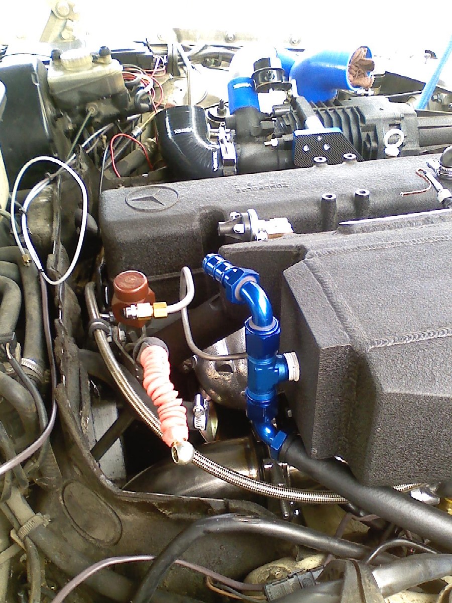

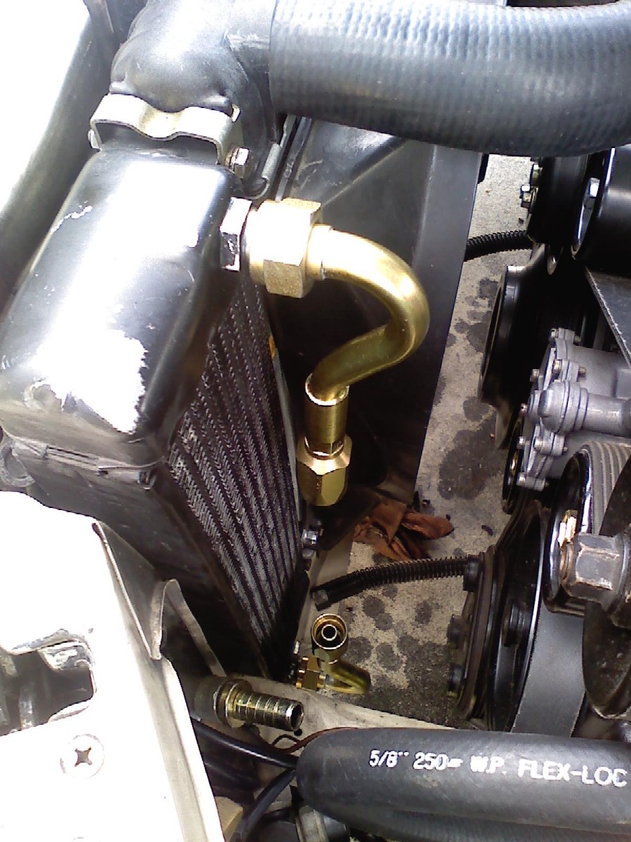

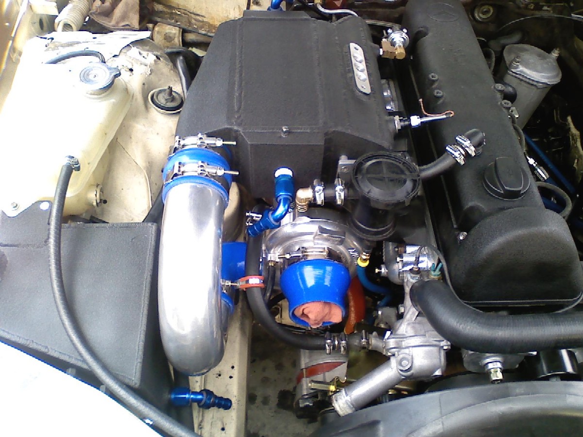

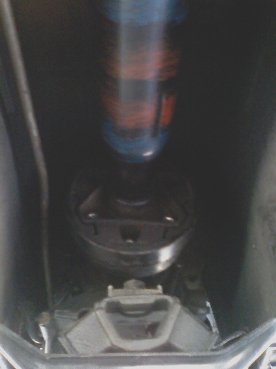

08-01-2010, 02:13 PM #259
Getting some things done today and it is coming together well. I have drive shaft on my list today, hopefully it will cool down and I will have it done by the end of the day.
A few pics of the progress:
Back side of I/C
New and improved oil line fittings
View of turbo side

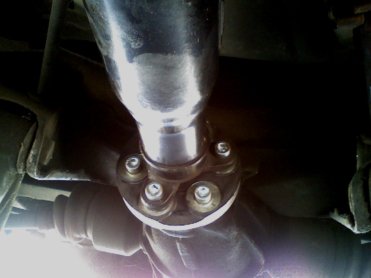

08-01-2010, 04:28 PM #260
Decided to say ef it and get it done - finished the drive shaft, flex discs, center bearing/ support and a nice and clean heat shield.

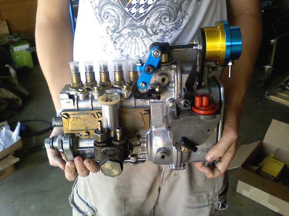

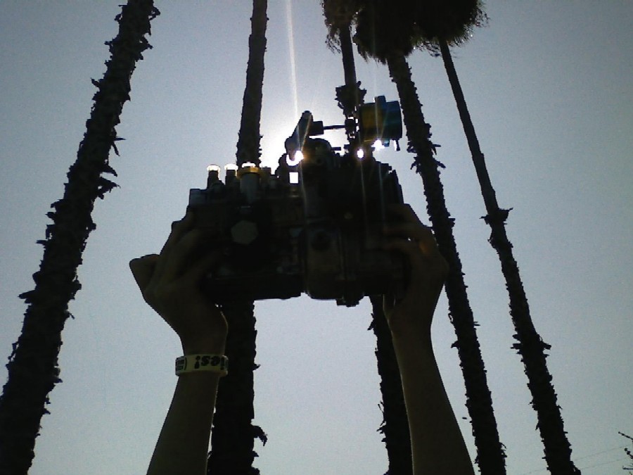

08-07-2010, 11:03 PM #272
It's HERE!!!
Pump arrived today and I have been busy all week as well getting it together. I am still dry fitting a few pieces to make sure it is all going to fit, so far so good. It is a tight fit, but it all seems to be going together well.
Here are a few pics of the progress.

08-08-2010, 12:27 AM #273
Please take lots of video's when its running!!!
08-08-2010, 01:06 AM #274
This is a pure porn )))))))
I can not wait to see it running )))
supercharged3.0

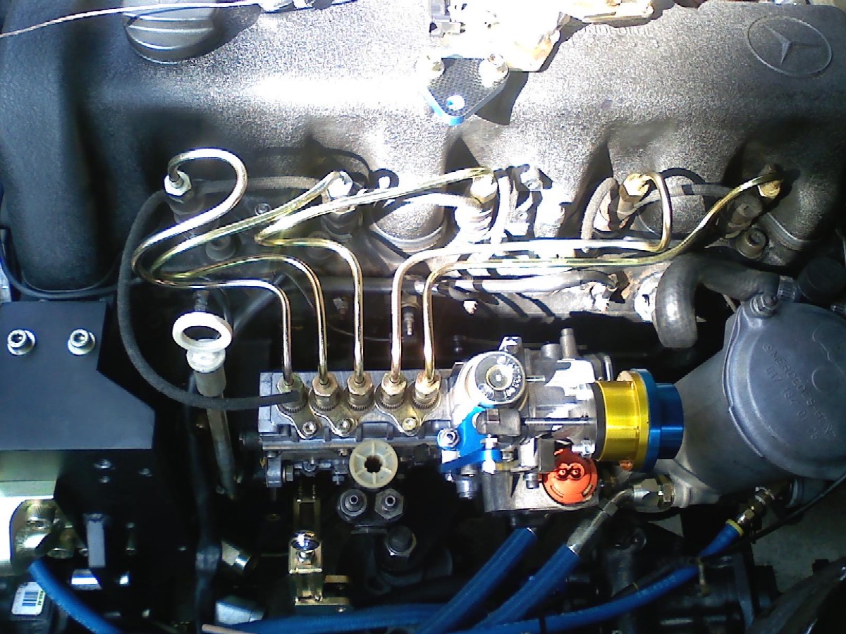

08-08-2010, 05:06 AM #276
That is absolutely beautiful work.....
But, do yourself a favour.....
Get some Clamps on those Injection-Hard-Lines!
[Image: 300TDnoplate.jpg]
Alastair E

08-08-2010, 07:59 AM #278
(08-08-2010, 05:06 AM)Alastair E That is absolutely beautiful work.....
I have the clamps, but I still have to remove the hard lines for 4 and 5 as I put the rest of it together. This thing is like a zipper, each piece has to fit perfectly and in the right spot and at the right time. Once it is complete then the clamps go on.
