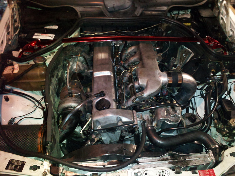

07-07-2013, 03:15 PM #307
Everything is mounted and the around the corner test drive is complete. Shit absolute shit. That is my traction in the wet. I can't get any traction till third gear. Smile
Smoke was gone when I came back from test drive. I will go out later tonight and get some fuel and see what the smoke is like.
[Image: engine.bay.intercooler.jpg]
Yes my work space is in bad need of a serious cleaning.....
This post was last modified: 07-07-2013, 03:36 PM by winmutt.

07-07-2013, 04:11 PM #308
I'm loving this project! More vids please!!!
W124 om606 HX40 finished and it's a beauty 450bhp/456ft-lbs
maxypriest
07-07-2013, 08:18 PM #309
(07-07-2013, 04:11 PM)maxypriest I'm loving this project! More vids please!!!
Thanks. I am but a peon compared to some of the others here but this is a long dream realized.
I went for a test run and its peppier. Not as balls to the walls as with my last engine but things are turned down considerably for some break in. This is by far one of the best test runs I've ever had, usually there is *something* that needs immediate remediation. No rattles! with all that piping. I know it might not look pretty but NO RATTLES! I hate rattles and squeeks.
Honestly, whatever I turn the ALDA up to it wont be much more, for a daily driver it's got quite a nice pickup. I am clearly leaking in the intercooler piping but with no boost gauge hooked up I can't tell how much. Still need to get a bango bolt for the 91 style boost sensor which is sitting on my desk ready to get to work. In third at 85mph I got over 1275 F. With the Alda turned down/turbo leak I am not getting that much more power in 4th and 5th, honestly this is not a bad thing it will keep the hoon in me calm.
The idle smoke is gone once the engine is warm. We will see in the morning if it comes back.
Thanks to dieselmeken for the pump and most of all thanks to everyone for their help over the years.
[Image: fmic.lights.jpg]

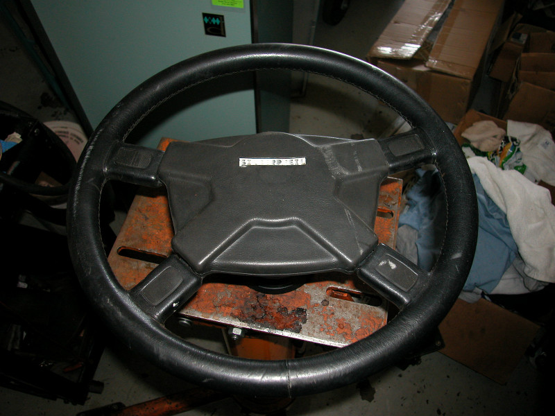

Not an exact fit. Had to remove the contact plate on the steering wheel and still managed to blow a fuse. However a quick pic from the drive in to work.... :
[Image: silberpfeil.jpg]
Totally surprised at how it "feels". I had a C class on before which was a little smaller similar to this one :
[Image: images?q=tbn:ANd9GcRZx8UtrJ-13NMu56dPQFc...Ci2G5vK-7A]
This silberpfeil has deeper contours for the fingers from 2-4 and 8-10. I found the silberpfeil insert when I got home today (not sure why it was removed). Scratched it a bit getting it back in Sad
