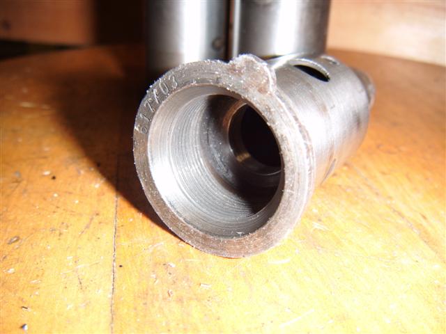

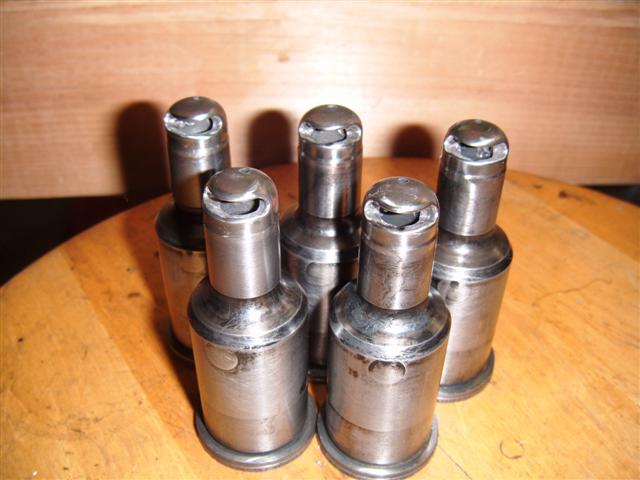

03-06-2017, 06:16 PM #367
(11-25-2015, 12:43 PM)Captain America
(11-25-2015, 11:42 AM)MTUPower How big did you enlarge the holes to?  How temps have you seen on your EGT?  For how long?  How much fuel are you putting in?  Which all leads to - why do you think your head has cracks?  ...and lastly- if the engine is running fine are you going to reinstall the head or a buy a new one?
3 Front holes are at .203
2 Rear holes are at .157
Bottom Hole at .126
[Image: IMG_20140111_101408.jpg]
Highest temp Ive seen is right at 1250f for a few seconds, and that is right before the turbo is spooled (running 16 psi with pump turned up by me)
Making a looooooooong pull temps sit at just over 1200f
the engine got hot a few times enough to boil water out of the reservoir tank that may have done it. that's the only thing I can think. I will acquire a new head and port it
Not to be out done my Captain America, I have finally gotten around to the next phase in the evolution...
I am considering tapering the inside of the burn tube and back cutting under the injector heat shield seat in order to help keep the injector area cleared out. MB says to increase the seat hole to 14mm and to lower the seat 1mm to reduce smoke, but I got a little over zealous when I did the first set of turbo 616 PCs and lowered the seat to the point where the PC broke when I torqued down the injector. After that I would feel much better about angling the back side of the seat instead of lowering the seat surface.

02-03-2018, 07:00 PM #370
(02-01-2018, 11:27 PM)NZScott ....so
How have they gone?
I got a random thought about trying something like this, if only I could find some cheap as NA (post about 1979) prechambers
I really really like them... One of those things where I wished I had just made the time and put them in earlier lol..
I should note that I have the camshaft advanced 10* and currently have the static timing (start of injection) at 28* BTDC. As soon as it gets warmer here I am going to bump it up to 30* and see how it takes it.
Also, for some reason, these PCs wanted a min of 26* or it would miss at idle, I am at a loss as to why, but when I put them in the timing was stock at 24* and it missed and the cold idle was ruff & smokey. I had a little adjustment left in the slots, so I advanced the pump as much as I could (got me to 26*) and it eliminated the miss and smoke. It does sound different though, more like a real diesel, but softer if that makes any sense..
I have had them in for about 6,000 miles so far. The funny part is it idles quieter at 28* than it did with the stock PCs at 24* lol..  Based on that I want to give it more and see how it does.

02-08-2018, 12:04 PM #373
(02-06-2018, 05:58 PM)R-3350 i would be interested in the effects with much more fueling. also would be interested in the BSFC with the new chambers.
Adding more fuel is just one way to make more power. The more timing you can run the better, but the stock PCs only fill so fast so they are limited to about 26* of lead time..  Increasing the diameter of the burn holes allows the PC to fill faster, thus reaching ignition temp sooner, allowing injection to happen sooner.
I went a step further and advanced my cam 10* so I am building pressure even sooner. I am currently at 28* and will go to 30* as soon is it gets warm out.. (too cold to work one the car lol). There is a considerable amount of power that can be had by tuning.
Once I find the limit timing wise and settle on a number, I am really tempted to dyno it. I would be really happy if I could see 160 ish at the wheels with stock elements. I have heavily modded the governor (eliminated the high speed governor spring and torque control function) so it does not back off fuel as it revs up.
Larger elements deliver fuel faster, so I will be interested to see what kind of timing I can run when I switch to 10mm elements.

02-09-2018, 12:18 PM #375
(02-09-2018, 10:47 AM)R-3350 i just wonder how they would handle a 2-3X increase in fueling. they may behave in a non linear way much past stock fueling. still its quite nice to see its working as intended i may be tempted to try these at some point.
The ones I am running (and posted pictures of) have more done to them than just cutting a slot across the burn holes. I did a lot of internal work too. I am pretty sure I described what all I did though.
I think this is more of a hybred between DI and IDI.

02-12-2018, 11:40 AM #379
(02-11-2018, 01:00 PM)whipplem104 So let me get this straight. You had to add timing with this mod? If so then you are slowing down the flame front. Or effecting quench.
I do not see how this is a good thing..
That's funny..... All the carving and reaming I did totally changed everything..
The stock PC is designed to try to maintain pressure after ignition for as long as possible by restricting the exiting gas flow. What I have now is more like a large port swirl chamber where the primary combustion chamber volume stays the same, but the pressure rise and fall are not restricted very much.
My goal is to run as much timing as possible. This mod allows me to do that. It is not something for the meek to try  Tongue
